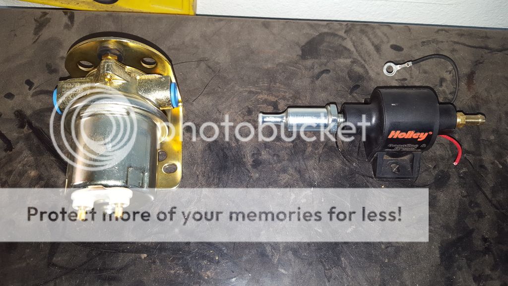

Figured out my cutting out issues. Fuel pump wasn't strong enough and couldn't flow enough fuel. I upgraded to a vane style fuel pump frim Airtex.
New vs old

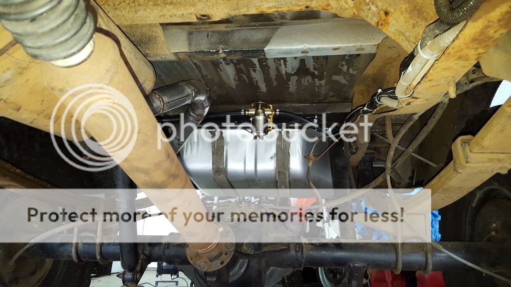

Mounted basically on the tank

Your Holly pump looks like a twin to my Mr Gasket. Wonder if one is a restickered version of the other.
http://www.summitracing.com/parts/mrg-12s
LOL mechanical is the only way to go!:icon_rofl:
The pumps do look identical. I bet they are the same manufacturer.

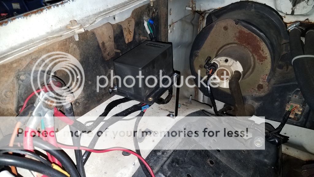

Got a little bit of work done on the Ranger. Changed the oil and made a mount for my Bussman fuse box. Got tired of seeing it flopping around under my hood. Took my Ranger out in the snow a couple times but didn't take many pics.

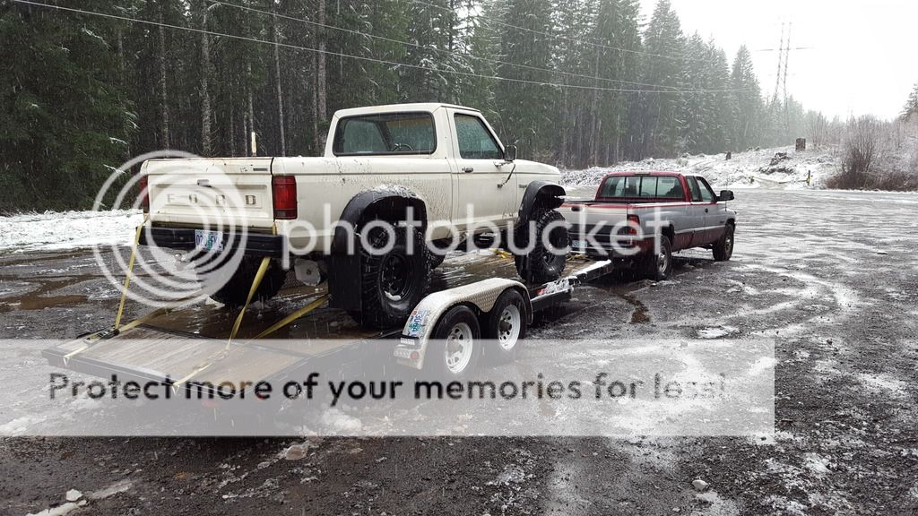

Towing it with my beater. Didn't have a front driveshaft on my F350 yet.

Here is my fuse box I made.
