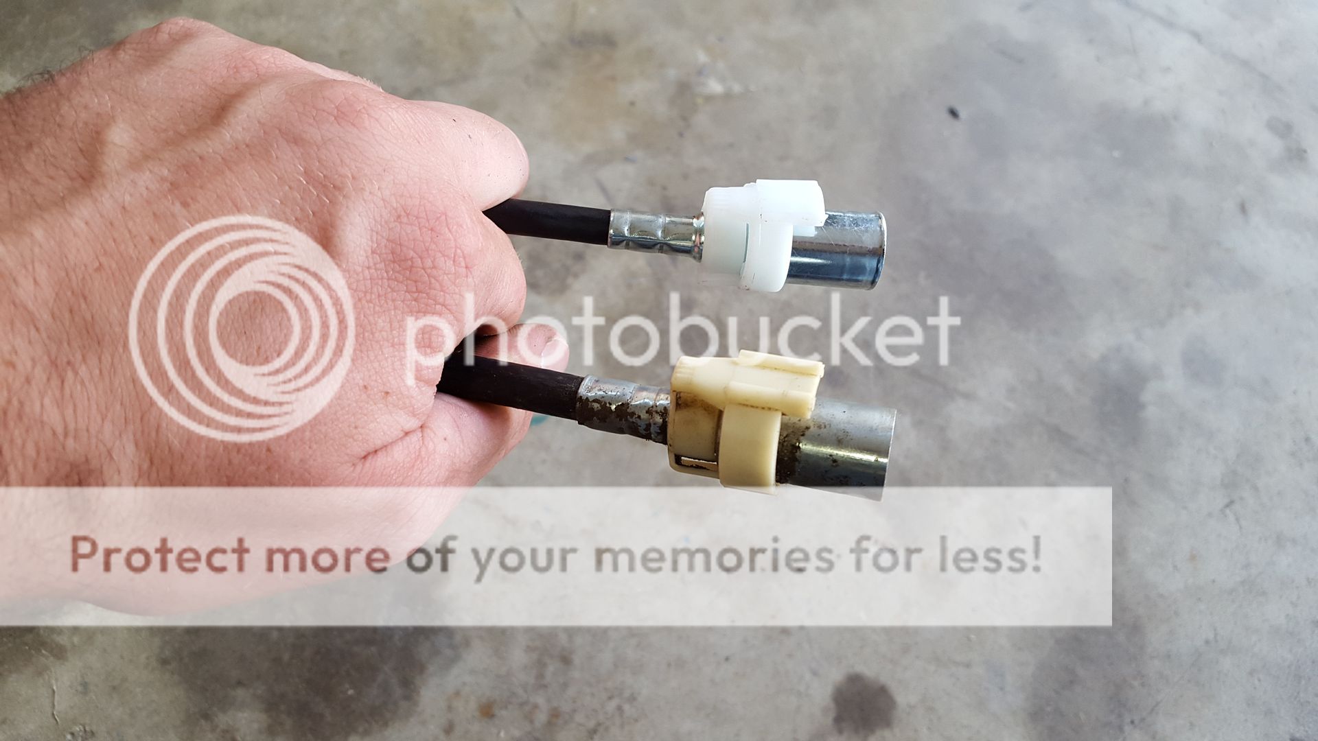

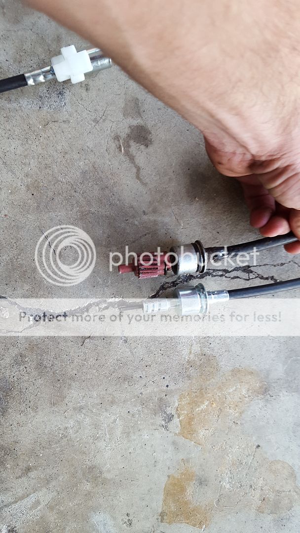

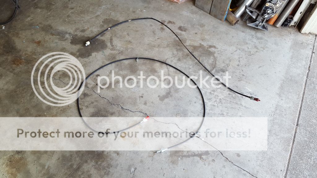

I figured out my speedo thanks to Rowdy. I'm using a 78 Bronco speedo cable. It's I believe 95" long. Its about 6" too long but it will work fine.
Cables at cluster
Speedo cables side to side
Cable at tcase.

i usually use the speedo cables from full size vans. i am liking the t case shifters:icon_thumby:
