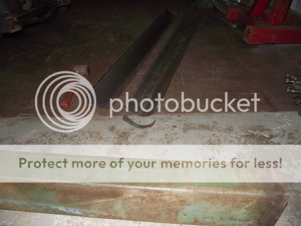

i got to the task of turning the exhaust pipe halves into rocker panels.i cut a small slice off the end and used it to determine the profile i would need.
after about half an hour of beating the pipe half over the section of box tubing in the foreground i've got one roughed in.i'm using parts of 5'' elbows to form the ends of these rockers,but am still waiting for them to show up,so i cant do much with them until then.

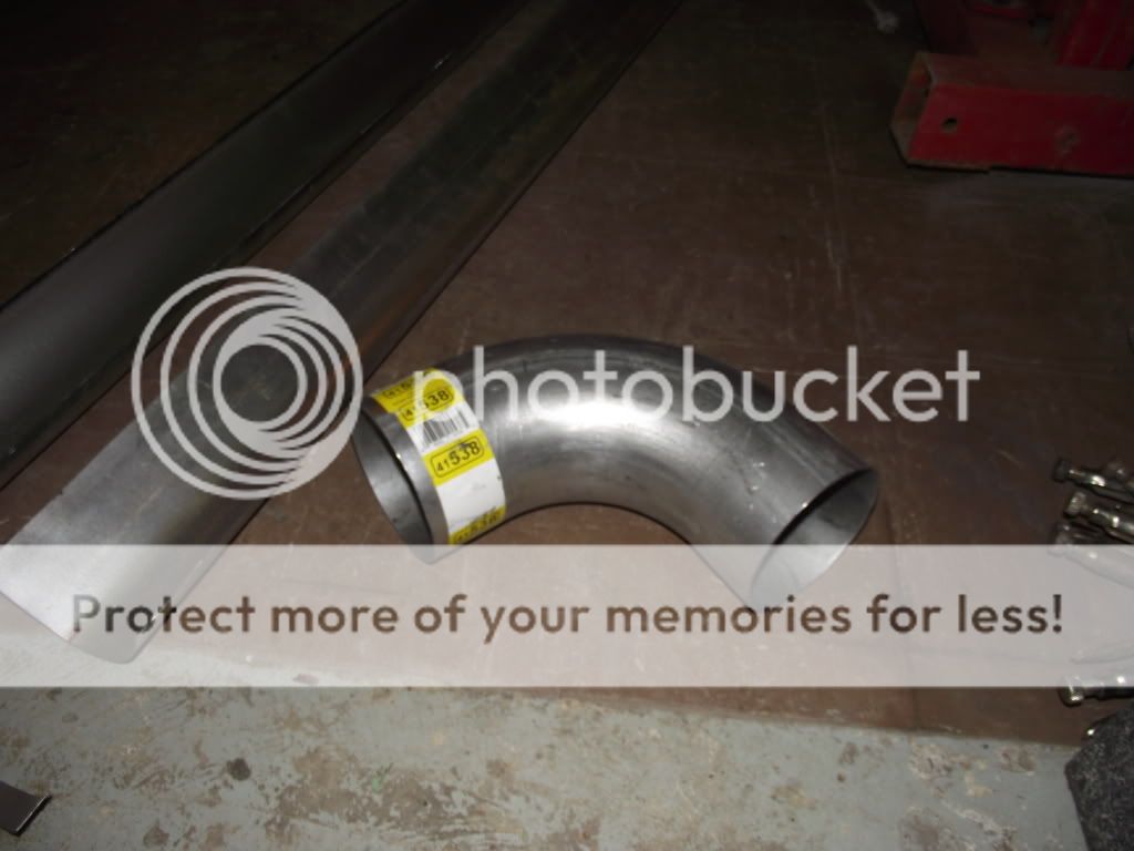

so my elbow came in today for the rockers....it was only *gasp* $103.
this better work good.
You paid $103 for THAT?? :icon_surprised::shok:
But Gwaii, thats only 1, don't you need another:icon_confused:
nope...it'll get cut into four pieces to make the front and rear ends of the rockers.i'll be doing that tonight so you'll see what i'm doing with it.
why the hell was it so expensive!?!
I think I know where you're going with this, could you have not used a cheap steel wok?.
i guess they're a few bucks in th real world,once you get the shipping and all to get it here,it adds up to even more.
just the cost of living in a remote northern community-and on a island.
no,this combines positive and negative turns in a part that has the same material and finish as the pipe being used for the rest of the rocker.
so on the four corners i'll use it on that works out to $26 a corner....that's not so bad to get a professional looking finish.
