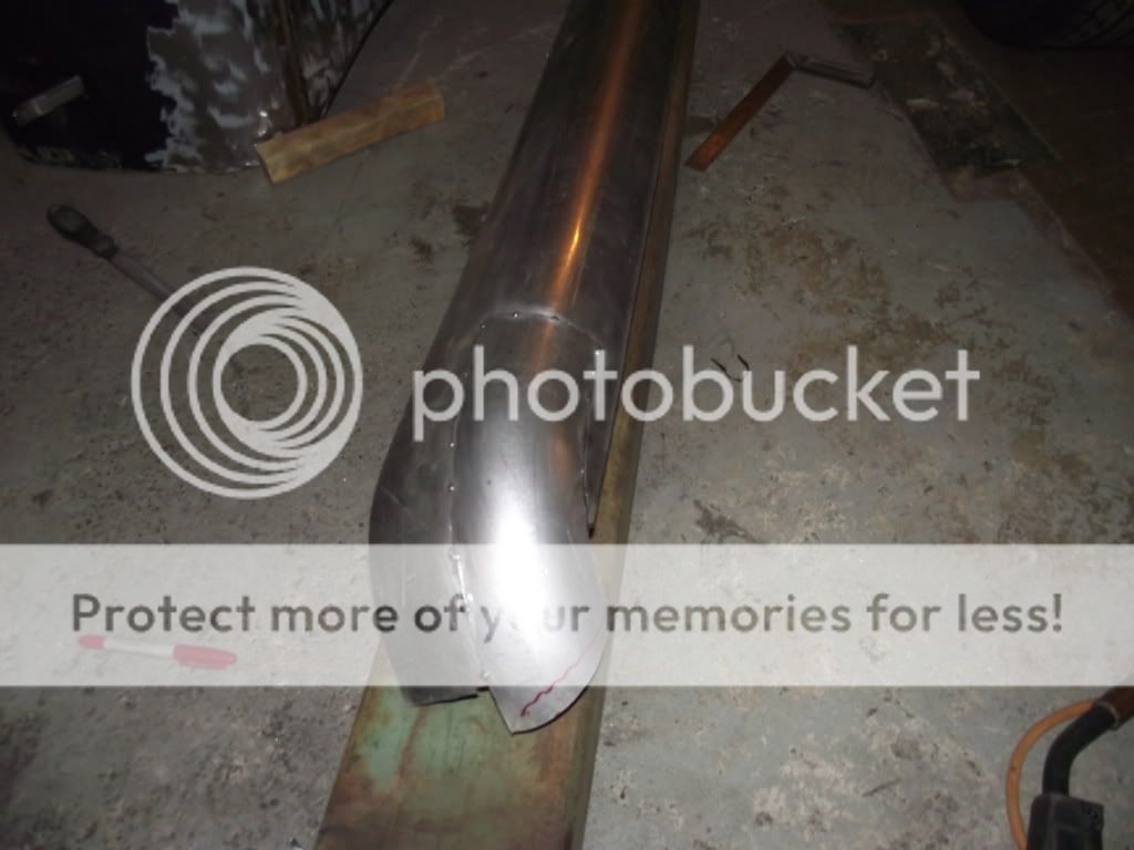

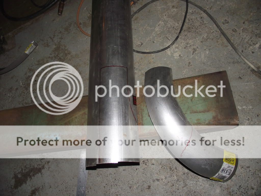

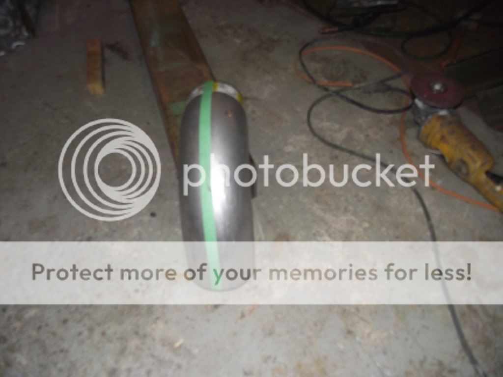

marked for the first cut.....i like to use masking tape to mark some awkwardly shaped things as it can be repositioned easilly if needed.
and split one way...
then the other.

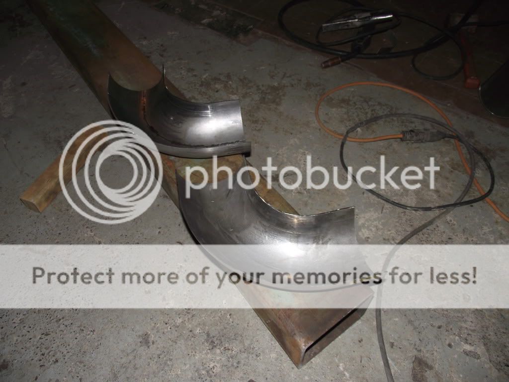

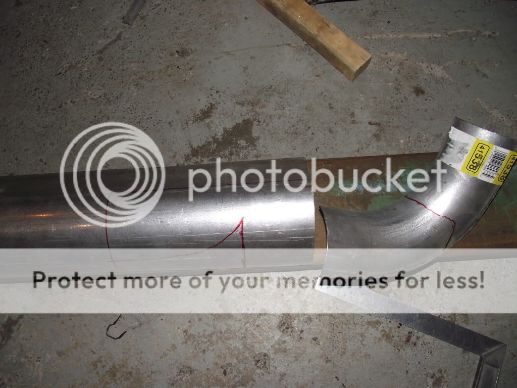

marked for cutting....
and tacked in place.
of course,this is the side you'll see.that gets the back end roughed in,now for the front.

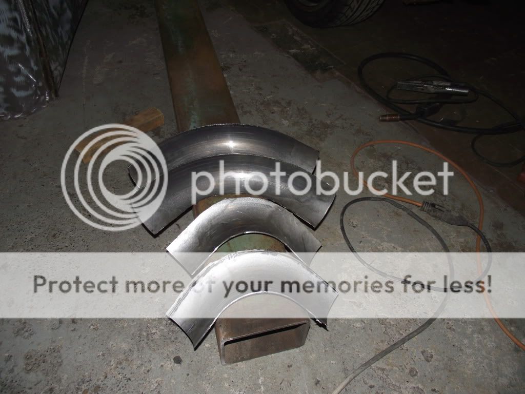

now you need to take a 90,divide it by 4 and add two quarters to a 5'' pipe divided by two
=1 rocker.
the other end.....that's as far as i got before stopping for dinner.

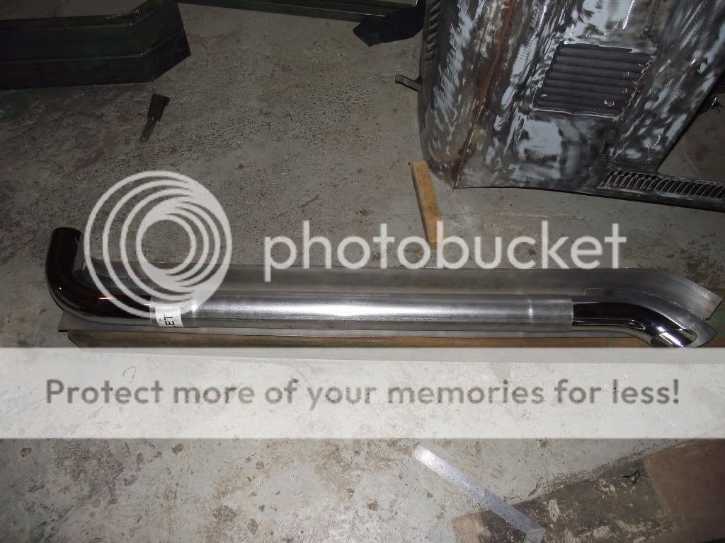

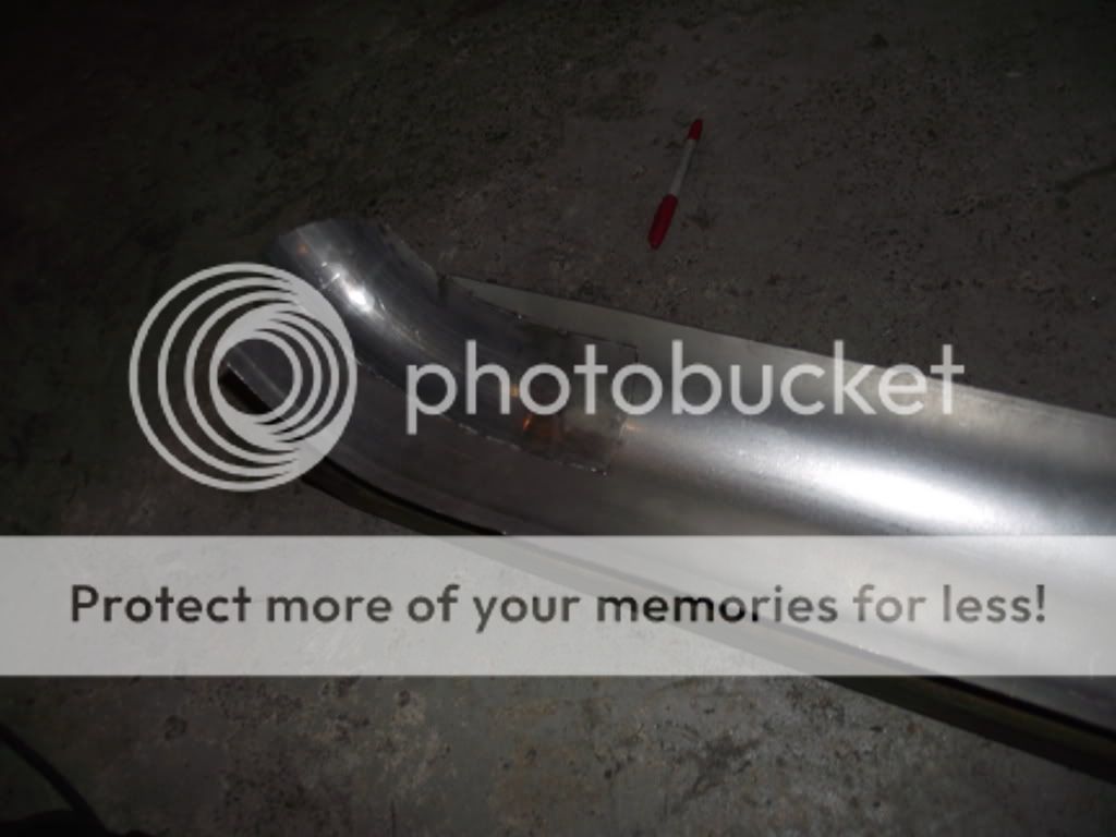

with both ends in,you can see how the sidepipe sits in it.
of course it's upside down and off the car here,but you can see what the elbow sections are for.i could have hammered this out,but it's so quick and clean this way it's worth the 100 beans.
:shok:
hope the ice cubes didn't water it down too much.
