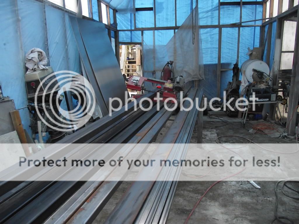

here's another reason i love my little cutoff bandsaw.when dealing with awkward 24' lengths of metal,i can take it off it's stand and set it right where i need to do the cut.it gives a clean,accurate cut that i don't need to do any more prep on,and while it's cutting i can be doing something else.today,that something else was weleing up a custom driveshaft for another person's custom truck.

Is that 2x4 tubing?? Looks like it's only 1/8 thick....How thick is it and what size are you building the trailer??

yup....2x4x.120 hss.that's plenty for the frame of the trailer i'm building.
it's actually the same stuff that the frame of my car trailer is made from,and that's bigger and has taken a beating over the last 20 years or so.
this trailer's deck will be 15'x6',single axle-enclosed,insulated,and heated.
