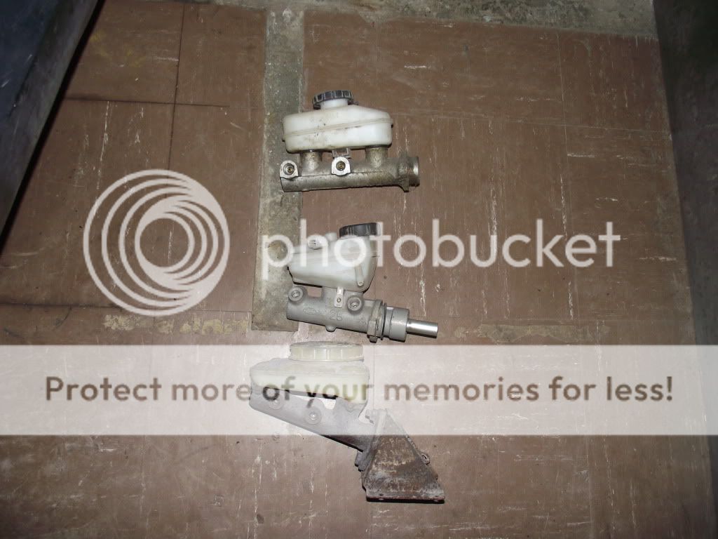

working on getting the brakes operating now,the stock pedal is being used.
the stock master,while what i wanted to use is just too hard to find parts for,so i had to look at other choices.
the top one is a ranger/explorer unit,but has two problems.it's too long,and it mounts level.the gt master mounts at an upward angle.
the middle unit is from a 2000 cougar,and is short enough and mounts on the same angle as the gt unit(bottom)so it looks like this is what i'll use.

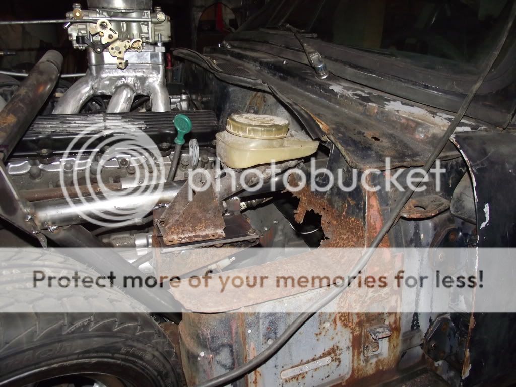

this pic illustrates why length is an issue with mounting the master.the ranger one just won't fit between the bracket and the firewall.
