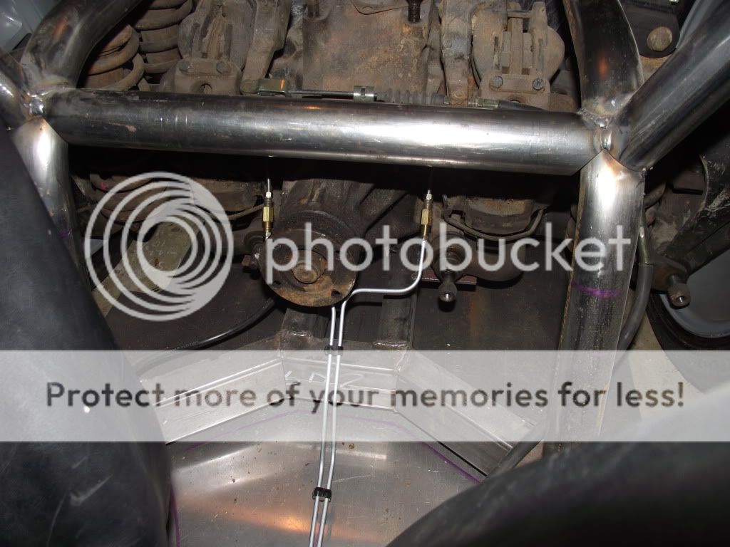

the last few days i've been doing little stuff...
like running brake lines,and other detail stuff.

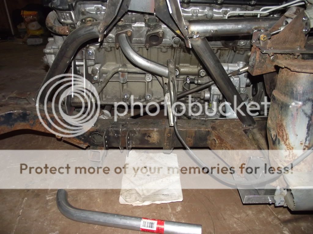

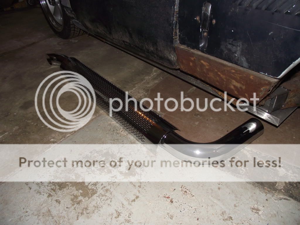

the sidepipes finally came in today.they are a little cheesy,but i can work with them.
the left header also came in...some assembly required.
so that was another g-note gone.

Those side pipes kinda remind me of "little red express" stacks. So are they going to hang out the side of the body completely, or frenched in a bit or what? What's your plans, I know you have it all pictured in your head already. :D Frenched in under the doors but have em hang out a bit would look sweet!.

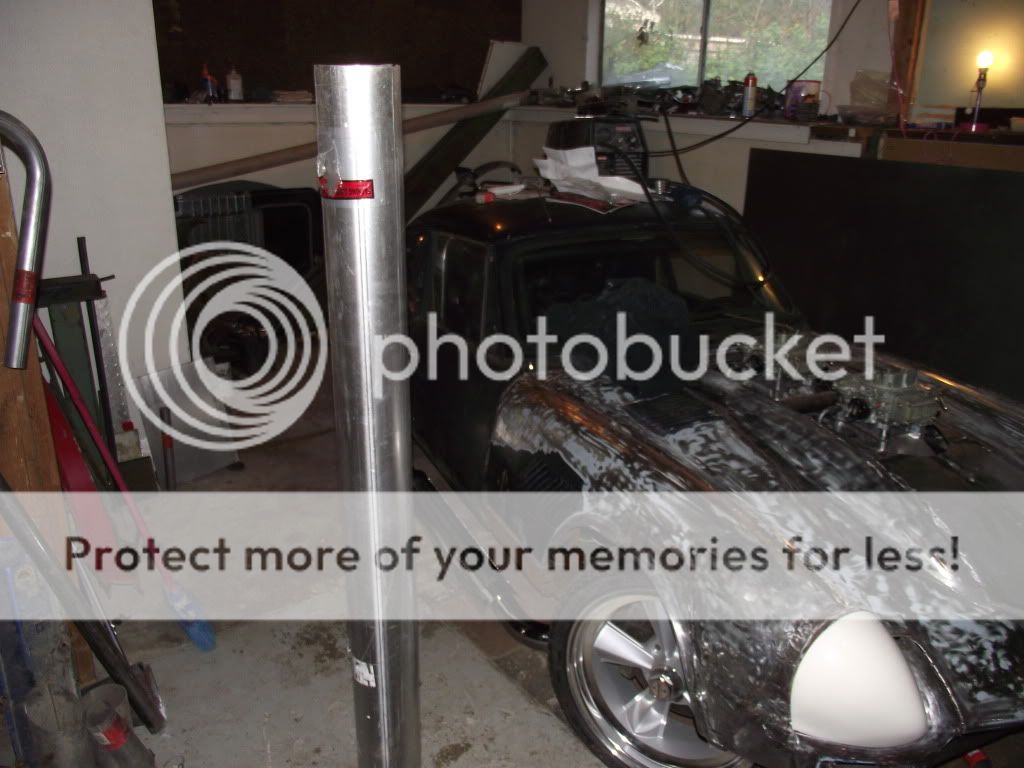

this is a 5' hunk of 5'' exhaust pipe i bought.i'll split it lengthwise and use it for the rockers,turned concave.so the pipes will,as you said be partly sunk in,but still hanging out a bit.
that pipe was another $70.

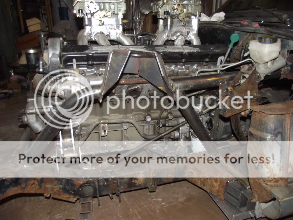

Love seeing those 2 carbs sticking through the hood!
This this is gonna rape & pillage those back tires.....AND I CANT WAIT TO SEE IT!
they are kinda pretty,aren't they.
i always had a soft spot for the dual holleys.

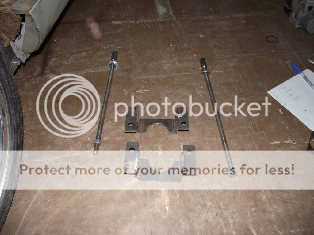

figured this was a good opportunity to show off another homemade tool.
i needed a spring compressor that would fit in the confined spaces i'm dealing with,so i had to make my own.the two halves of this one go around the strut,and the top strut mount is the top plate for this thing.the rods go through the small holes to tie the two halves together.

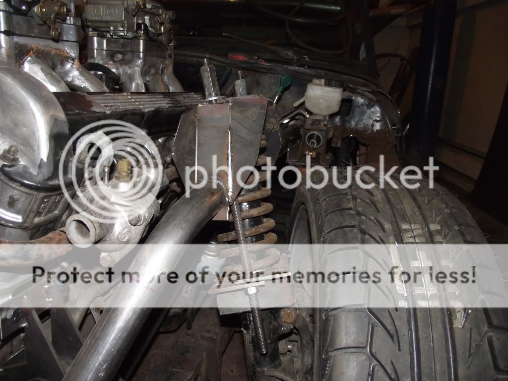

here it is in place.
why am i showing this?because to build the header i want to get the front suspension out of the way,and i need to compress the spring to do it.
much better.it's still kinda crowded,but i can work with this.

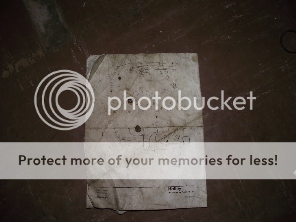

i drew out this schematic for the headers about 4 1/2 years ago.it's been through hell since,but i can still read it...so all's good.
and the first tube gets placed.note that the ground clamp is on the header tube,not the engine block.improper grounding can do serious damage to an engine when doing this sort of welding,so always consider the path the electricity will take,and avoid having it go anywhere it can do damage.
:icon_confused:You can read THAT... You my friend are more talented than I originally thought :thefinger:
Haha all jokes aside, the build is coming along great!
it helps that i drew it in the first place,even if it was in ancient history:D

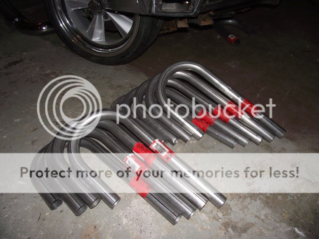

i'm just glad to have some material to work with again....this stuff should have been here two weeks ago.
once i get my metal order in from terrace(western pacific metals,good guys:icon_thumby:)i'll have lots to do.too bad it's going to take up the better part of four days to go pick it up.
