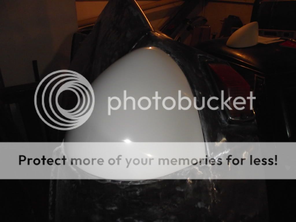

The headlight covers look good, man. It turned out smoother than what I was crudely expecting. Can't wait to see it in clear form, after the mold.
that shot is just after spraying the gelcoat.i'm sanding them smooth now,then they need to be polished to a full gloss.any imperfection on the surface will be transfered to the inside of the covers.can't have that.

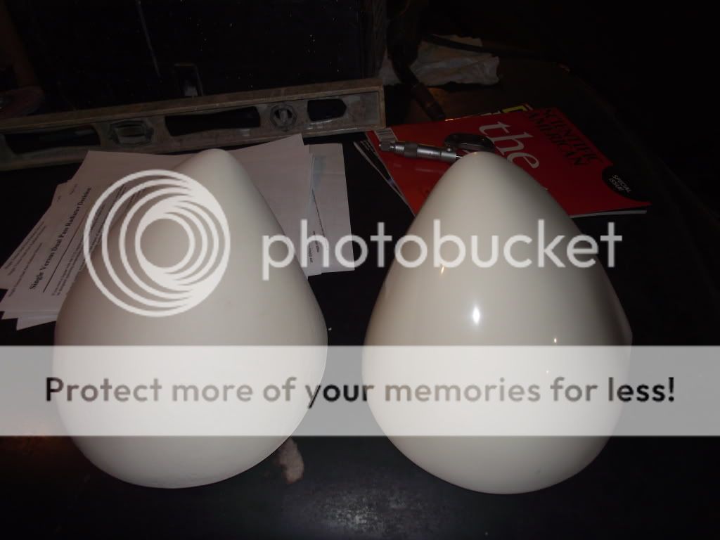

this is an illustration of the difference between 'just sprayed' and 'ready for use' on the forms.it takes a bit of time to sand the surface to get the form right and no pits or bumps left,then polish it to a decent gloss,but this will be reflected in the finished product.

My less mechanically inclined buddy is hanging out and asked "Are those home-made boobs or something? If they are, he forgot the nipples."
I replied "They were there, but Chuck Norris stole them"

well,i guess they are pretty good looking boobs.
