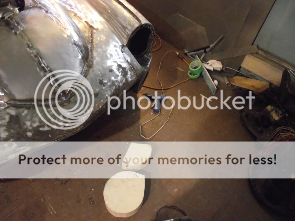

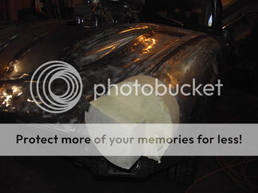

as for the project,
i just put the first layer of fiberglass on.this needs to set up so the second can go on,then gelcoat to make a smooth surface.
one thing to keep in mind here is that this will be the inside surface of the finished part,so it has to be made smaller by the thickness of the plastic being used to make the part itself.
the foam had to be carved smaller yet,because i had to consider the thickness of the fiberglass as well.the plastic is 1/8'',and i gave another 1/8'' for fiberglass,so the plug was carved 1/4'' smaller than the outside surface of the cover.
another point,i found for working the foam,a hacksaw blade works good for roughing it out,then all shaping after that is done with 80 grit sandpaper.it's actually quite quick.

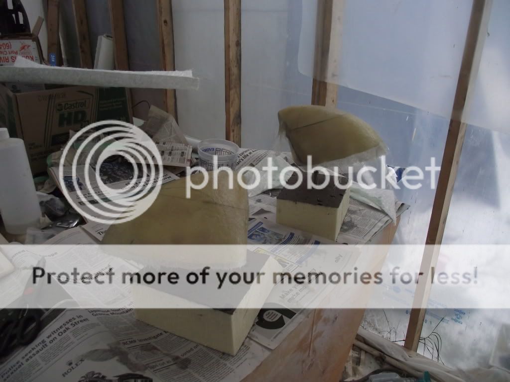

So you filled the headlight cavity with foam? what kind of foam? Like expanding mono type foam or just like packing foam?

the foam i use is actually a commercial roofing insulation,it comes in 4x8' sheets in a variety of thicknesses.i use 3'' mostly.the downside of it is that it has a paper coating on each side that needs to be peeled off,which is a pain.
urethane foam is also available from plastics shops for this very purpose,but they want a fortune for it-the insulation is about 1/5 the price.
do NOT use styrofoam,unless you are using epoxy resin($) as polyester resin will dissolve it.

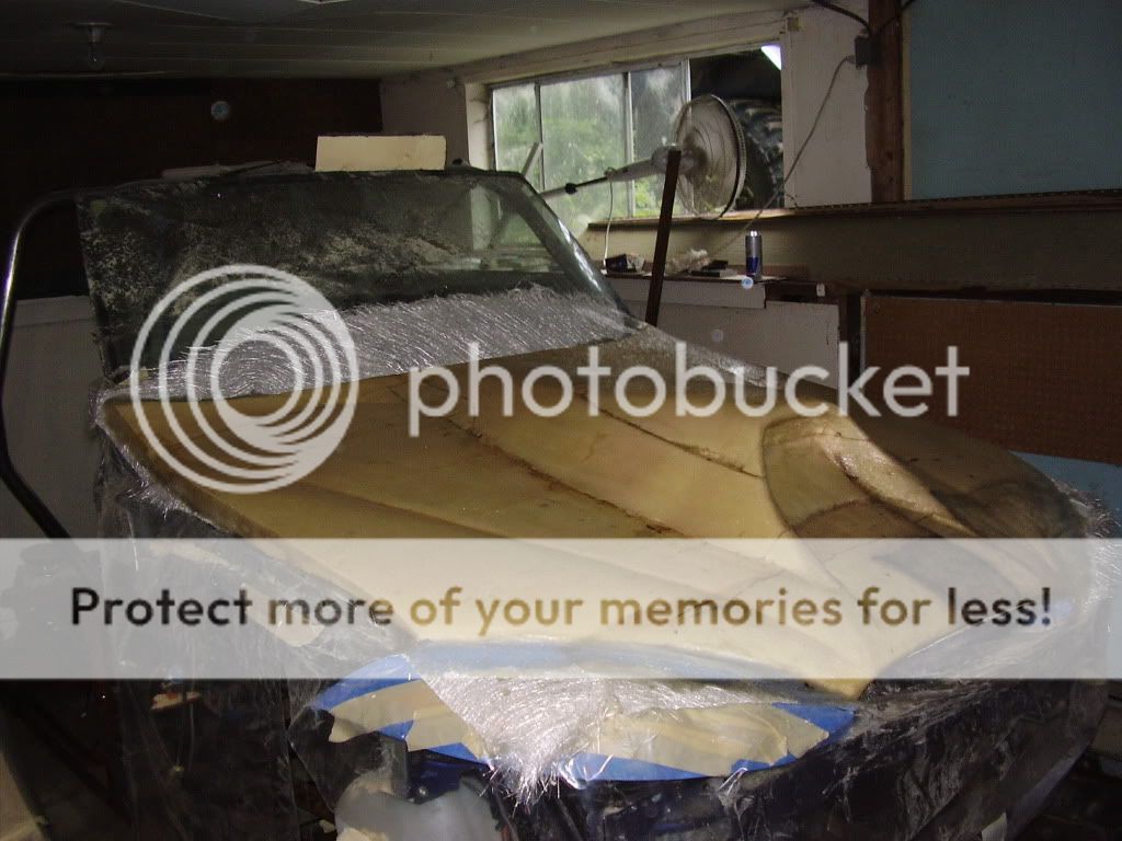

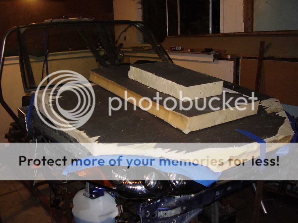

i've also used this material to make much larger items.
as you can see,if you can imagine it,you can make it.
