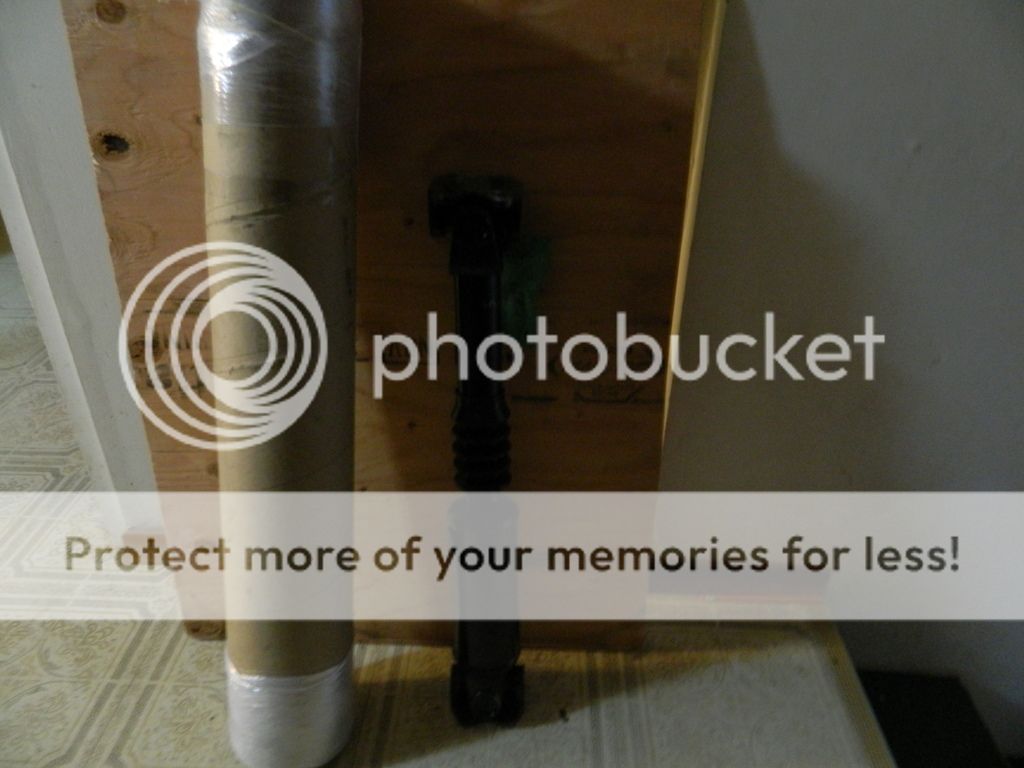

driveshaft just arrived.
let's hope it fits.
thats a frightening sight for those poor tires:icon_rofl:

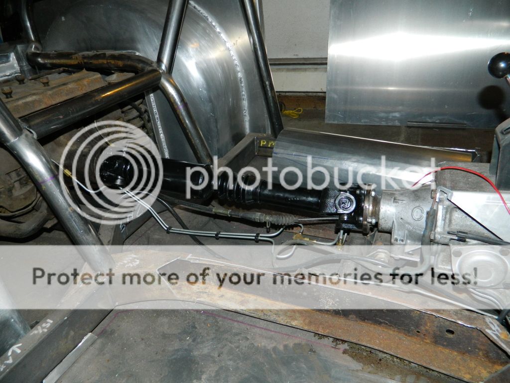

not too shabby:icon_thumby:
driveshaft fits like a dream.i'm only a couple of bolts shy of having the motor hooked to the wheels.
Man this picture reminds me of how much detail work has gone into this car - almost forgot about the equal length brake lines.
