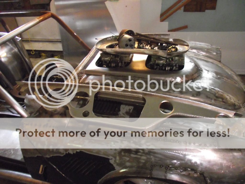

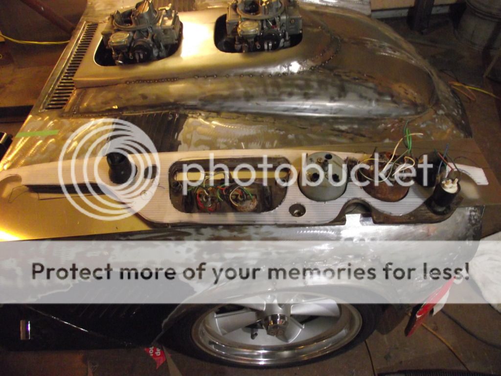

on that note,how about some dash fab.

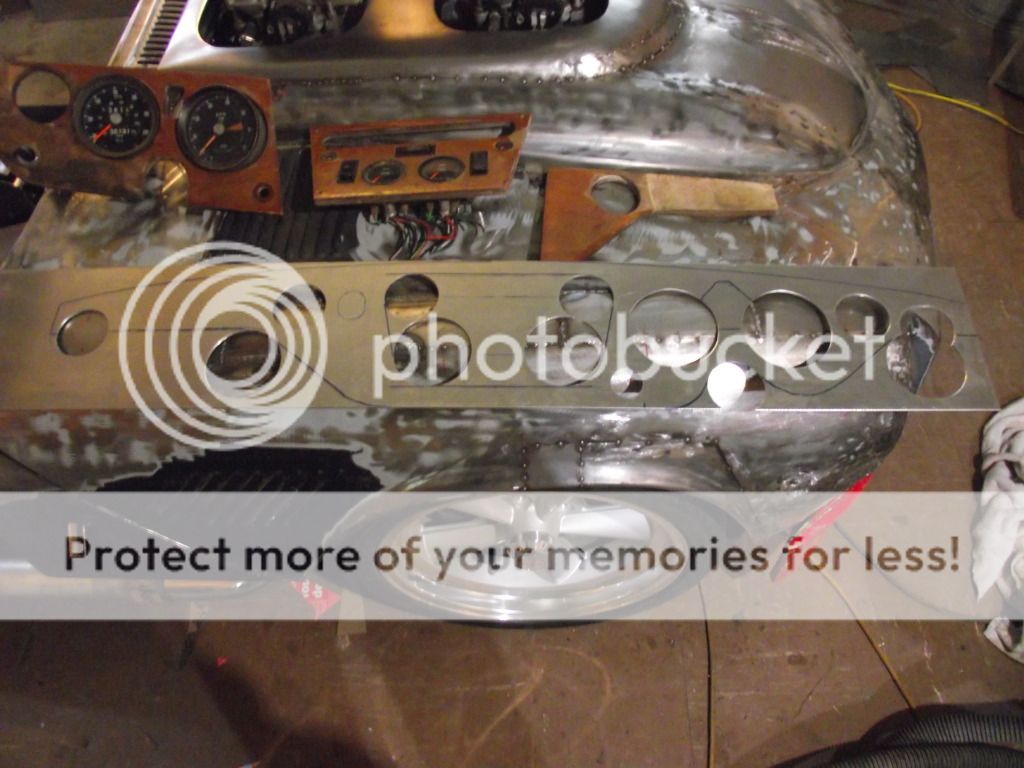

i made a template,and test fitted all the goodies to it before cutting into metal

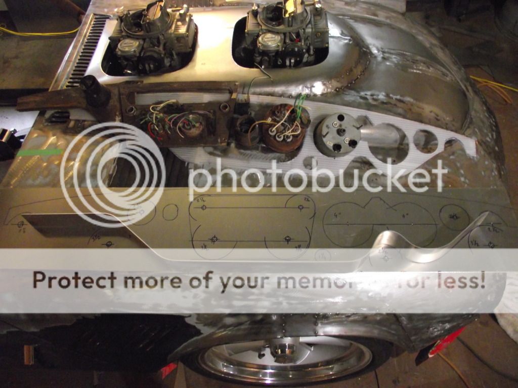

marked out,you can see i've rendered all the inside curves to circular tangents.outside curves are easy to cut out and dress,inside curves are hard to get looking good,so i use a different trick.not here the bottom plate for the dash is already formed.
i cut them all out with holesaws,then i just have straight lines and some outside curves to cut out.

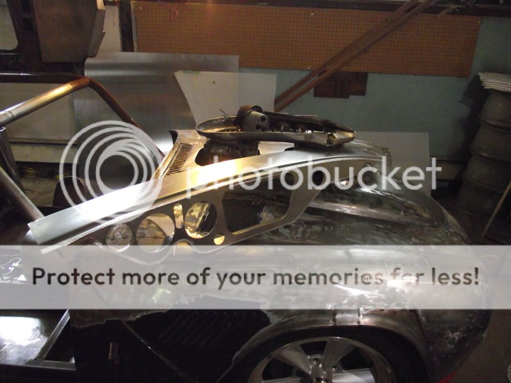

after welding it all together,there's still some detail work to do but it looks like a dash.
once again,when all the stuff is on it none of this will be seen.
