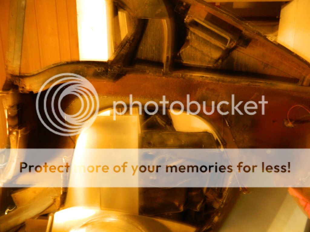

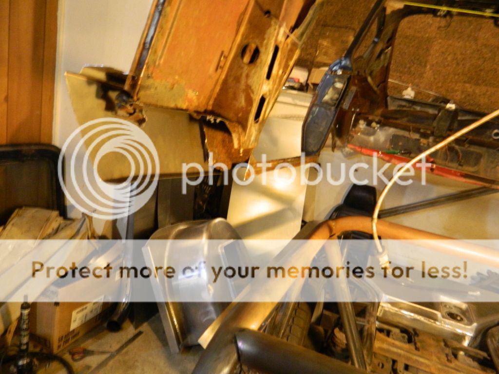

the passenger side rocker has been cut almost completely away.this is what's going to hold the body to the frame,for the most part,so it needs to be structurally sound.

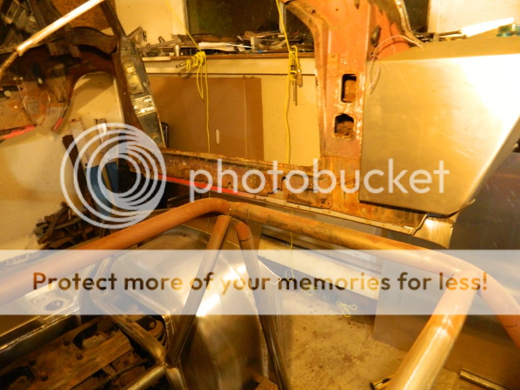

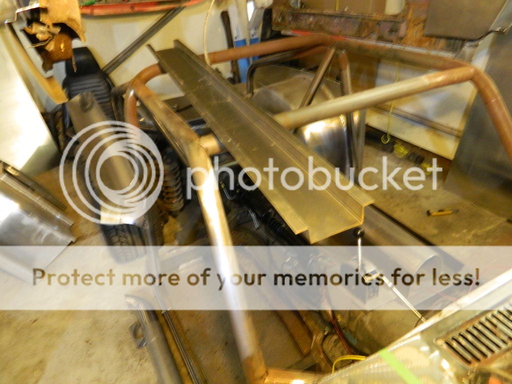

i finally got another shipment of metal in,so i've been able to start making up parts again.this is the new inner panel for the rocker,it's the part that actually meets the outer frame rail to bolt the body to the frame.
Gt-12

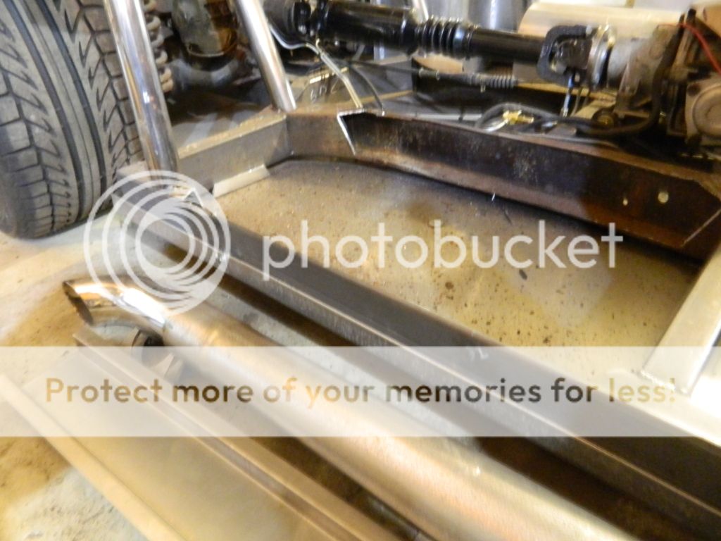

and this is the frame rail it bolts to.
Gt-12

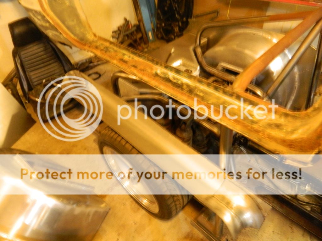

this is the outer rocker i made a while back...it will house the sidepipe and finish the triangle formed with the door sill and inner rocker.
speaking of the doorsill,you can see in this pic that this one is pretty much shot.i left it in for now just to maintain the door opening.it will be replaced.

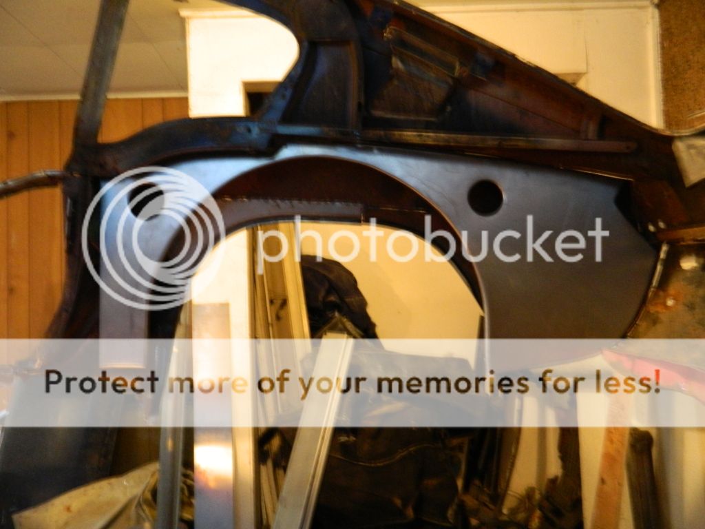

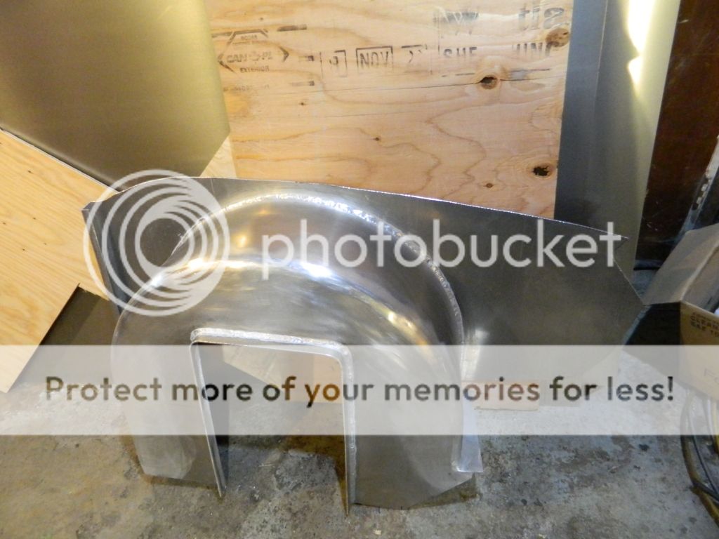

another spot in need of attention now that i have material again is the inner fenderwell.
Gt-12
the tub is intendede to stay with the chassis,the fender-shaped panel is to meet up with a steel panel of the same shape which will be welded into the inside of the rear fender and hold the outer section of the wheel tub...which will also be part of the rear fender and match up with the aluminum tub when the body is installed.

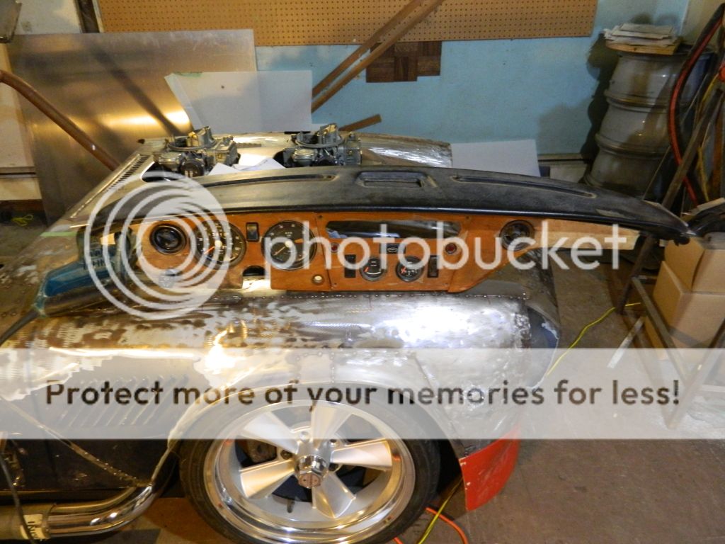

and by the way...that nice aluminum dash?
Gt-12
here's what it looks like wearing (most of)it's clothes.everything has to be freshened up,of course,but as you can see it was just to be the structure to hang all the good bits off of.

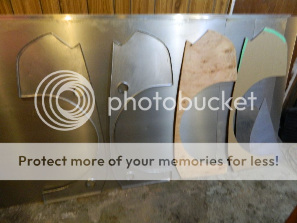

made the inner rear fender panels.it's the usual cardboard template,plywood hammerform,bang on some metal routine.
these are made from 20ga steel as they get welded to the body.

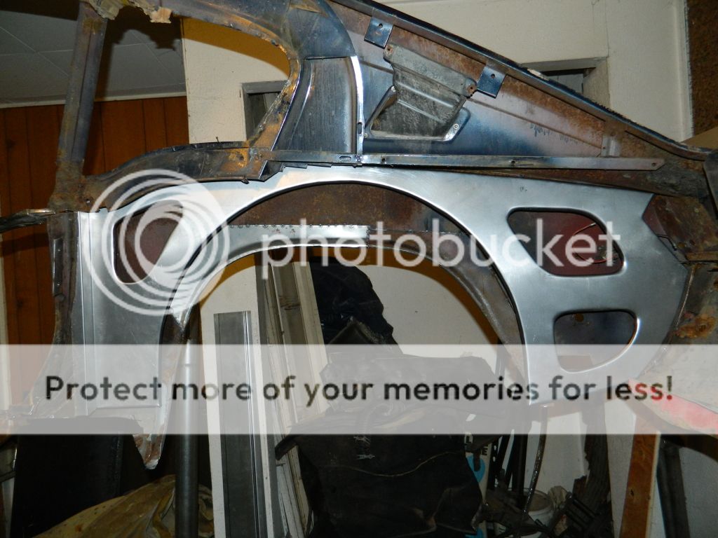

Gt-12
here's where it sits...the outer part of the wheelwell will be built between this and the outer fender.

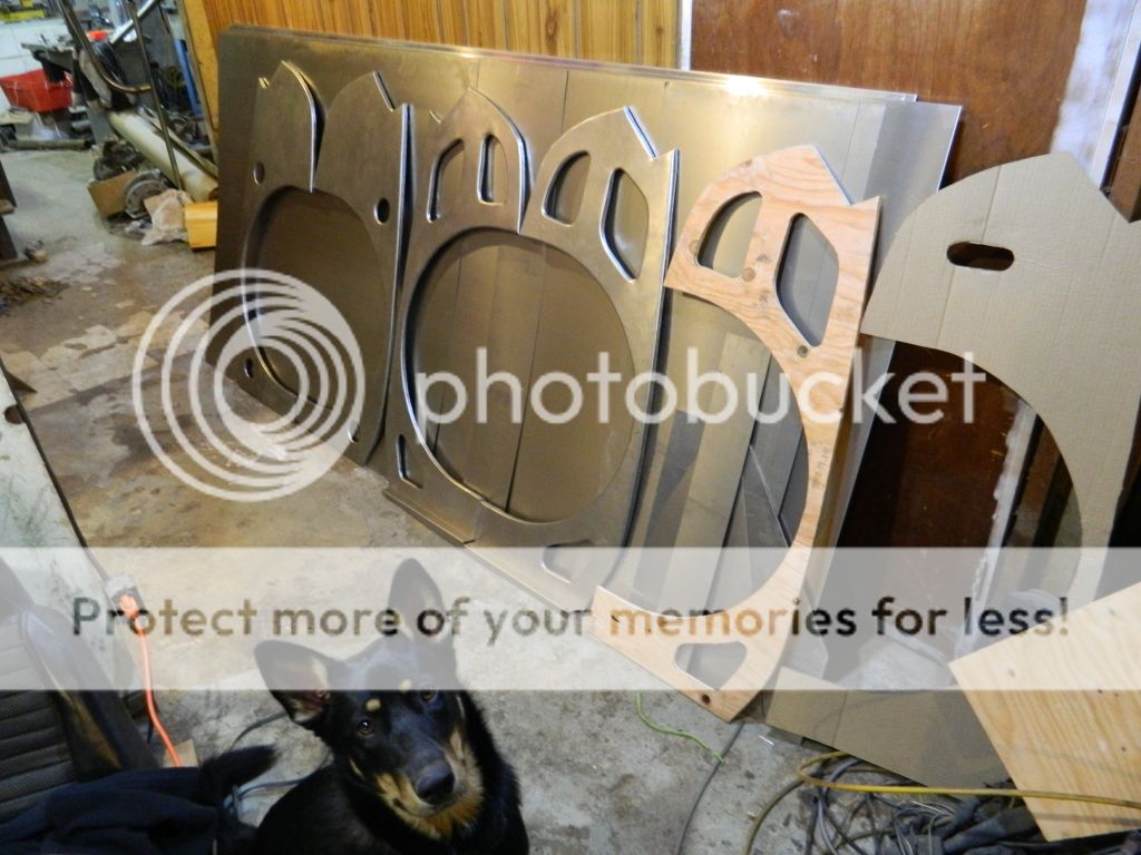

so,after spending some time measuring for the next step,i decided i needed to make some minor changes to my new inner fender panels.
Gt-12
so i made new ones.(that's my lateset apprentice in the foreground-when she gets in the way,i pull her tail,give her noogies,then she goes off and chews her stuffie in the corner)
Gt-12
it's not a huge difference,but i'm happier now.
