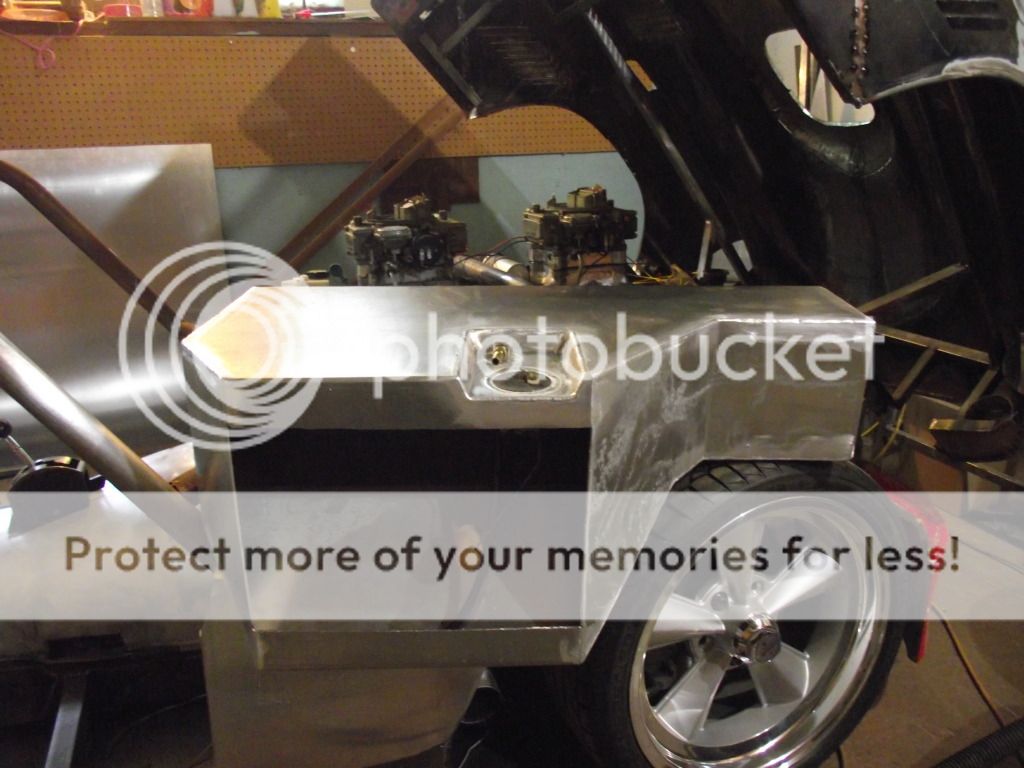

i'm getting closer to having a fuel system on the car.i machined up a couple of fittings to weld into the tank for the sending unit and the fuel outlet.the sending unit is the stock gt6 piece,a marine fuel pickup will be used.
the front panel was left off the tank when it was made to give access to weld these pieces,as well as some baffleing before sealing it up.

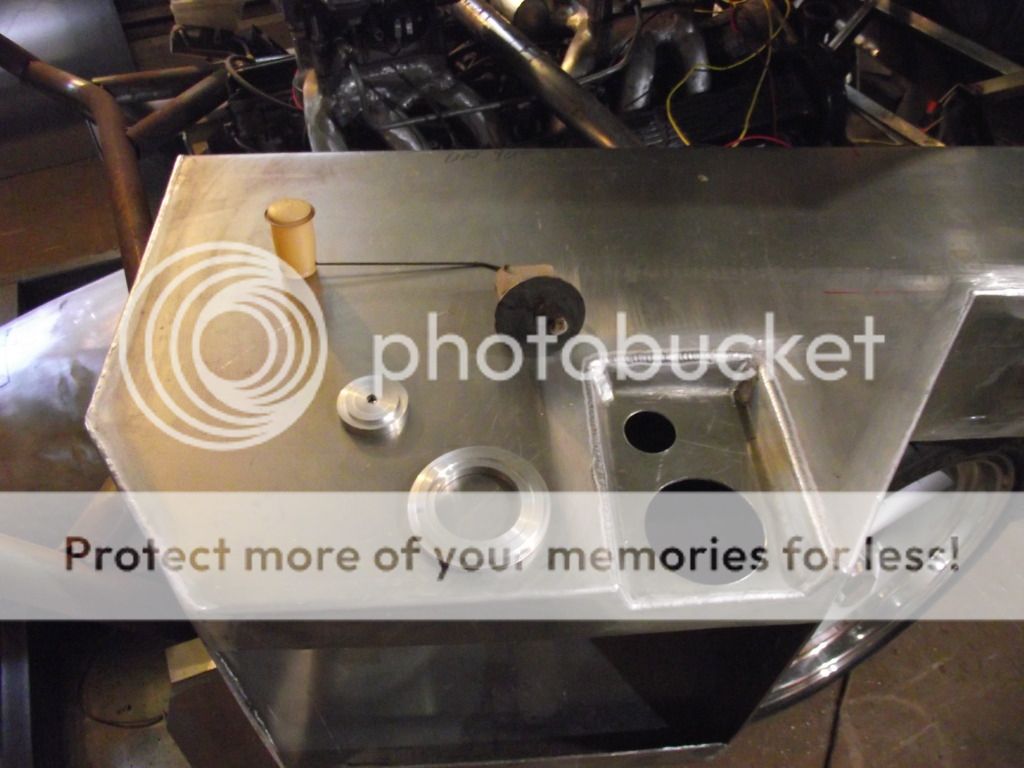

Gt-12
with them in you can see why i put the recessed section in the tank top.in the 'empty' position the sender float is a little above the bottom of the tank,but there is so little fuel left in this spot it's not an issue.
the fuel filler neck will be the final piece to weld in.

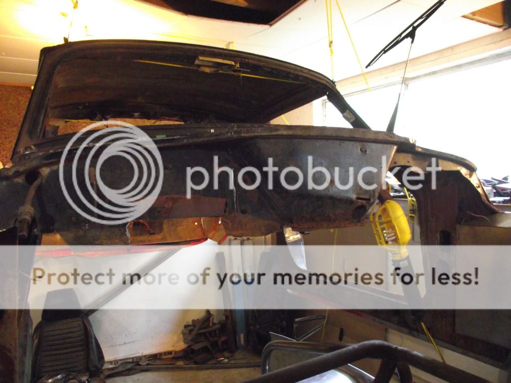

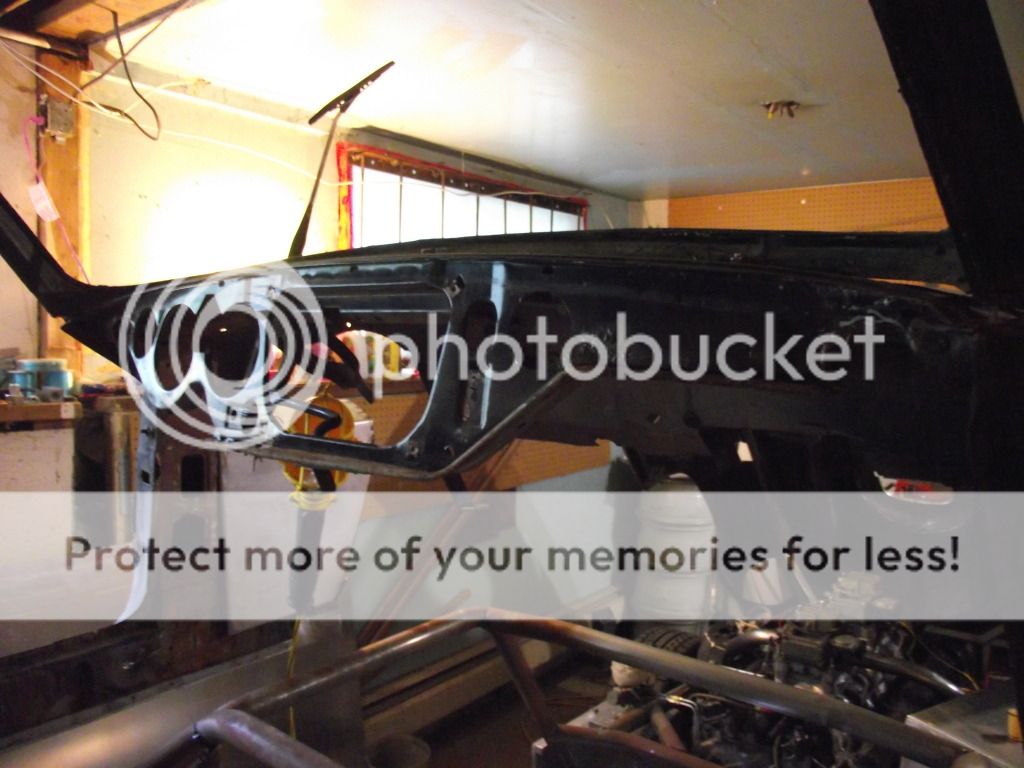

another area that's been causing me headaches is the upper firewall.
Gt-12
as you can see,it's past it's due date.
so i was sitting there looking at it and thinking things through,going over how best to attach an aluminum panel to the cowl,or whether i should just go with steel to replace it,when it hit me.
i want the body to be easilly removeable(remember that from about 200 pages ago?)and having to disconnect heater hoses and such doesn't count under 'easilly'.
the upper firewall would have to be a part of the chassis,and stay with it when the body shell was pulled...leaving the heater installed and unmolested.

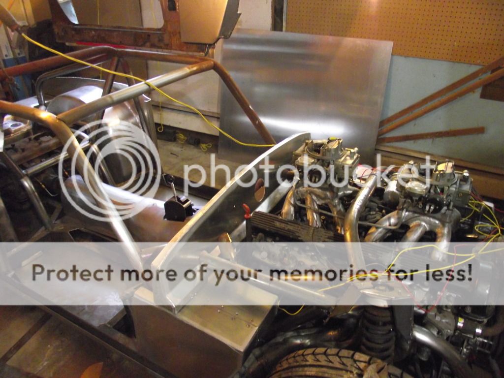

Gt-12

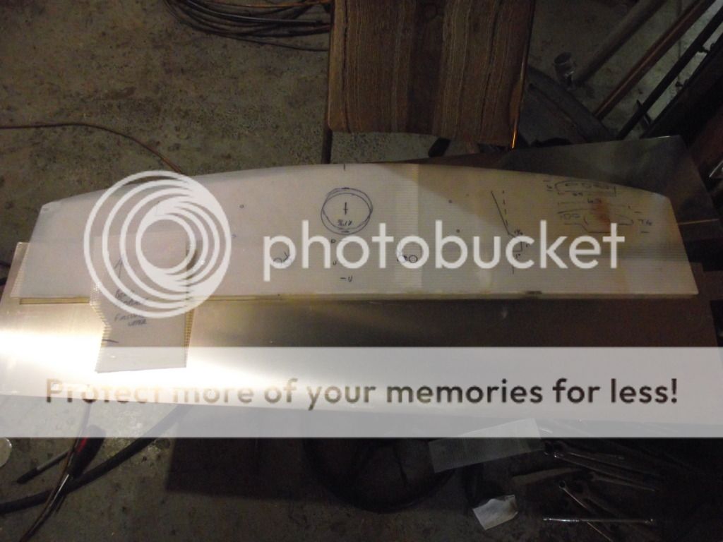

so i made a template and sheared a chunk of aluminum.

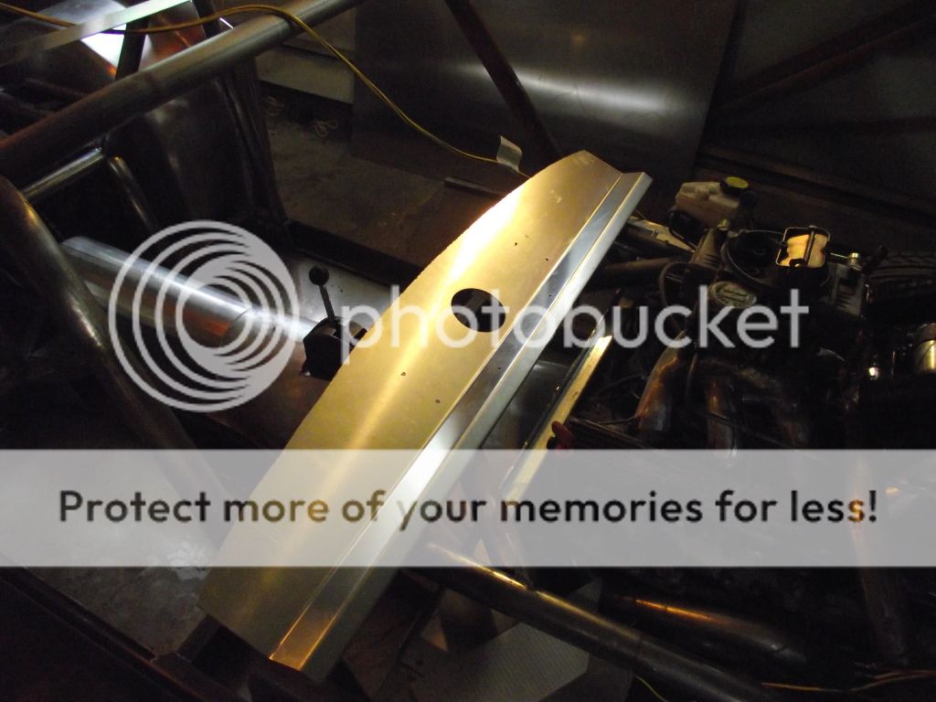

did some drilling and bending...
Gt-12
and welded on end caps and a top flange.i still need to make the air inlet box for the heater that goes in the middle.i'm liking how this is going to work.
