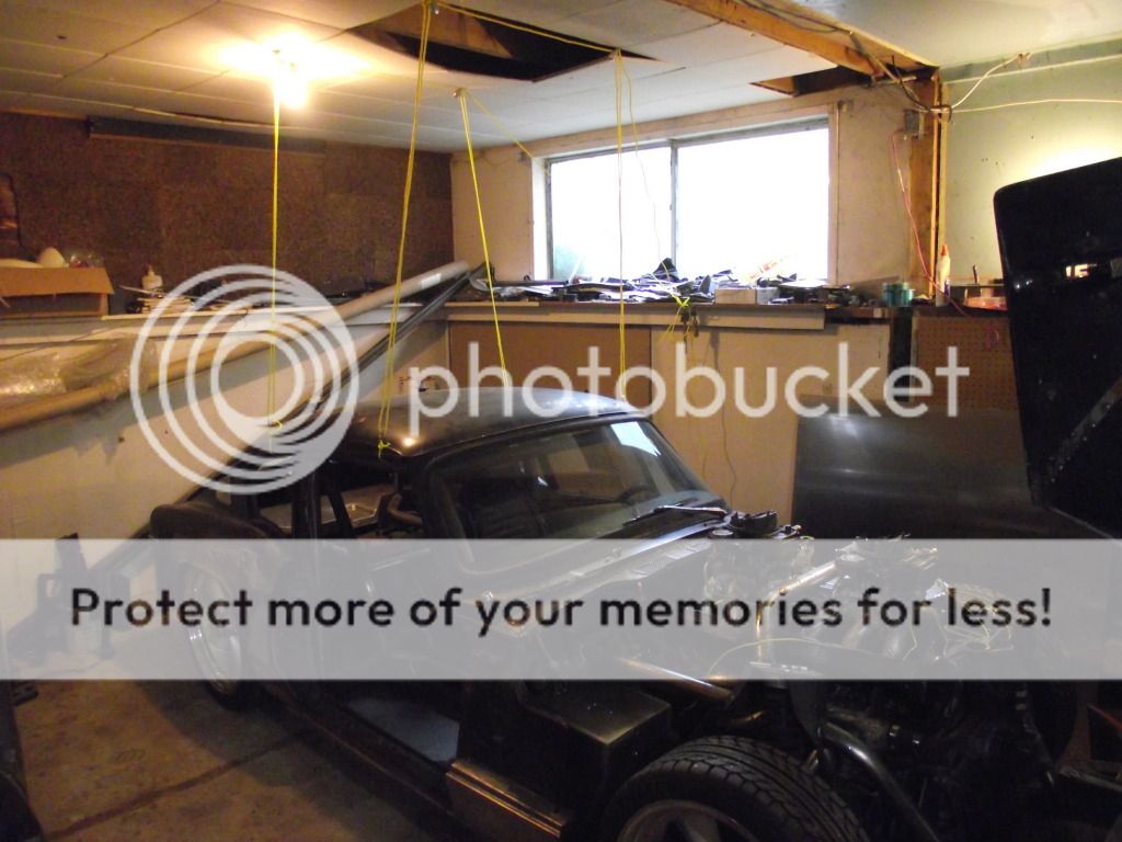

i was having too hard a time reaching a lot of stuff i need to get to,so pulling the body shell up was the best way to go.it's light enough that four hooks screwed into the floor joists and some utility-grade pulleys with some 3/16 poly rope allowed the body to be lifted free and hung from the ceiling.
i'd forgotten how much easier getting at the interior was before the body was put on.

well,a body lift,of course!

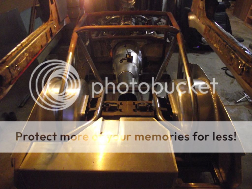

one of the first things i did after pulling up the body was to get the rear tubs in place.
i really like the looks of all the aluminum coming together.shame it`ll all be covered over.

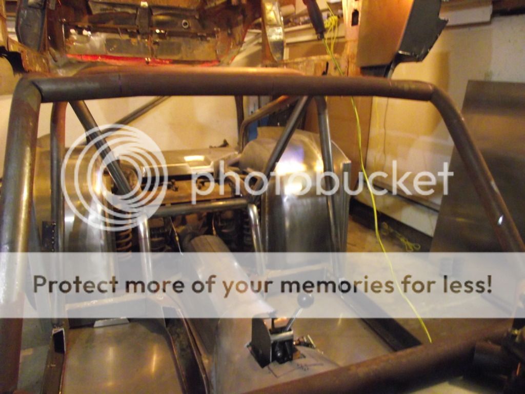

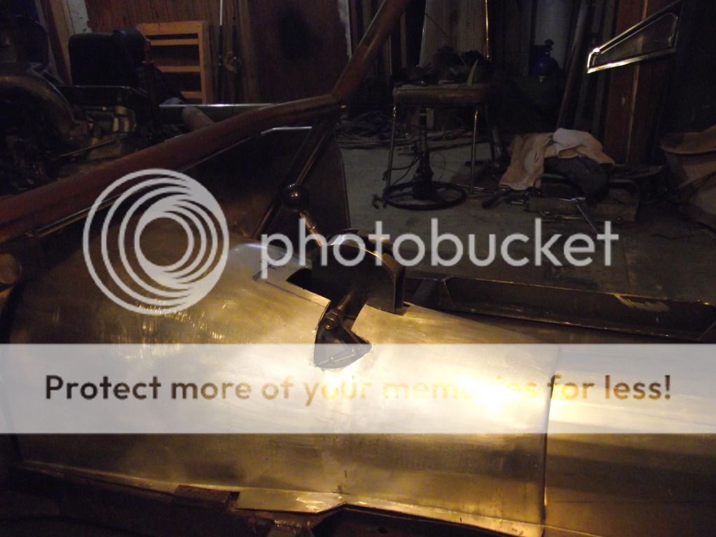

the downside of the new shifter linkage-my nice clean trans tunnel has to be hacked up to clear it.i`ll make it all look nice and i`m real happy with how the shifter works,but still,it was a bit of a shame to chop it full of holes.
some really nice aluminum work there Tom:icon_thumby::icon_thumby::icon_thumby:
I understand about the shifter linkage....but sometimes function out-weighs form:D:D
