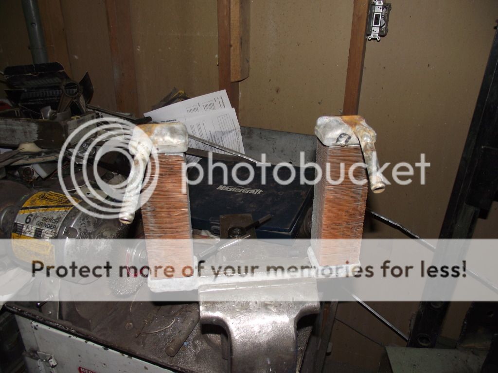

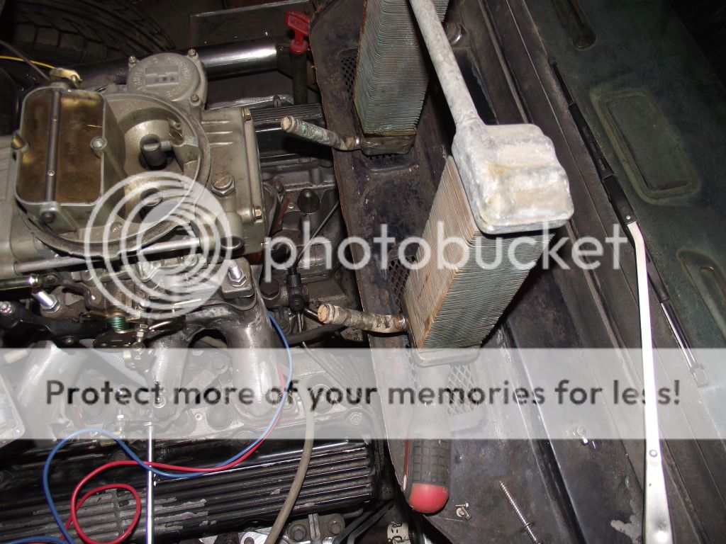

i commented above about working on the heater-i'museing the stock gt6 heater in this car,but had a couple of minor fitment problems.one is that where the tubes come through the firewall,they were just a bit wide apart so they'd get into the heads.
here you can see that the tubes are offset to the outside on the tanks.i don't need a huge difference,so...

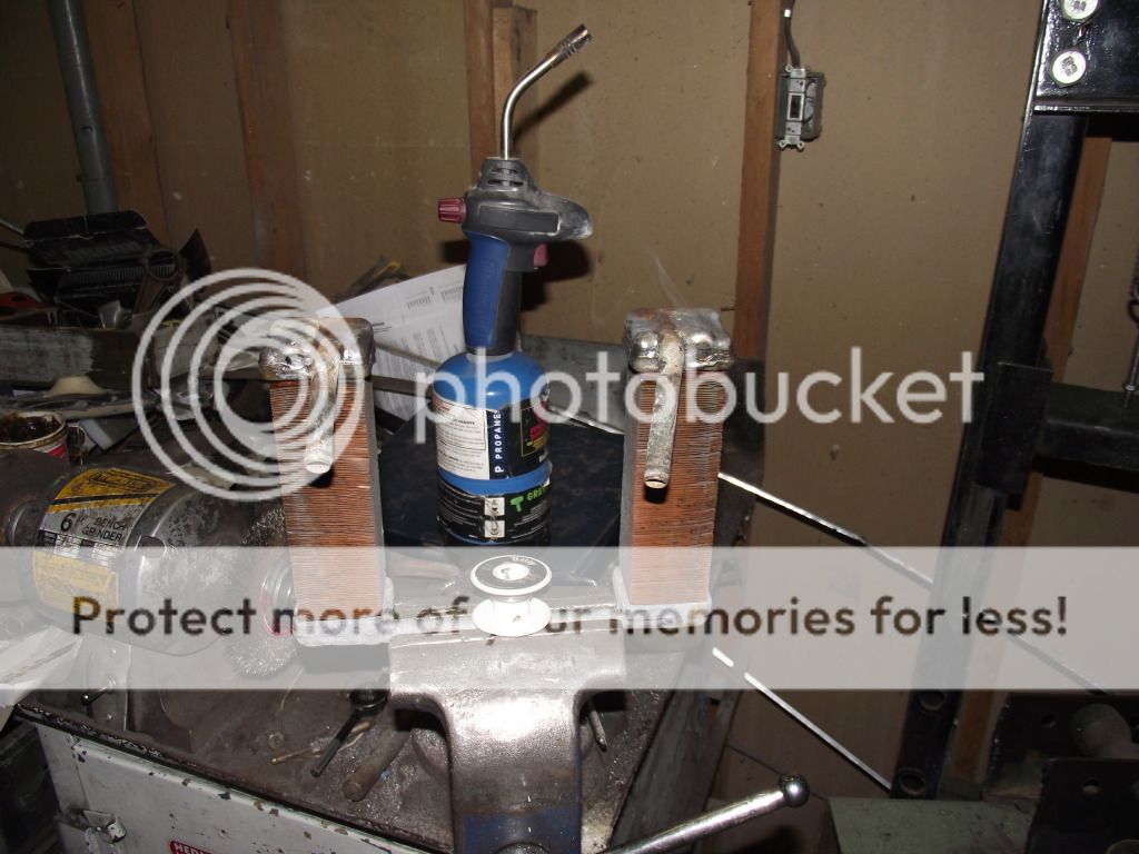

i swapped the tanks from one side to the other.this gives me just enough to get them between the heads.the heater core is in remarkably good condition,so the soldering went very easilly.
below where the heater core is sitting is where the tubes come out of the firewall.now i can get hoses onto them once it's installed.

that's a weird looking heater core... so the driver gets semi cold coolant then eh?
