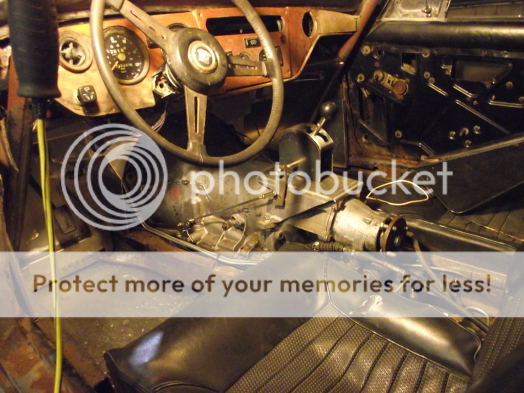

we're getting the first big storms of the season(power was out for about 6 hours last night)so i was back to inside stuff today.figured it would be a good time to get the shifter working properly.
Gt-12
i made some changes to it,running a pivot out the side with an arm that a solid link could work off of.this also allowed me to lower it by about an inch.
after a bit of time spent adjusting stuff,i'm really happy with the results.it clicks into every gear positively,and the action from park to reverse,park to drive,and low to drive are exactly as i wanted them to be.
now i'm getting the throttle hooked up,i've figured out where the links need to go.now i just have to build them.
that shifter looks sweet dude!
