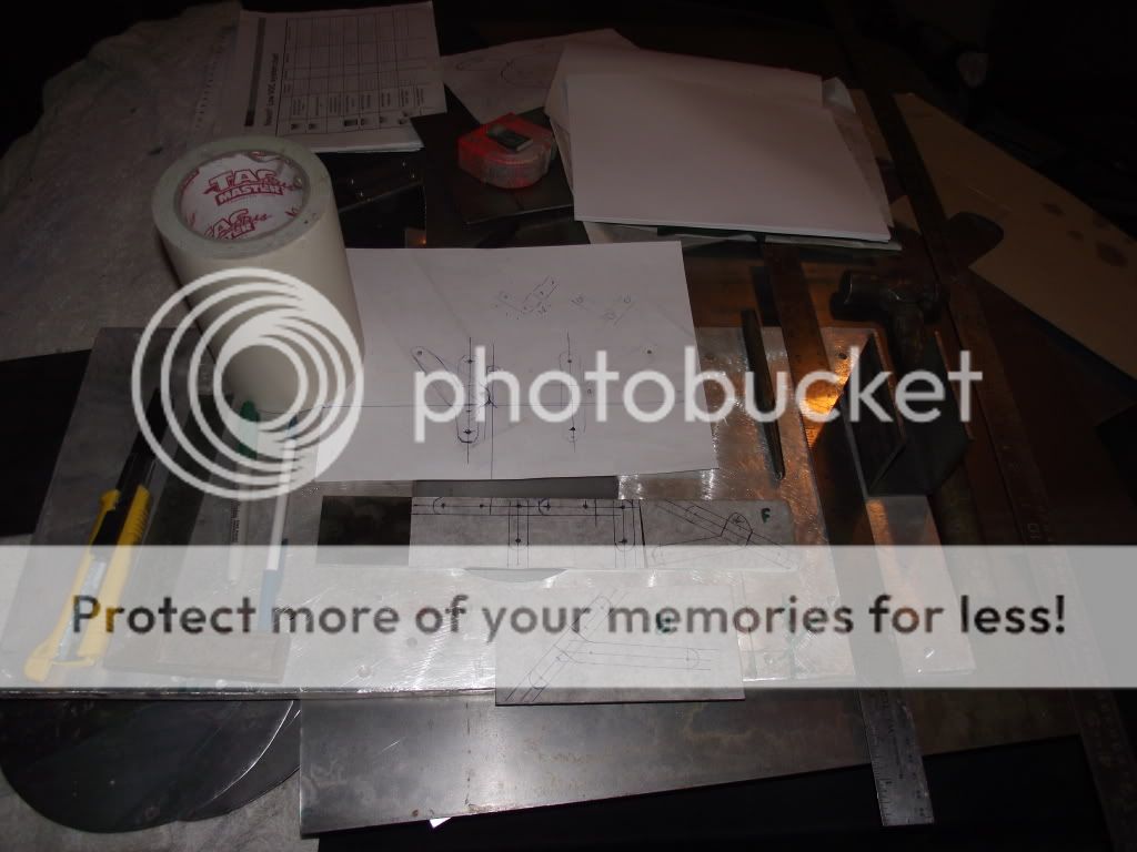

aaaaaannnyway....was making some carb linkages....

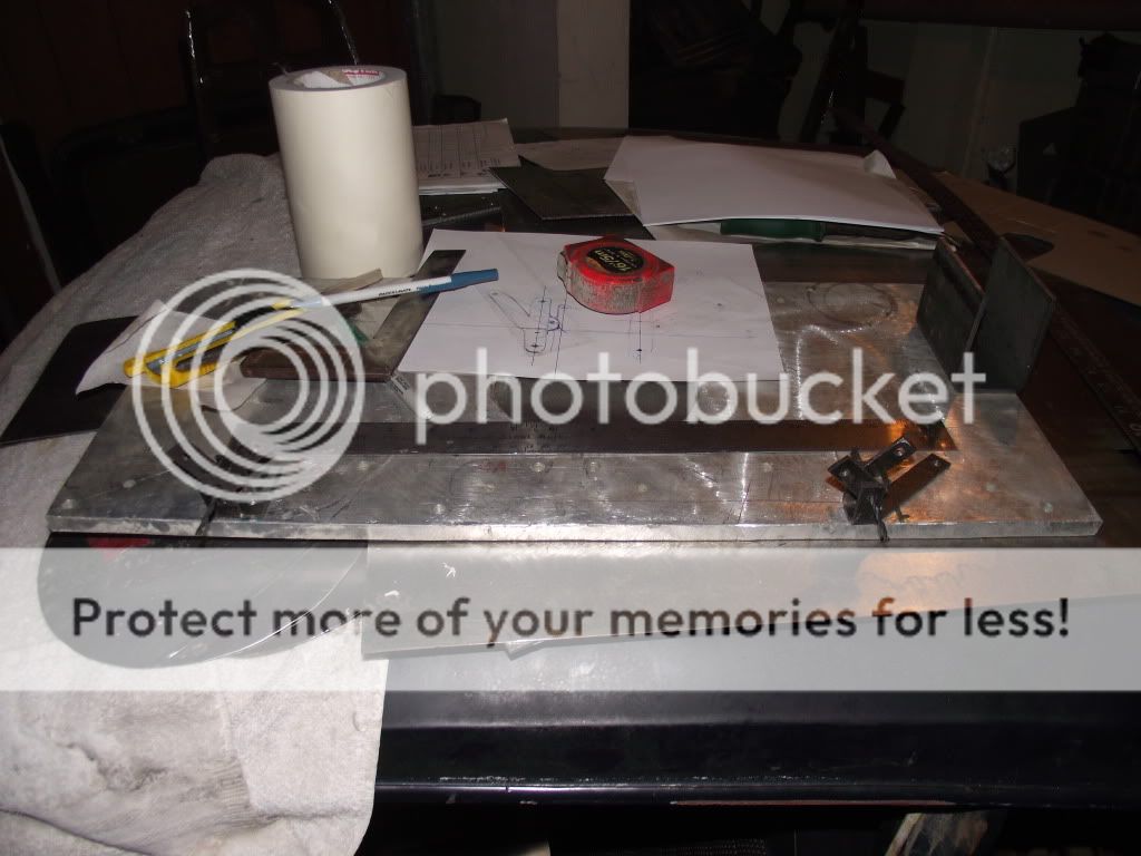

there will be a bellcrank bolted to the intake below each carb.these need to be formed from 12ga steel,as well as the brackets that hold them.i cover the steel with tape so i can draw on it with a ballpoint pen,with small parts like this a felt pen just isn't accurate enough.
after cutting them out,drilling some holes,and bending them up.....i have some linkages.the brackets will bolt to the intake studs,so i used the jig for the intakes to figure them out.the parts i'm waiting for are the ball joints that will connect everything together,but i was still able to get these ready ahead of time.

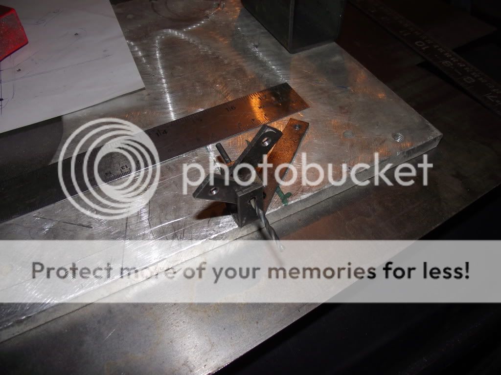

a closeup of the bellcrank.i still need to round off the corners and such,as well as get a real pivot where the drillbit is,but that's the basic shape.a link will go up to the carb from one arm on the crank,and a link between the two cranks goes on the other arm.the cable that goes from the throttle pedal to the engine pulls on this arm.

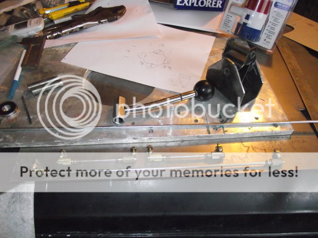

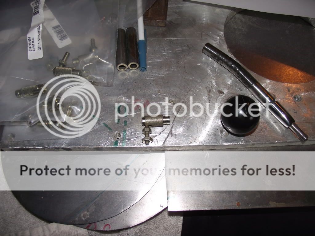

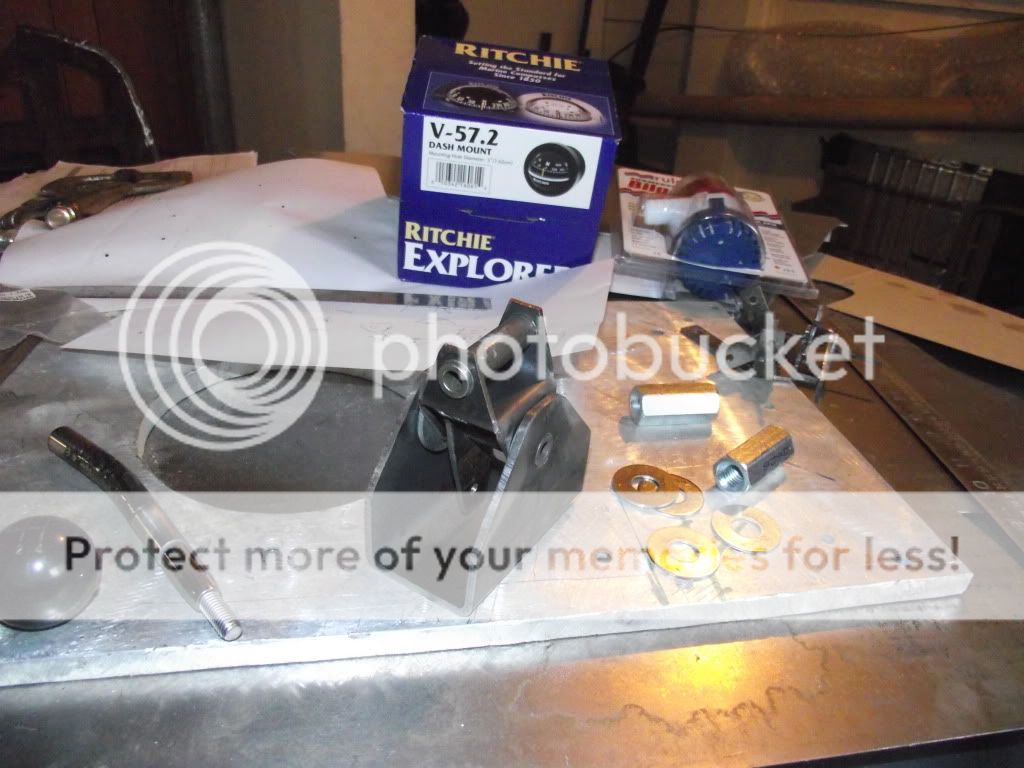

so i've been plugging away at the shifter assembly.the shifter arm it'sself is made from a chunk of 1/2'' stainless rod.the top inch or so will poke out of the shifter boot,so i put it on the lathe and tapered it a bit before polishing it up.the groove a bit down is where the boot will be tied on.
the mechanism is the big black thing....still some parts to make for it,but it's coming together.i'll be using the stock gt6 shifter knob on this.

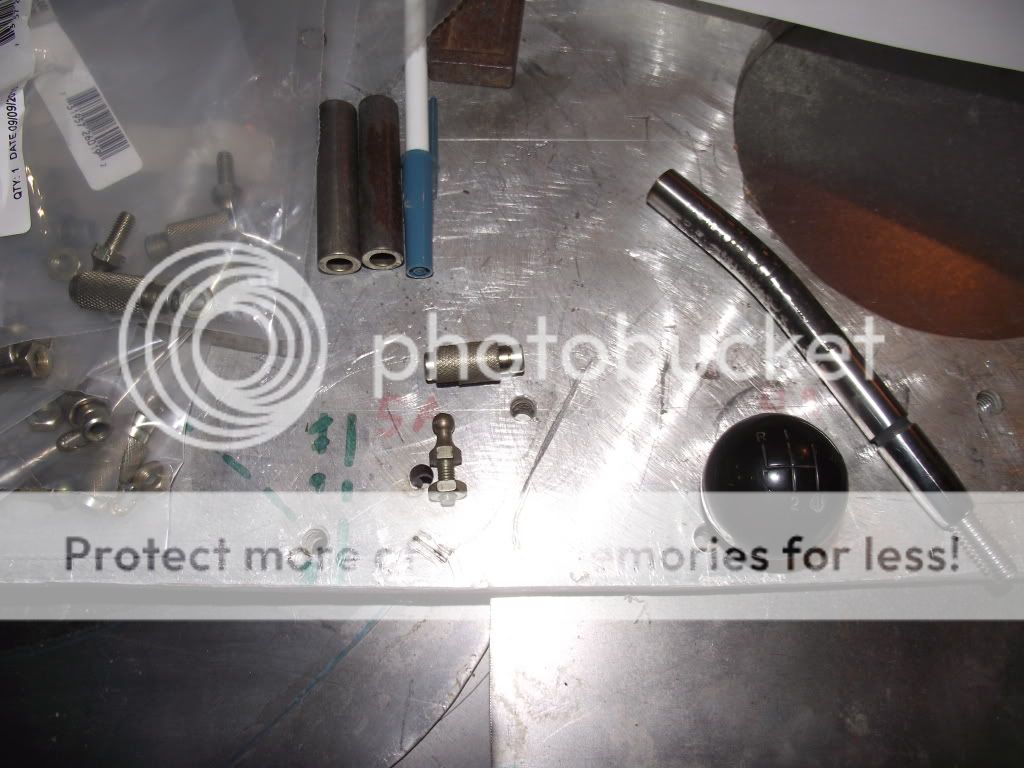

the ball joints for the throttle linkage came in today.after searching all over the carb manufacturers and custom parts places for these with no luck,i found a good selection in my marine parts catalog.these are a top-quality take-apart unit,but are expensive at $13 each.
to take it apart you just pull back the sleeve on the female section.this makes for quick service,but is secure when in use(marine stuff is made not to fail easilly)
while i was in the catalog i also got a compass and bilge pump sent up.boating season's coming up fast:headbang:
i went down to the hardware store in the hope they would have 3/16'' rod to make the links from.....and lo and behold,there it was.at three bucks a length it was one of the few things on this car that's reasonably priced.a few minutes with a 10-32 die and i've got my throttle links happenning.
