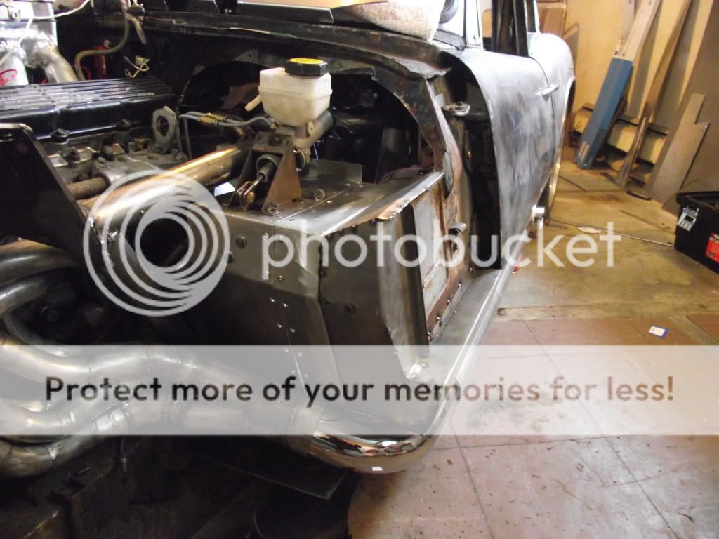

i was doing some work in the firewall area.notice the outer corner has been filled in.i only got to the left side so far.

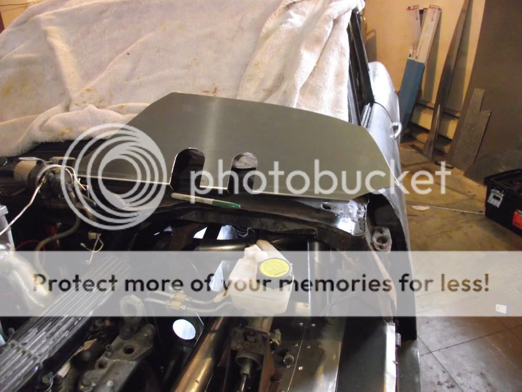

i also formed the panel for the top of the firewall's left side.i can't install it untill i raise the body from the cage,though.

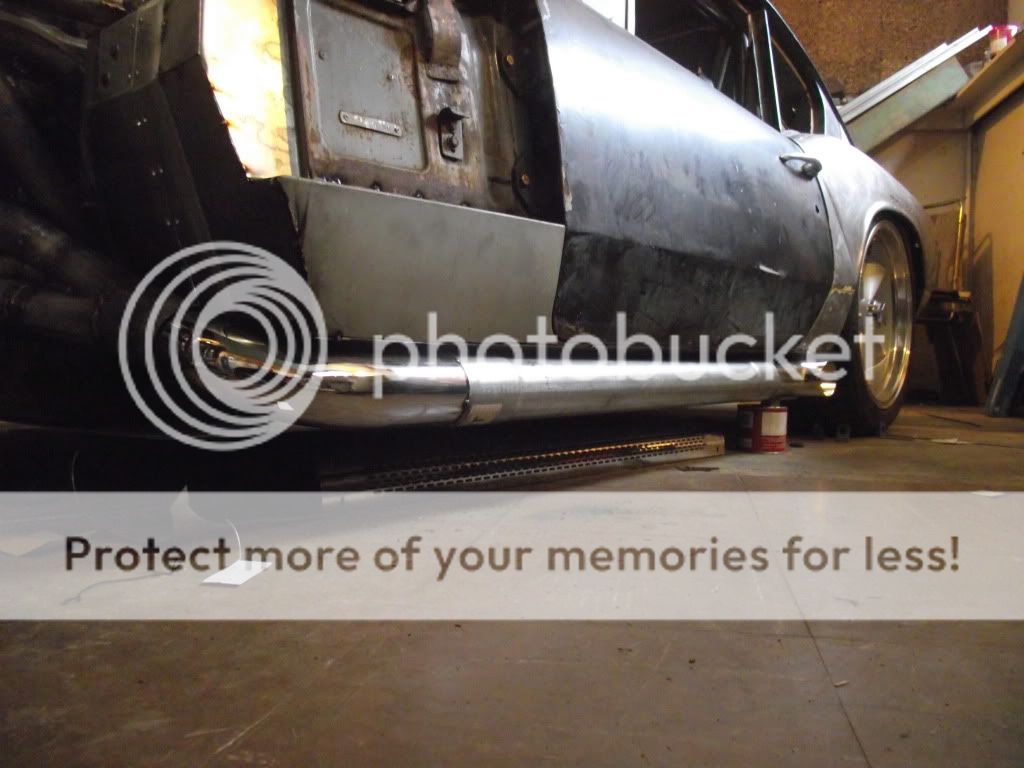

the rocker panel insert for the left side that goes behind the pipe is fitted,now i can sort out how to mount the pipes.

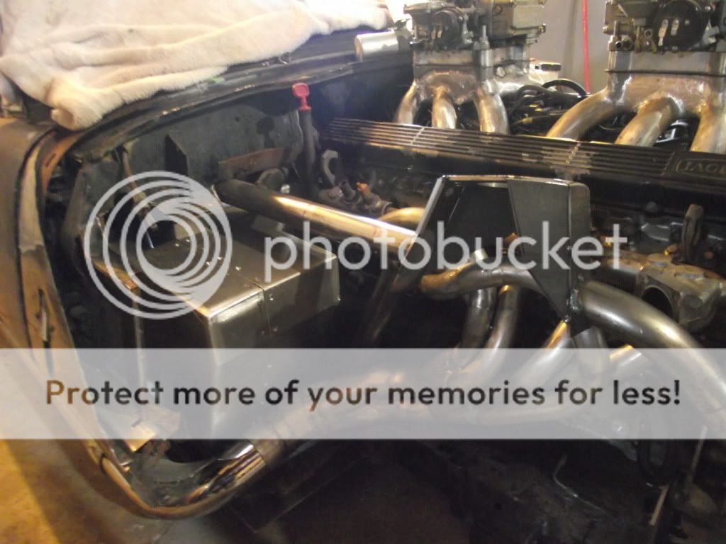

and the right side header is finished and installed.once the sidepipes are hung i can fire it up to see how it sounds.
