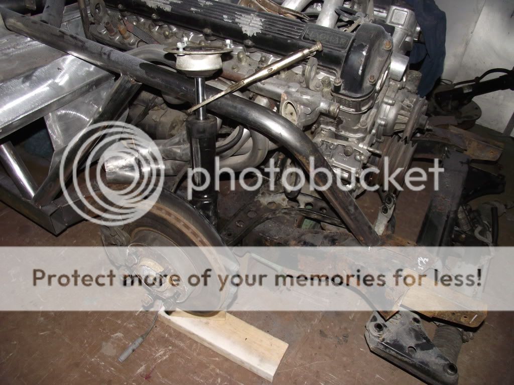

anyway,i got the struts together(shortened 4 1/4'')and things placed where they need to be.just planning out my mounting points right now.

some photos from yesterday(net's back to normal)

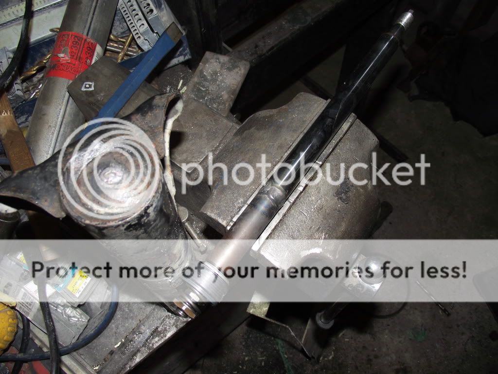

the shaft from the strut....
to shorten it,i thought of getting all fancy and re-machining the end,but cut and weld is way quicker.i went low enough on the shaft to keep the weld away from the seals and guides,and high enough that the heat could be controlled at the piston end(don't want to damage anything there).i also figured it would be a good idea to close up the hole i drilled in the end of the tube.

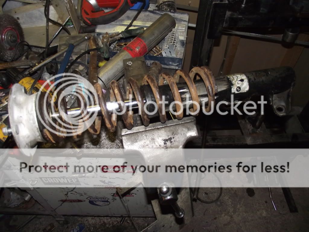

the strut assembled,and the spring just placed on it for a size comparison to the bmw one.still need to make pads for these.
everything blocked and clamped again to figure out mounts.

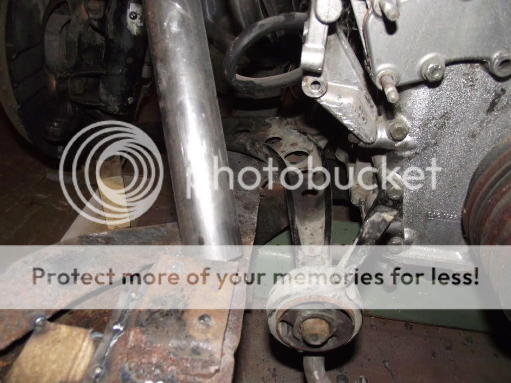

the front mount for the lower arm.i just need to put it a crossmember in front of this with a tab for the mount to bolt to.
