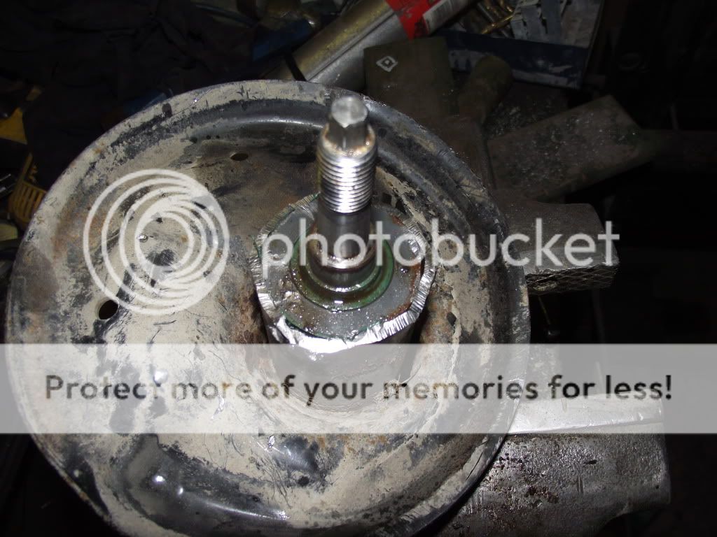

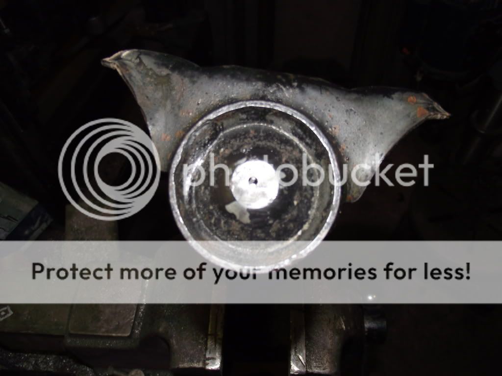

i didn't know if these were pressurised,and didn't want to take a chance opening it up,so i drilled a small hole in the bottom.there was no pressure,so i was happy.less to deal with on reassembly.
Gt-12
i used a cold chisel and hammer to cut the top crimp off.

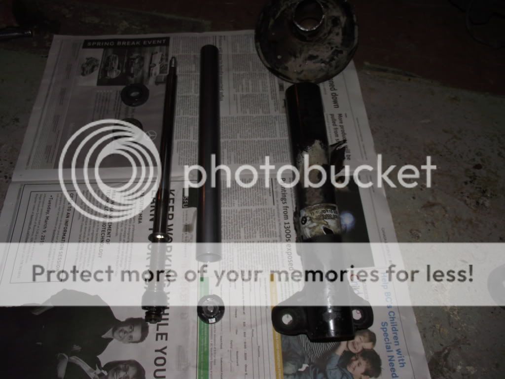

all the bits laid out.now i get to form a plan on how to shorten it.note that the top of the tube has already been cut off.this was to get the old spring perch out of the way.

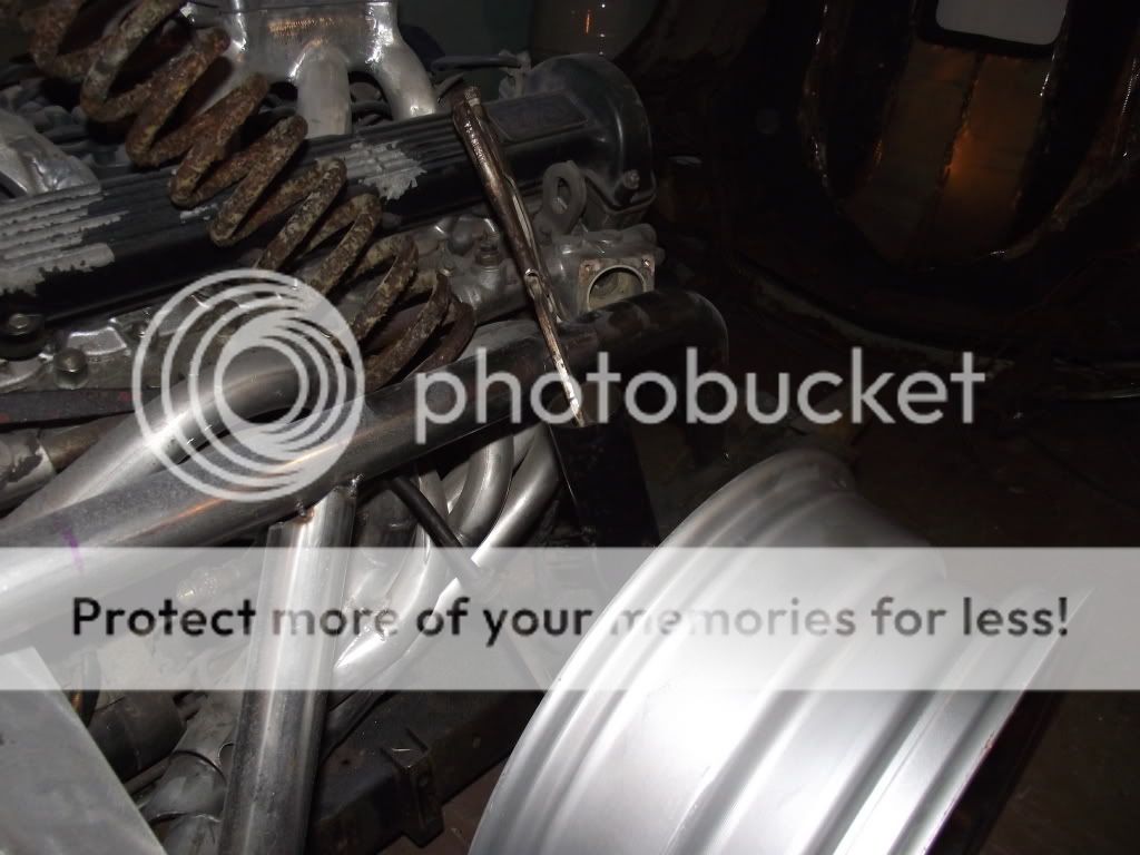

the quarter eliptical was my first idea,actually.i was thinking back to a '67 holman-moody 427sohc mustang the guy across the parking lot from my shop in mission had,it was set up that way.unfortunately,there isn't room along the frame as the wheel needs all that space for turning,and i also thought about transverse but that would require going under the frame.that's against the rules on this build(nothing lower than the frame bottom.)i think theres room to use the original gt6 springs,but i still need to confirm this.

ok,preliminary measurements look promising.
Gt-12
with the strut clamped in place and the wheel bolted on,i found there is room to use the gt6 spring,but i need to cut out a section of tube to build the hanger.there is 4" clearance above the tube to the hood,so i have some space for travel.i only need a few inches,so theres enough room.the gt6 spring is 3 3/4'' diameter,the bmw ones are 7'',so that's a big space saving.

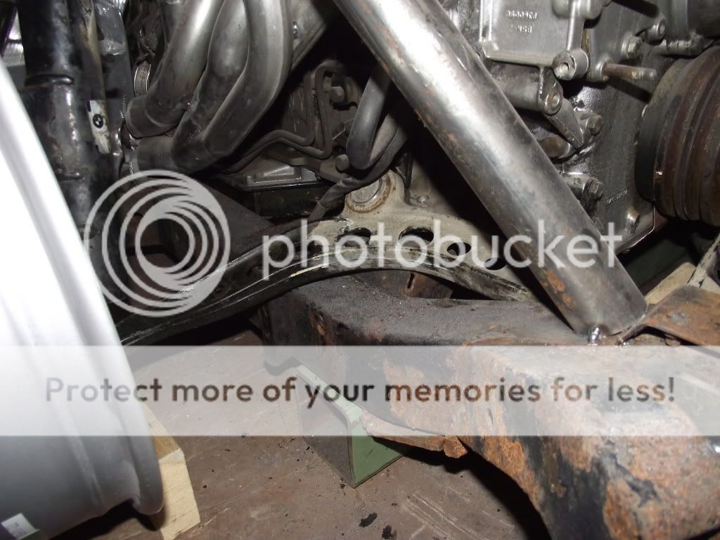

i thought i would need to cut up the bmw lower arms,or make some from scratch.turns out the lower ball joint is high enough that the arm can go above the frame rail.
Gt-12
it is designed to run back to a pivot below the firewall.i have room for this on the passenger side,but not the drivers side(the oil filter is in the way).if i use the left arm on the right side,and vice-versa,that pivot can go forward.this allows me to use the arms intact,and still have nothing below the frame..
