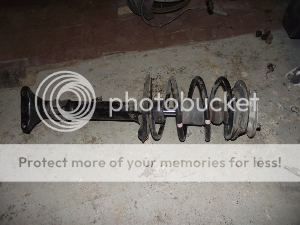

been pondering the front suspension for a few days,trying to figure out how to stuff the bimmer stuff under the gt6 hood.i like the strut system(it's simple)but have two problems with the parts i have.
the springs are too big around,and the struts are two long.

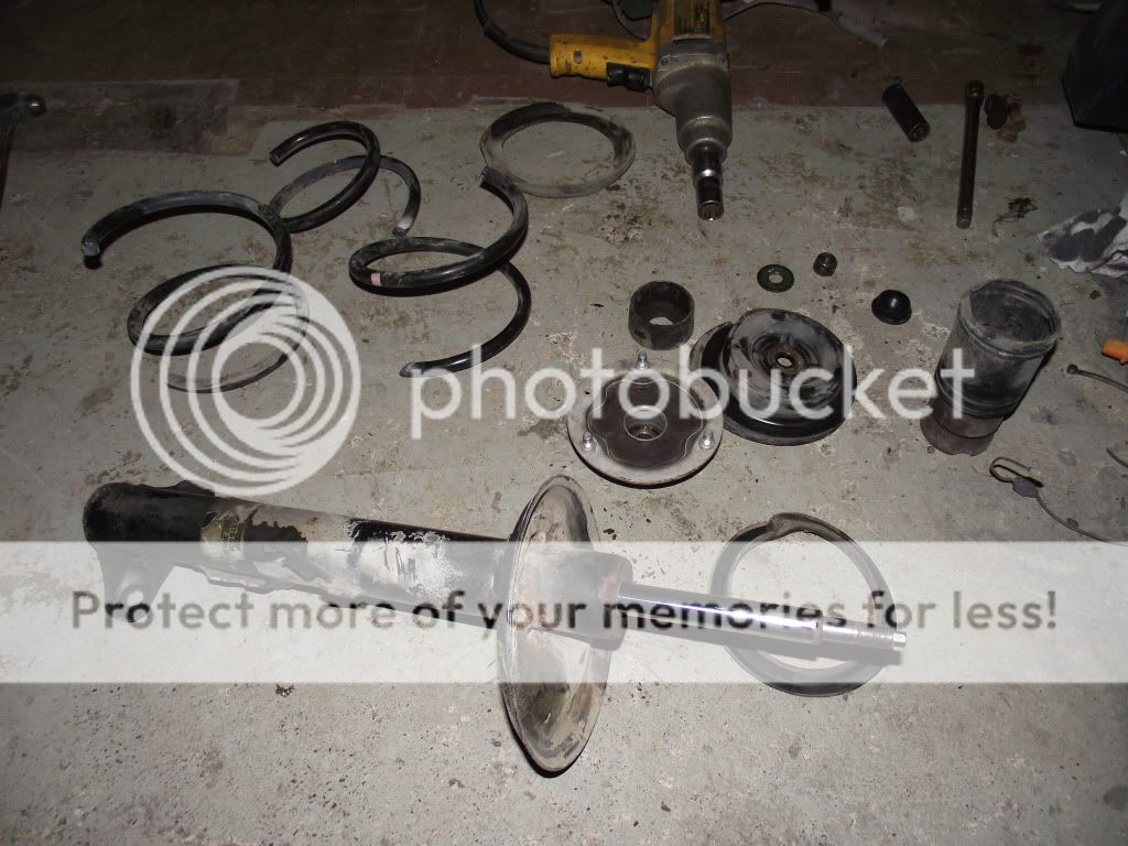

i've never tried modifying one of these things before,but i have nothing to lose by trying.
Gt-12

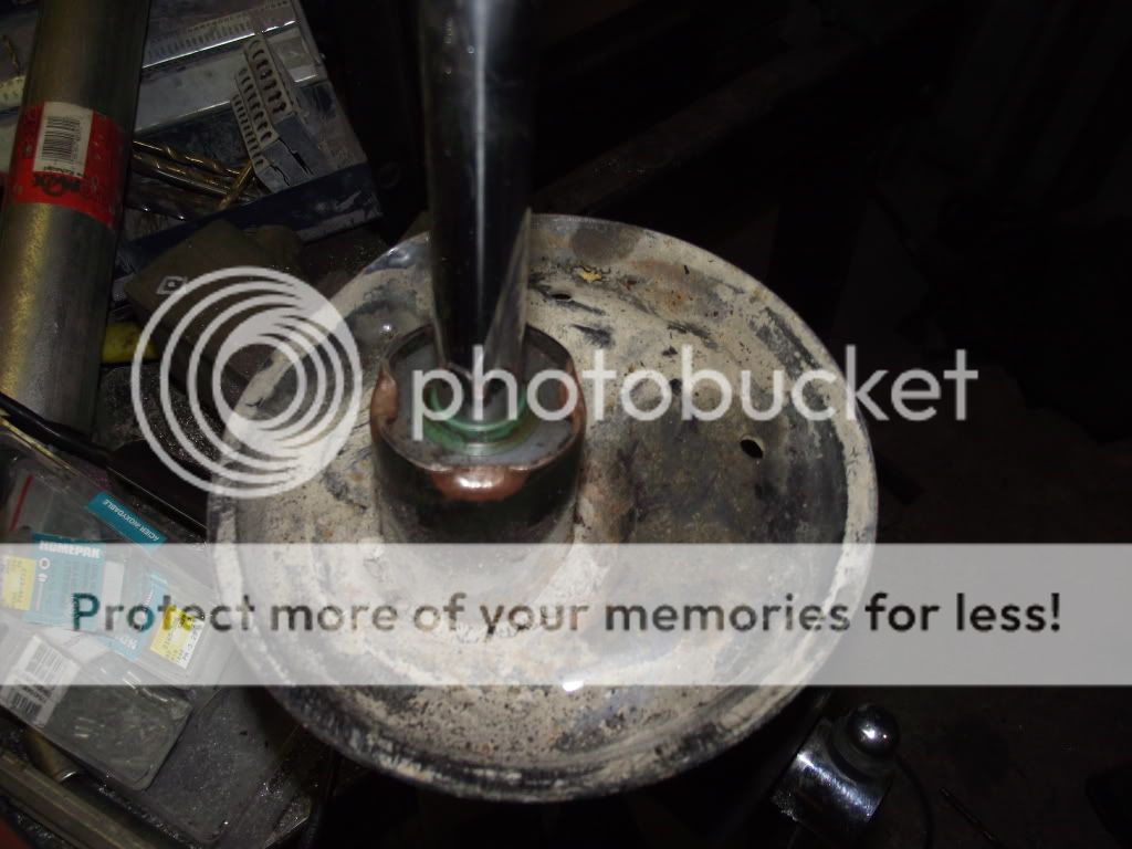

started by removing the spring the fast way(cutting torch) as it won't be used,then stripped the hardware off the top.
Gt-12
the assembly is held together by these crimps at the top.
Turn them sideways?
Richard
