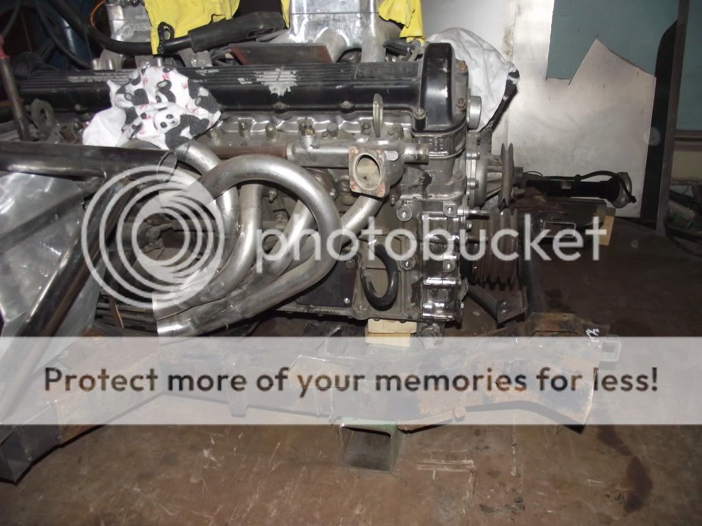

351w....but you can't see the pass. side exhaust from under the hood.i'll post some pics in the truck's thread later.

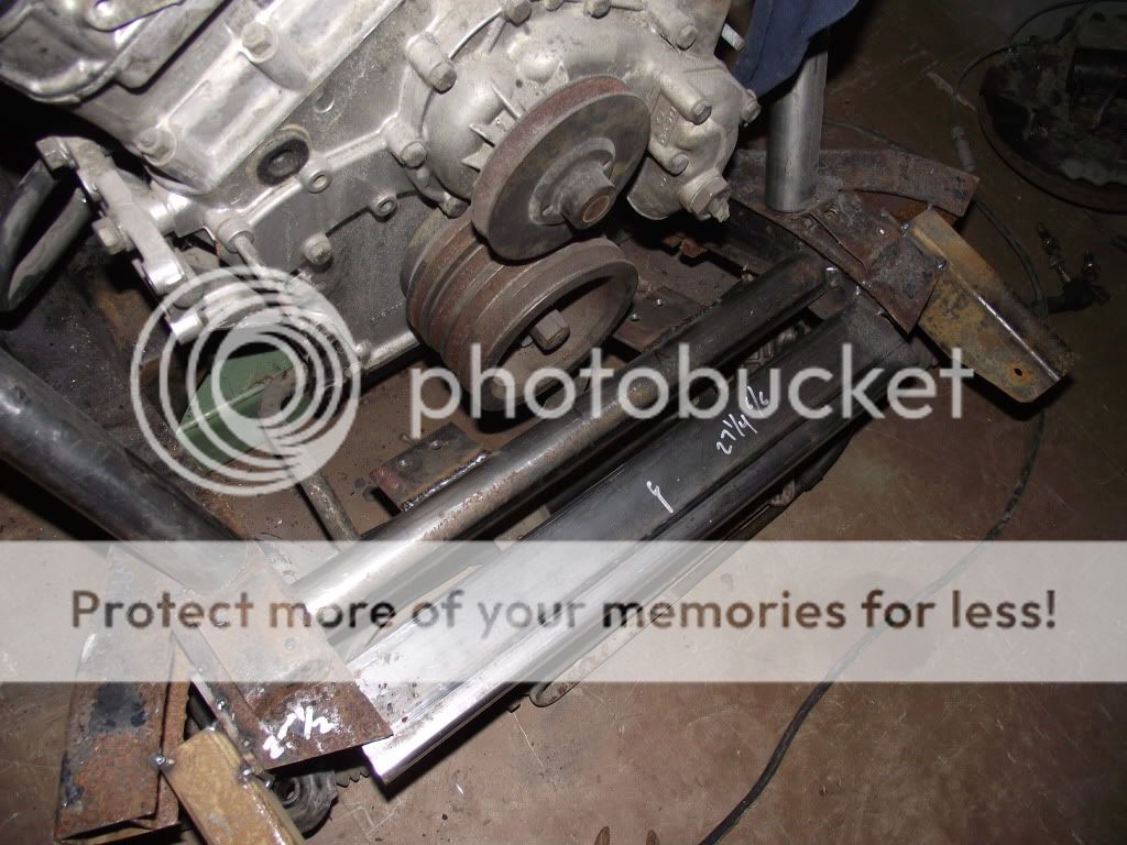

here's what i meant about having a crossmember with tabs on it to mount the front of the arms.

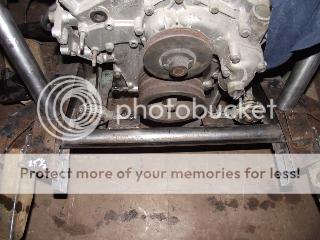

Gt-12
with the arms bolted on.the rectangular crossmember was not needed anymore,and would be in the way of the rad anyway(yes,i can fit one in here!)so i cut it out.
now for the interesting part...the rear pivot on these arms lands very close to the engine block-and right in front of the engine mount location.
Gt-12

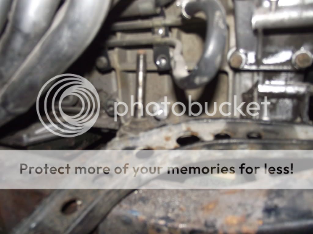

so my plan is to actually mount them to the engine.the bolt holes behind the stud are the engine mount holes.i'll put a plate here,and weld the tube from the bmw to that so they have the proper taper to lock the stud in place.

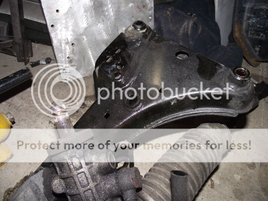

Gt-12
the hole in the middle of this pic is the sleeve for the control arm pivot on the bmw crossmember.i'll use a holesaw on each side to free them from this so they can go to their new home.

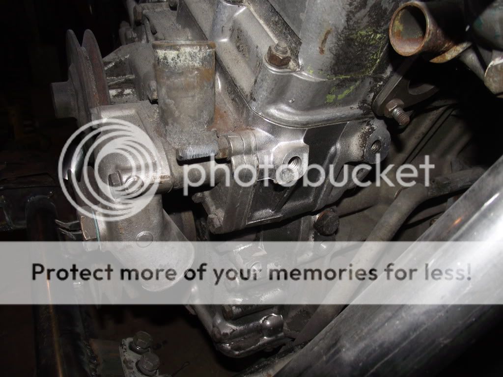

Gt-12
it has these holes on both sides at the front of the block,so i think this is a good spot to mount the motor from.accessory drives could get a little tight.oh,well.

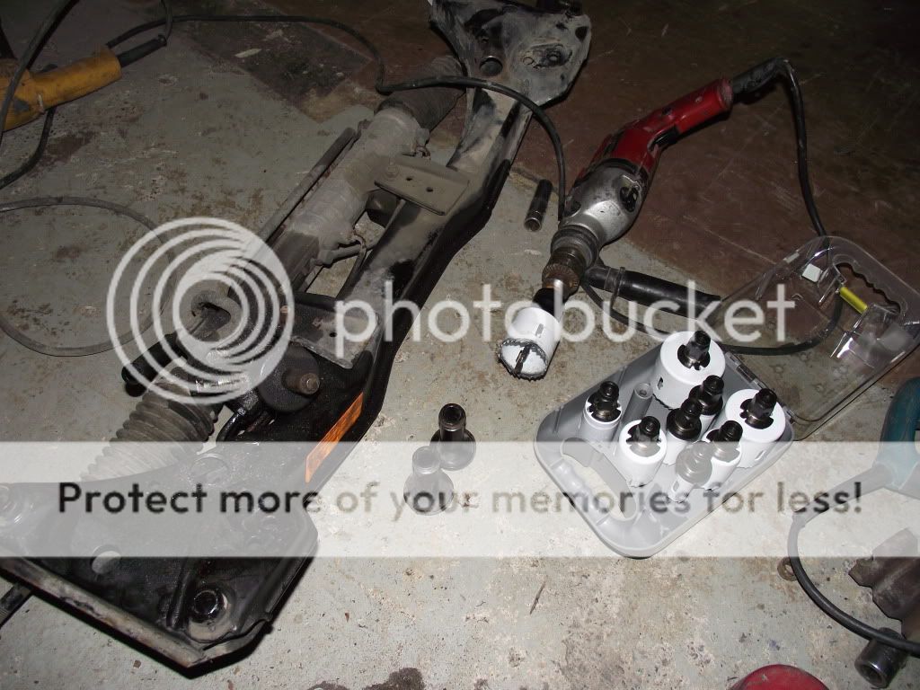

back to the good stuff....
Gt-12
as stated earlier,a holesaw was used to remove the sleeves from the bmw crossmember.that's them right in front of the drill.i just got this holesaw set a little while ago,it's pretty cool.it has 9 arbors each with a different saw size,and a quick release holder so if you need to change sizes,or remove the saw to get a plug out,it takes less than a second to do it.

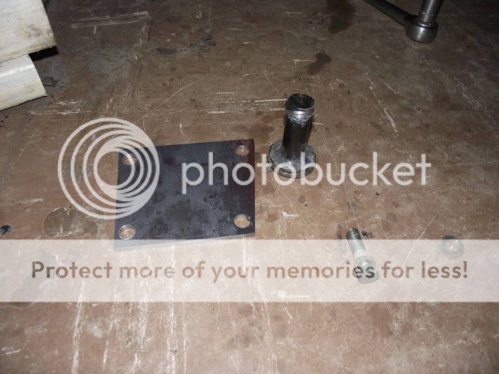

Gt-12
the plate for the block,with the sleeve.
