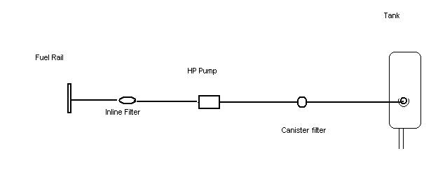

You will need to make sure the intank pump is working also. If it is bad it will cause the high pressure pump to fail eventually unless you keep the tank full. It was 88-89 they switched to a single pump in the tank it seems the dual fuel pump system is allways problematic especially with age.
You may have blockage in the fuel line also or in the pickup tube try disconnecting it and giving it a blast of air. Another good fuel system cleaner is 4 ozs of acetone in a full tank of gas once you get it running good put a small amount in once a year to keep the varnish from building up from the new fuel we are seeing at the pumps. Most fuel injector cleaners have a high percentage of acetone at about 30 times the cost. 3 to 4 ozs is all you need to add to do the same job. In my opinion

Hats of and kudos to "kimcrwbr1" :icon_thumby::icon_cheers:, you had the winning solution. It was a blockage in the cartridge canister fuel filter. The top line was plugged up with crud. Cleaned it out and BINGO running like a top. THANKS TO ALL who replied on this.:yahoo:
