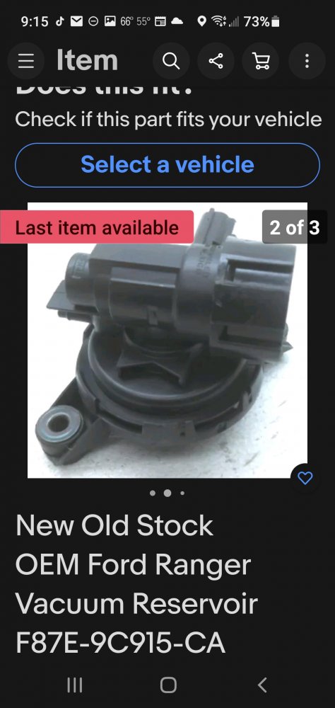

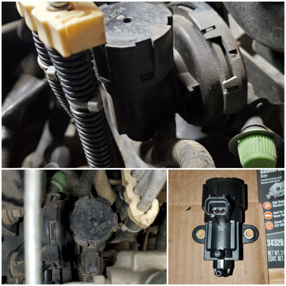

Ron, I have a question for you too. I have the composite plenum, so no egr valve, but I figured out that I have an egr solenoid mounted on the fender. However, taking the part number off the old one to buy a new one, they look no where the same. Any thoughts?? I found one on ebay said it's for a 95 2.5l 4cyl though.
Ranger 3.0l or B3000 did not have an EGR valve in 2003, so it also won't have an EGR solenoid
What you are looking at is most likely the EVAP systems Purge Valve
These part numbers are for 1998-2003 Purge Valves: F87E9C915BB, F87Z9C915B, F87Z9C915BA
Not EGR solenoids
Picture in the lower right above is an EGR solenoid, but you wouldn't/shouldn't have one of those on the engine
I would think so either. But I literally took the part number off the one on my truck pp-gf30, looked it up and that's what it came up as a egr solenoid. I mean if you take the round part off the back of the old one it looks like the new one.
Yes, they both do similar job, allow air/vacuum to pass between the 2 hoses when activated
