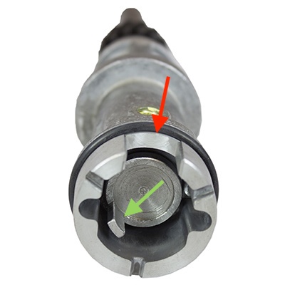

For the synchronizer, the alignment check must be at TDC during fuel/air compression. After you unscrew and remove the plastic camshaft sensor, the outer metal housing has an opening that fits the removed sensor. The inside arm/peg should be at the middle of the outer opening. If it is not aligned, loosing the fastening bolt and rotate the outer housing to align with the inside arm. Ignore the fastening bolt and the angle where the outside housing (i.e. the sensor) ends up.
Found a clean photo of the synchronizer. The red arrow points to the outside housing opening, which can rotate to align. The green arrow points to the inside arm. Again, ignore where the outside housing ends up, as long as it's pointing at the firewall to make plugging in the sensor wire easy. If the inside arm is way off like this photo at TDC, then you can remove the hold down bolt, withdraw the synchronized, move the inside arm to roughly align with the outside opening, reinsert the synchronized so the inside arm is pointing at the firewall direction. The inside arm will move a bit when the gear engages the camshaft. Don't worry. Just rotate the outside housing left/right until the inside arm is at the center of the outside opening. Finally tighten the hold down bolt and install the sensor.
Should the inside peg be pointing basically at the passenger seat or kinda inline with the hold down bolt

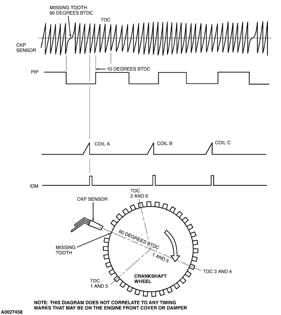

Note: I made corrections to this reply on 12/17/2021. I inserted a pencil into cylinder 1 spark plug hole to measure how far up the piston was. It proved that my 2002 3.0 TDC is when the 5th tooth aligns with the aluminum arrow while the 6th tooth (and TDC letters) is directly under the crank sensor.
Ok so let be clear. The TDC mark needs to be lined up with the timing tab.. NOT THE ZERO line up with the timing tab.
That will be off by one tooth, but the PCM seems to tolerate it. The timing tab/arrow is a part of the cast aluminum front cover to the right of the sensor.
My 6th tooth is directly under the crank sensor and the 0 is in line with the timing tab.
That is spot on. Again, ignore the numbers 0|||10|||20|||30|||... Find the 3 letter "TDC" and that should align with the crank sensor. To be exact, my TDC letters align with the right edge of the 6th tooth -- like the raising edge of a wave form diagram, not exactly the center of the tooth.
Here is one more official diagram from Ford manual, marking the 6th tooth as the TDC (prompted me to recheck and corrected my alignment few days ago):
No, ignore the hold down bolt. Align with the middle of the outside housing cut-out pointed by that red arrow in the above photo.
Ok I did all that and set it the way you instructed. The inside peg was on the firewall side, but a tad off center, so I lined everything up. I also replaced the downstream o2 sensor. These are the reading I now have.
