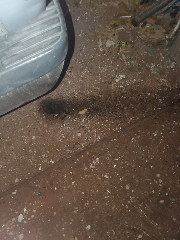

NOW I kinda back to where I originally was, rough idle, gas odor, misfire.... makes me feel like everything I've done was for nothing. No vacuum leaks, good spark, little hard to start, won't key bump start is what I mean here, black sut on the ground at tailpipe, possibly from running rich, also a cream colored substance on the inside of the oil cap. NOT IN THE FILL NECK though, don't look fresh so might be from previous or from me maybe getting some coolant in the oil. I need to change the oil, and put the new plugs in, and I'm thinking either clean (AGAIN) or buy a new MAF. I don't think it should read 27 baro at idle...
