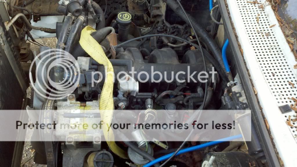

Arrg... repinning the harness. I need the other end of the 4.0 harness clip and pin it to the old 3.0 wires. Also theyres a smaller harness. Lastly I'll need a driver side 4.0 engine mount, and a new AC condencer, just casue I mashed the old one during the swap.
Yet my last chalenge and prob wont difficult. The Explorer 4.0 has 2 fuel lines running off the motor.......annnddd the Ranger only has 1 coming from the fuel tank. -_- sooo close yet so far from turning the key after 2 years of being in my driveway.
ugg. AC condenser and radiator are finally in...it actually looks like its meant to be. I still need to figure out the 2 fuel line setup. was wondering if maybe there was a 'T' fitting I can buy to run them into the original single line, but I'm wondering if that will cause an uneven flow and the fuel not being consistant enough to each side of the motor....any ideas?
