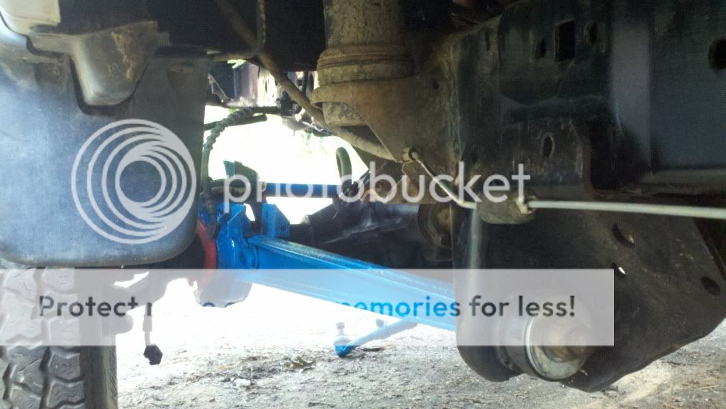

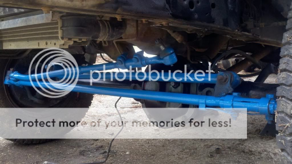

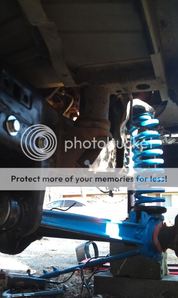

Blah--- I got 4" lift coils out of a 78 Bronco.. 7* radius arm bushings... all painted and ready to be installed.... but.. I hit a minor setback today -_- the tranny crossmember runs under the fram exactly where the radius arm attaches to the frame...I think I can take a bit out but I'll def need to re-embrace it later...
BLAHH... almost there..basically done grinding...just need to drill out the holes to mount the arms...

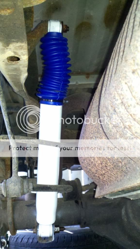

Did the shocks on the rear today...they should match the Pro-comps im gunna run up front.

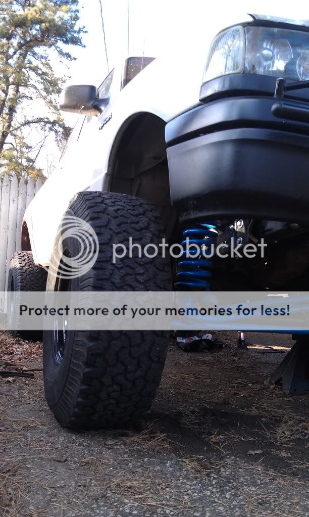

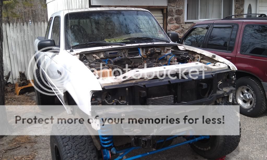

Passenger side basically done.... Using the D44 out of a 78 Bronco, I actually had to move the coil seats in more towards the frame.... it was causing way too much bow in the coil. But here it is now...just need a shock and connect the brake lines.
So SAS basically complete and sittin on 35s. Just need to touch up a few things: pick out some shocks, attatch the yota ifs steering box and call it a day. this project was worth the wait... I'm still having motor troubles so I cant test the SAS yet..but soon!

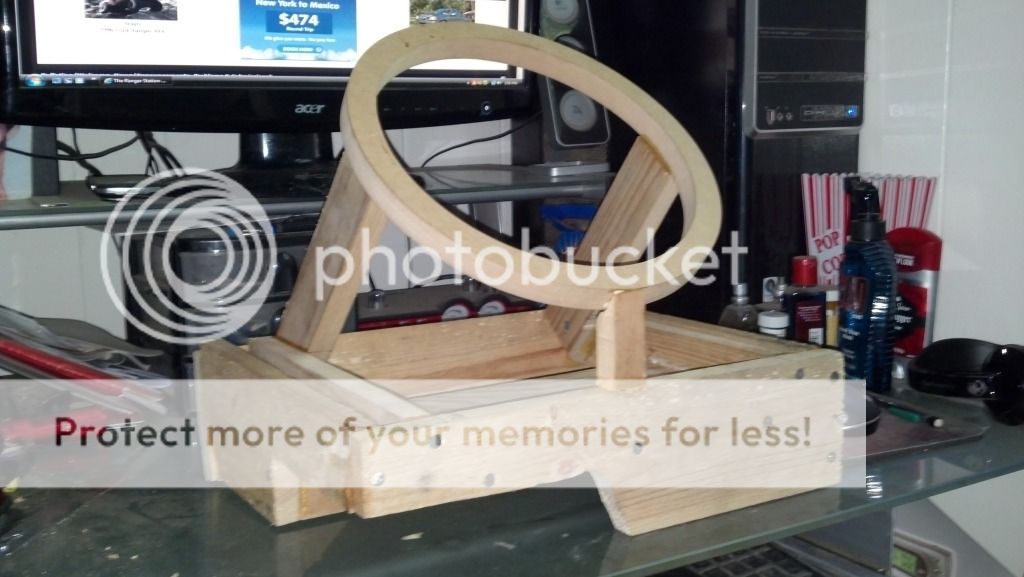

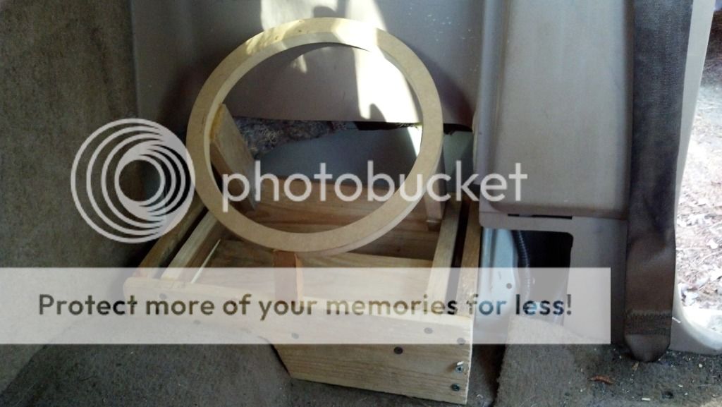

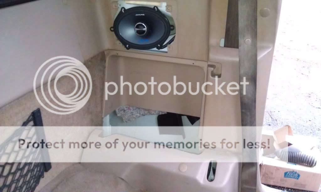

Figured I'd start the next project....Biulding a 10" Sub unit
I'm going to biuld in the section for the jump seat used to be, since it's not even really comfertable for 2 people back there, so 1 seat will be fine
[/QUOTE]
Okay So I mentioned I started the idea of a sub...Well its cold outside so I went back to working inside and heres where we're at.
I took out one of the jump seats since its not too comfy having to people in the back of a Ranger anyways. And as far as I know, I havn't seen anyone utilize this area like this yet, I could be wrong.
The skeleton was not planned or calculated or anything like I know intense sub people do...this is simply my first shot at it and its ben more fun than I thought. I still have 2 more pieces to attatch to prevent air leaks.
And here is how itll look. I will be doing my first attempt at fiberglassing as well with this project. Will wrap this up with some kind of stretchy wool to get my shape first. But first, I'll need to seal up all the seems (woods joints,screws,etc.) with some kind of good sealant.
Once fiberglassed, I plan to paint the top white to match my dash and wrap the base in matching carpet of the Ranger. Again, I've never done this before, I may be designing it like shit but its definatley fun.
