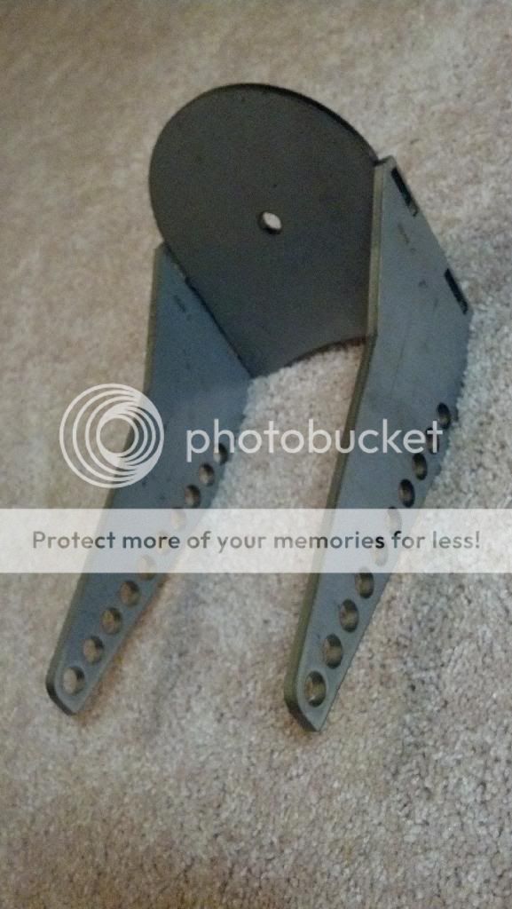

So these showed up today. Thanks to the creators at Ballisticfabrication.com

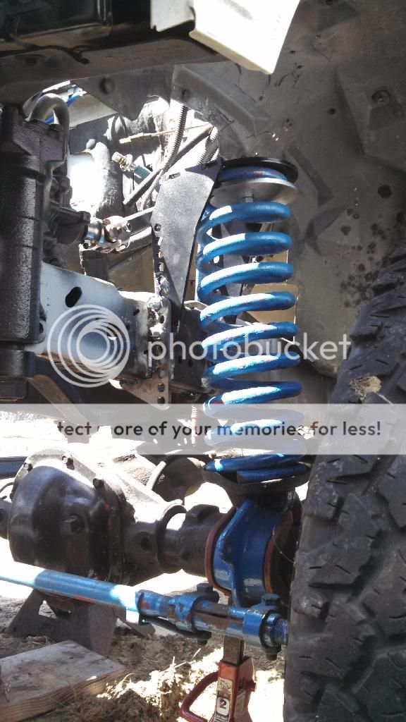

Here it stands 4" Bronco coils ballistics adjustable buckets.

i like the coil buckets,they just seem like they could use some stiffining up.open back looks a lil sketchy in the strength department.im gona get the same ones and add plate and gusset for strength. nice job man.truck and color look real good!
Def agree. I'm going to lower them and weld in a cross plate on the back. It is 1/4" but I'd feel a little better about knowing extra strength is there.
good to hear,glad i didnt get any flack for downing ballistic parts. the added piece of mind is enough for me even if it doesnt need it,i feel better knowing its there.

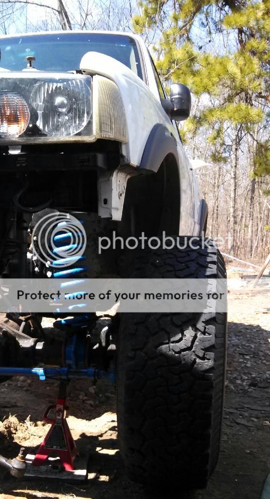

Heres truck standing. Think Im at about 9" of lift and adjustable buckets still have 5" left for me but current hieght is nice.
