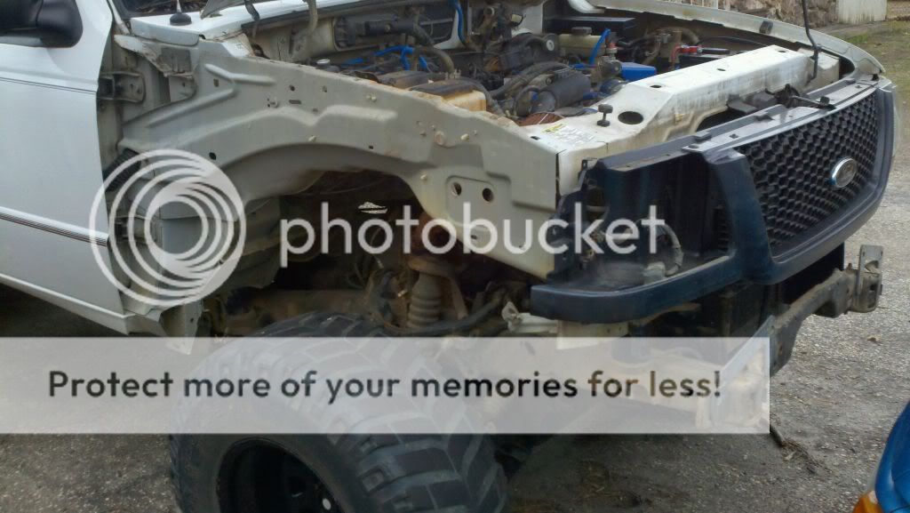

it's a good looking truck bro, if you don't mind me asking, where did you find the grille? been looking for one like that for my 06, but cannot seem to find one, just don't really care for the body color bar-type grille, ya know?
this particular grill is a 03 Ranger EDGE....but for a 06, your best bet is to look for the 04-05 EDGE grill, ...and for something like a grill, your best and cheapest bet is ebay!

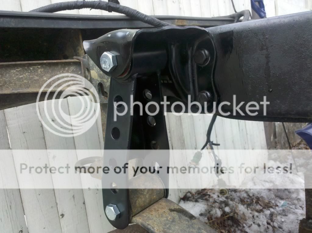

SHACKLE LIFT!!! Taking a break from the front end for few days... Nwo when the front is in, I'll have to block it and add leafs to give it a leveled look, cause I dont like the 'racked' look.
Aprox--30 minute install on each side
must be nice to work on the shackles without the body in the way. nice build

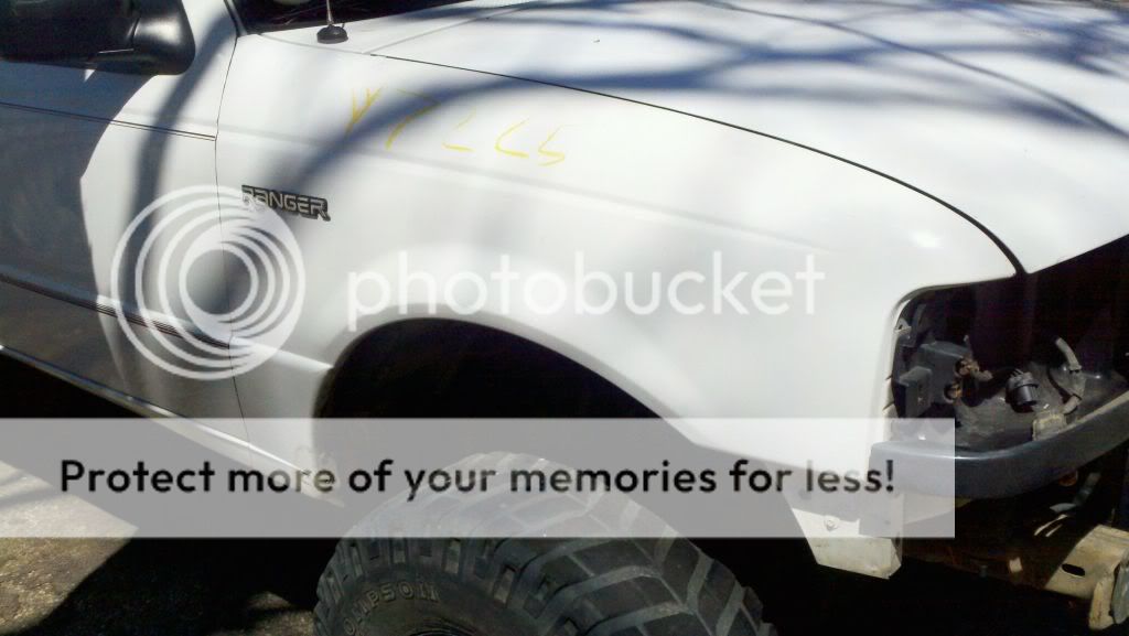

replacing the dented fender...but though this looked kinda cool for some wierd reason..
New fender wont have pin stripes...so i'll prob be taking em off the whole truck..
And the new .... looks like ima be taking the pin stripes off the rest of the truck

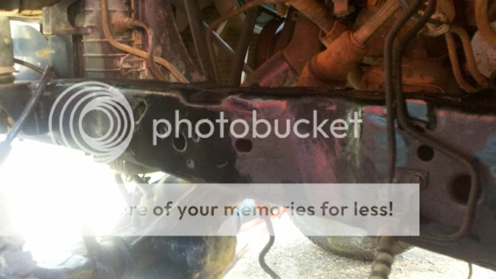

Got the old suspension and axle out... and today I spend a bit cutting out the old parts...leaving the bar frame. No shock tower, control arm mounts or bump stop.
I going to sand down that paint...just layerd it so rust dont begin*
