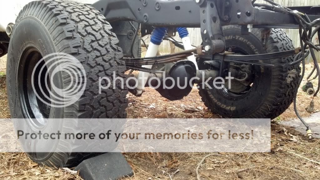

Running a angled cross member inside the very tail of the frame to give the tow hook some strength and keep the frame from bending when pulling someone. Its been done before **scott5640

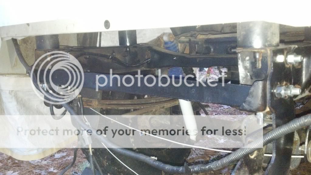

Finally got my cross member in the rear tip of the frame. Only problem is now I need a new brace the sits at a 45* from the bottom of the tow hook to the bottom of my angle iron. I'll get something together, but either way, it's alot more stable then the p.o.s. tire carrier.

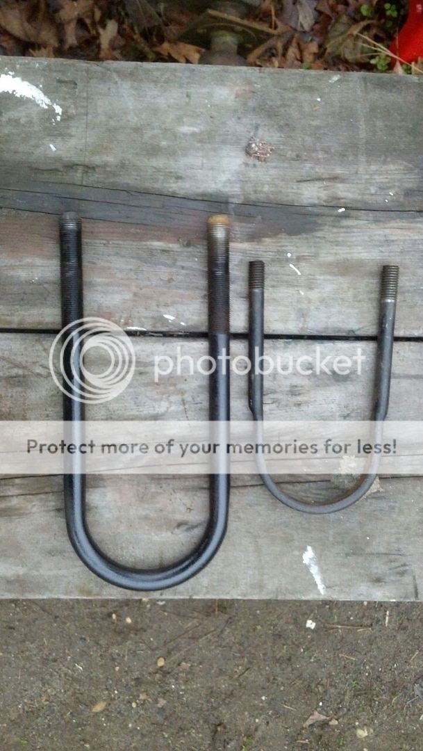

Also I should have mention this on page during my axle swap for the 8.8 31 spline Xploder. I had this U bolts custom made and good thing, because I've added 2 leafs to each side since (1 Xploder leaf/1 leaf out of a E150). But I had to pull them and clean them up. As I do the whole rear end. It's looking aged.
Here they are versus stock rear U bolts. They are 9/16 thick and 10" long.

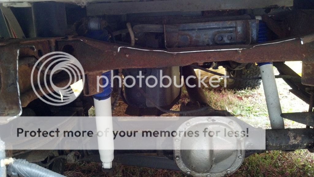

Heres how a rear should look
Hehe...wish I had a little more meat left in my main leaf. The only thing giving them a curve is the Xploder leafs.

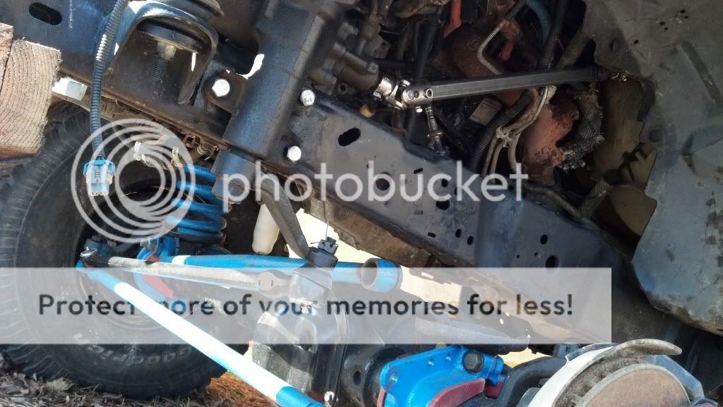

And heres how a front end should look....almost lol :icon_confused:
Want to find a shorter trac bar to mount inside the frame. Going to need a wierd one just to keep it same angle has steering link. Ohh...and doing my own buckets and towers. Didn't like the late model Bronco ones. I recommend anyone about to install their yota box, maybe put a slight tilt on how its mounted. Mine is level and the u-joint looks tight.
