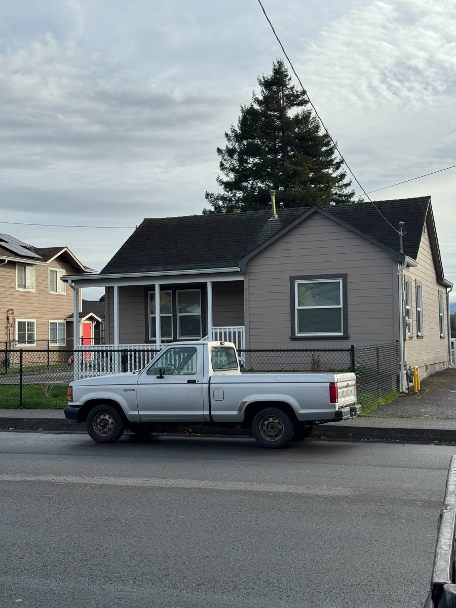

Hello everybody,
I’ve been kicking around the idea of swapping a 5.0 from an Explorer into my 1990 2WD 2.3L 5-speed Ranger 178k miles. I’ve done a decent amount of research, but I still feel unclear on a few things and would love insight from people who’ve actually done this swap. I would like to keep this project on a budget, im not going for a showroom build. Im just doing this for fun and i got the ranger for $800 bucks.
The donor I’m looking at is a 1998 AWD 5.0 Explorer with 168k miles for $1,000. I plan to run an M5OD-R2 behind it and have a few options on Marketplace I haven’t picked up yet.
What I’m trying to wrap my head around is mounting everything in the engine bay. I recently welded in motor mount brackets successfully on another project, so I’m comfortable going that route. I just wish there were a clear write-up from someone who has done this swap into a first-gen facelift 2.3 RWD truck.
Current plan:
  1. Obtain donor
  2. Order swap kit (recommendations welcome)
  3. Obtain M5OD-R2 and clutch kit
  4. Get correct flywheel and starter
  5. Decide on headers vs. using Explorer manifolds
  6. Pull drivetrain from donor
  7. Clean and reseal the 5.0
  8. Mate transmission
  9. Dry fit and mount engine
  10. firewall clearance
  11. Modify trans tunnel and carpet for the R2. I believe the shifter sits a few inches forward compared to stock.
  12. Figure out transmission crossmember and hopefully avoid major modification
  13. Sort out fuel system. The 1998 Explorer is return-style, so that will need to be addressed.
  14. Convert Explorer harness to standalone
  15. Decide on ECU solution. Manual ECU? PATS delete? Open to suggestions.
  16. Figure out radiator setup. I’ve read the Explorer radiator can work with modification.
  17. Rig has manual steering box so I don’t have to deal with power steering or A/C.
  18. Plan belt routing
  19. Decide between electric fans or belt-driven
  20. Build exhaust. I may skip cats but will definitely run good mufflers.
Then hopefully drive into the sunset.
Any advice, corrections, or things I’m overlooking would be appreciated.
