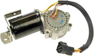

I have one. I used it when I bought a 2000 Ford Ranger 4x4 that was stuck in 4LO. I negotiated the price and then pulled the shift motor, installed the shiftster, and drove it home. That was about 10-years ago.
The only real issue I had was that the factory bolts were too long for the Shiftster (photo above). You can see in the photo below how tall (thick) the base is that the factory bolts go through to hold the motor. That's something that you need to account for. You don't want the thing disengaging from the selector while you're driving down the road.
