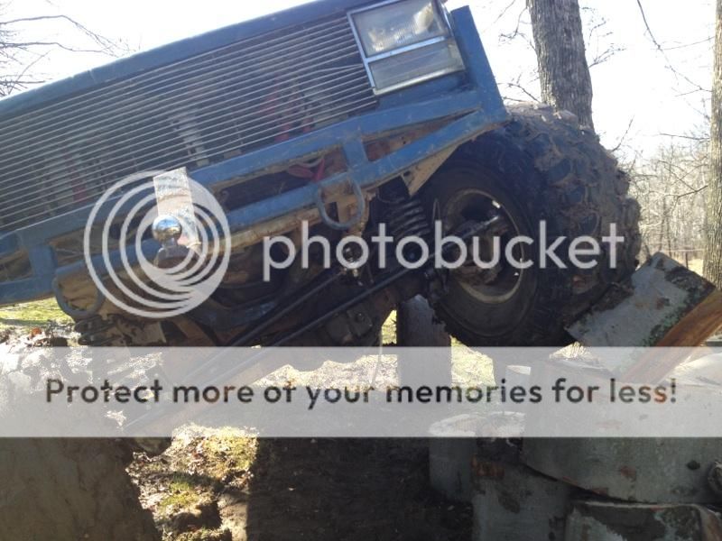

The new arms are in and I made new shock mounts so I can keep the old shocks (factory Superduty ones) I took the springs and shocks back out to see if there was any binding which would keep me from tucking the tire like I want. There is no binding :) . It tucks no problem with out springs. Which is good. Going to see how the new setup works next weekend. The bushings might just need to be broken in a bit. Hopefully she will tuck the tires a little better. If not, I will be on the hunt for softer springs. Maybe 160-175 ppis. I am currently running 190 ppi springs.
I'm sure when you start twisting the truck (like PlumCrazy and my avatar) you will see them tuck front and back. Did you modify the coil bucket so the spring will unload?
Not yet. Going to see how it works as is first.
This is playing around at my house yesterday. The springs definately compress. Just not as soon as I would like. But I am happy with how its working, just didnt meet my dreams lol. Its a simple Ranger, not a $30,000-40,000 Jeep :headbang: Like you and Plum said, once I twist it, it should end up like yours.
