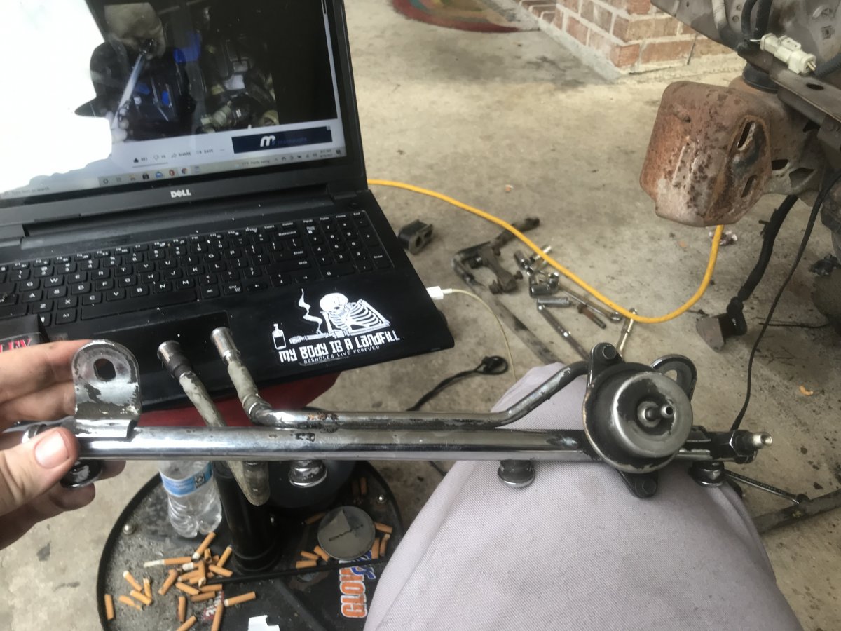

I'm needing to know which line is feed and which line is return. (1997 Mazda B2300/Ford Ranger 2.3L) Also I would like for a pitch in of ideas for converting these to AN fittings. As well as how to remove the fuel pressure regulator (I have an aftermarket one).

The round cylinder with Vacuum port is the Fuel Pressure Regulator(FPR)
The Return line is from FPR
IN line from pump and filter, goes directly to fuel rail
