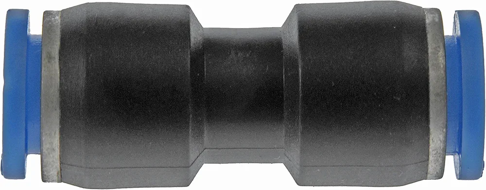

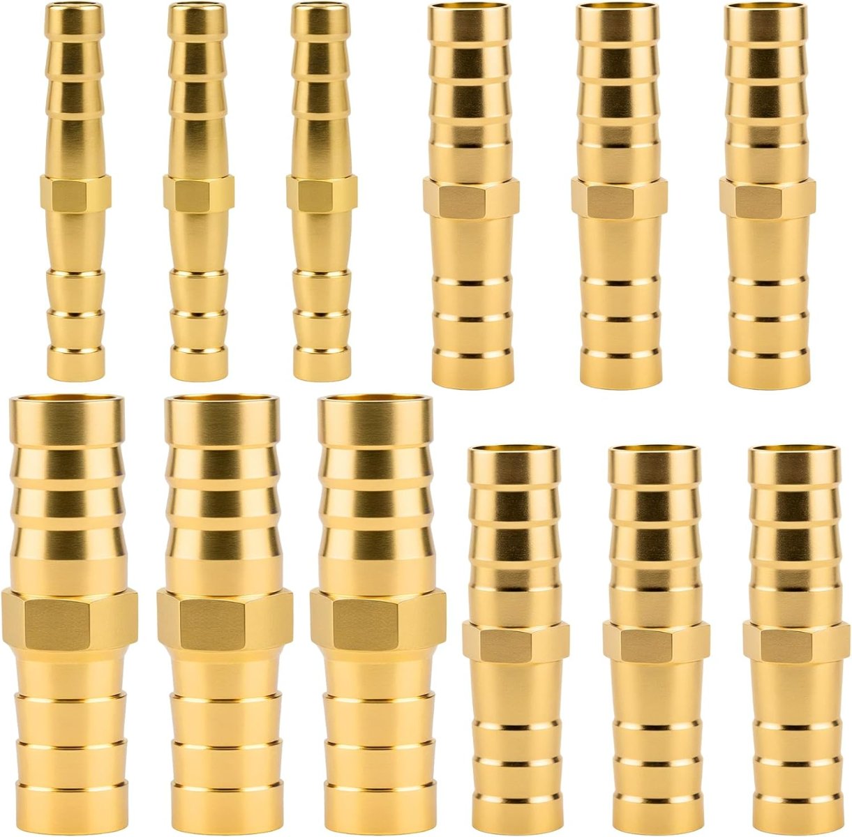

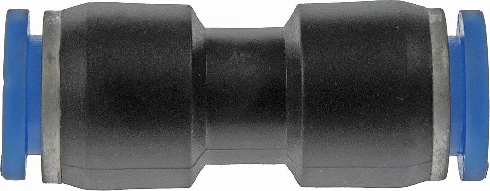

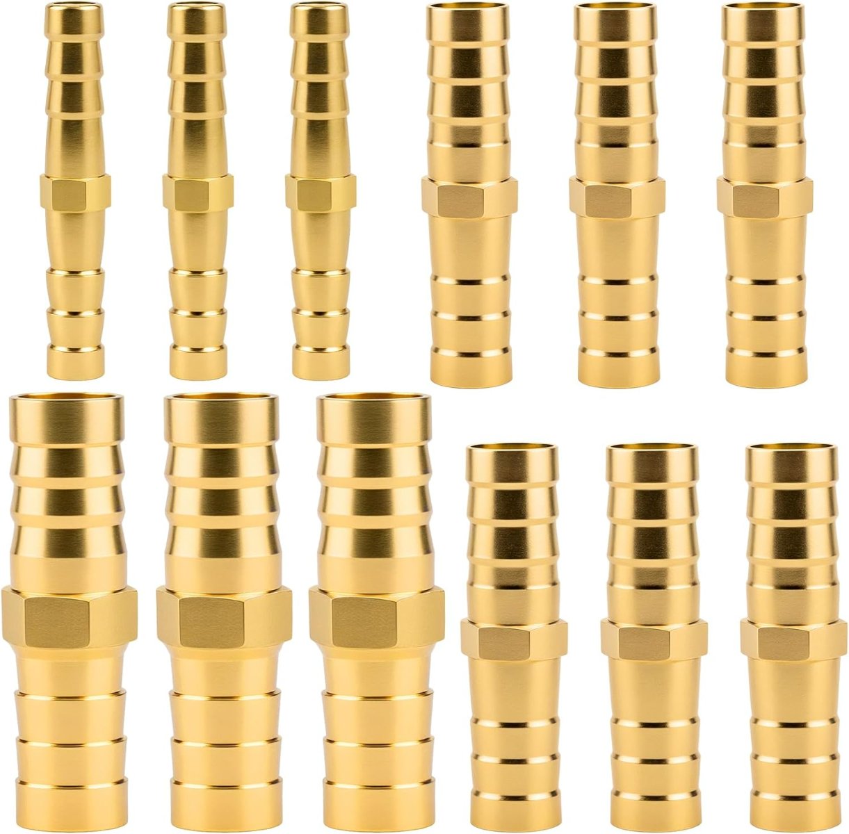

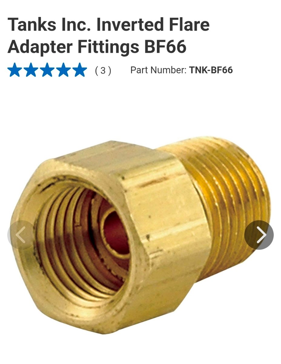

Would I be able to use these brass barbed couplers or should I use these Dorman fuel line unions in the bottom photo?
We'll know better once you get the elbow off. My thought is this. It looks like there is an adapter fitting between the elbow and the fuel rail. If so, it is probably normal pipe threads in the regulator. So, a straight adapter with male pipe threads on one end and the -6AN threads on the other end will let you attach that -6AN elbow. Or there may be a better adapter for that.

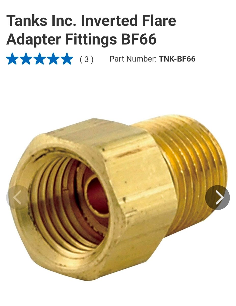

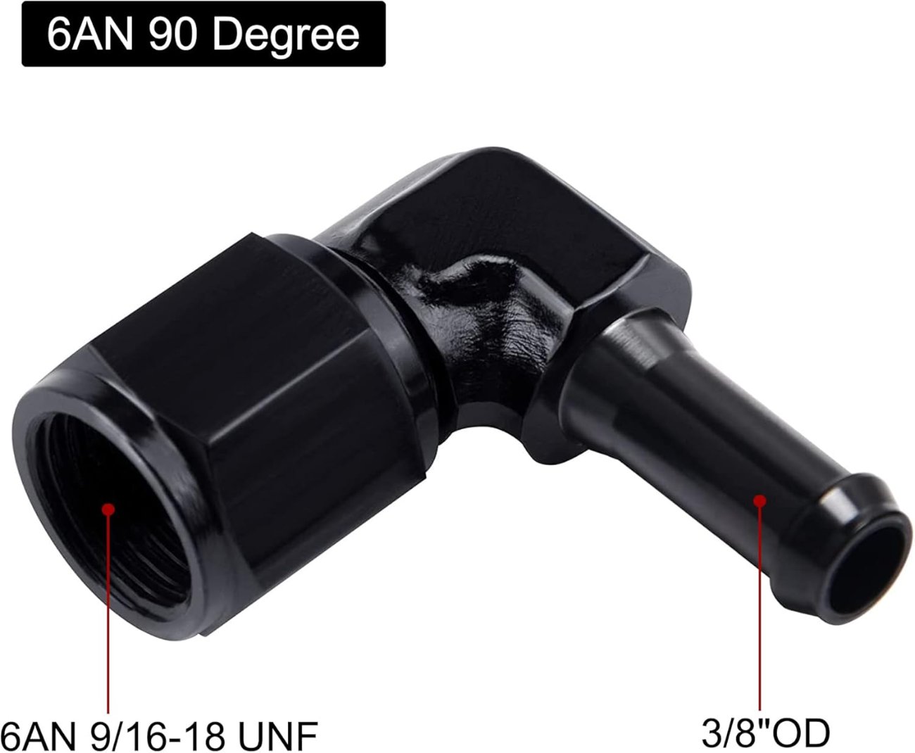

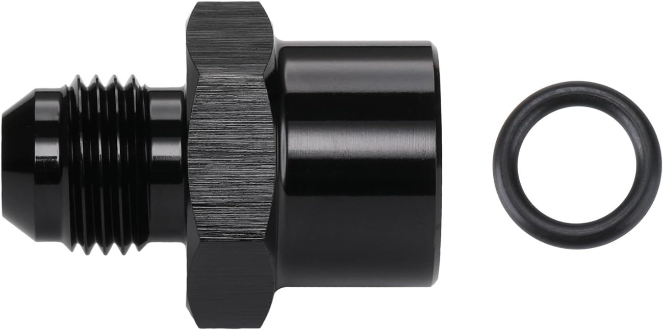

Yes I agree, I'll evaluate the fitting when I remove it. I believe there's threads on that regulator fitting..So I would need a female fitting, no? Something like this in the photos below. If so would I be able to connect an PTFI line to that nipple coming off that female fitting? The website isn't specific about fuel pressure capabilities, so it's confusing if I can use this for a 60psi fuel line. I guess I could call them.
Link for that fitting from the evil energy website.
AN to Barb Fittings​
The Ultimate AN to Barb Adapter Solutions for Leak-Free Plumbing​

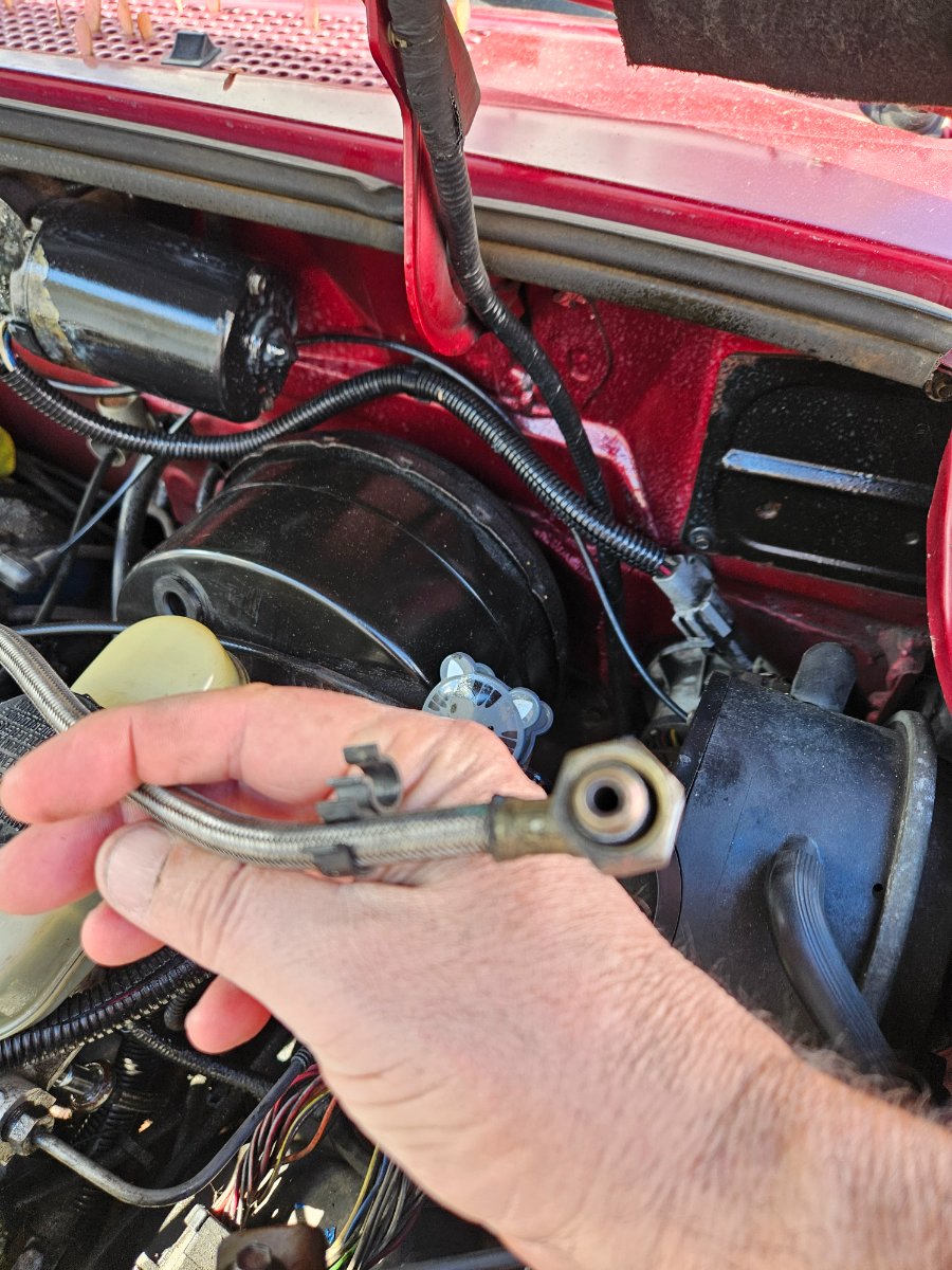

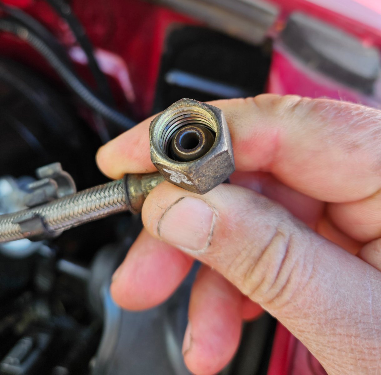

And Also,,,, If I cut the PTFE line a few inches away from that elbow, I'm sure I can piece in another line. Your thoughts?
It’s been awhile since I’ve had one apart, but from what I remember standard fittings don’t work. They’re a weird fitting. Why Ford chose to do that is beyond me. Some knucklehead engineer should be hung by his underwear from a lamp post for that.
Isn't the engine German? So the threads may very well be metric,.ill know later today.
I believe it's an inverted flare fitting that stems off the fuel regulator 1/2" -20 in what I'm reading. I'll know today probably. .

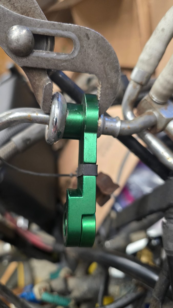

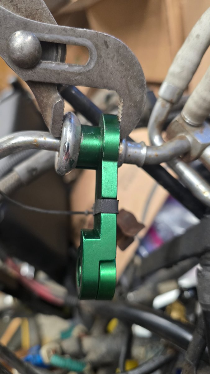

Ok so I removed that threaded fitting off the fuel regulator, and it was quite easy, that's completed (a photo of fitting I removed below). The hardest part right now is disconnecting it from the stubborn AC/Fuel line disconnect fitting, I was using the plastic disconnect set..
I have been soaking that fitting with PB Blaster and WD 40, and the danged thing still won't budge. I may make a home made thin piece of sturdy moldable metal in which I can wrap around the fuel line pushing it in to release it, video below.
I tried numerous times today using that plastic AC/fuel line disconnect set, but I'm getting nowhere fast. I'm actually not too worried, I know it will eventually disconnect.

Patience, you'll get it. I was going to suggest soda can material.. even though I know it's too thin. Sometimes the removal tools are too thick or too blunt. You may be able to sand a bevel on the leading edge of the tool to allow it to slip in under the locking spring easier. I have also used pliers to force the tool in.
Front Fuel Leak 1993 Ranger 4.0 XLT Auto
That tool looks like a good quality tool. I know I'll get it off. I'm not too worried. I also tried it with the pliers trick, but it's so hard to get my hands in there. I'll keep at it, no doubt.

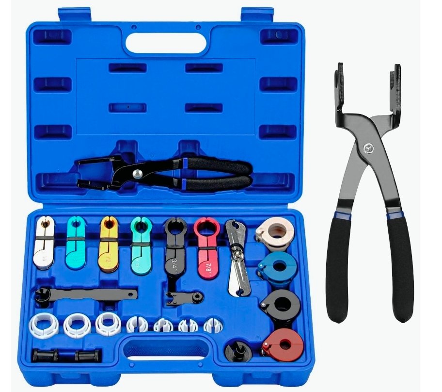

@Curious Hound I just purchased this set below and I will be returning the other plastic set and also the metal tool which I had purchased separately.
This set comes with a special pliers also too squeeze down the disconnect device to release it, it looks way easier i think, if that's what it's for.
