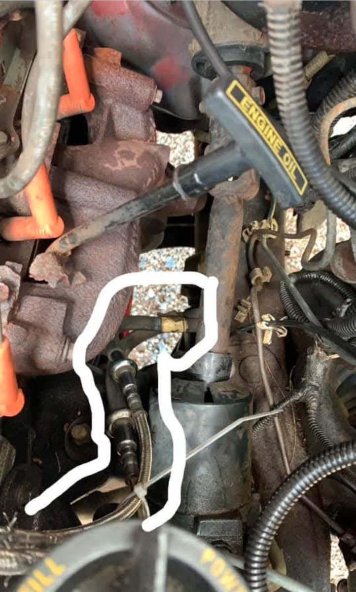

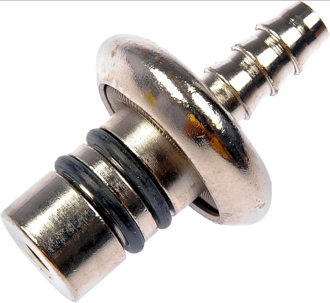

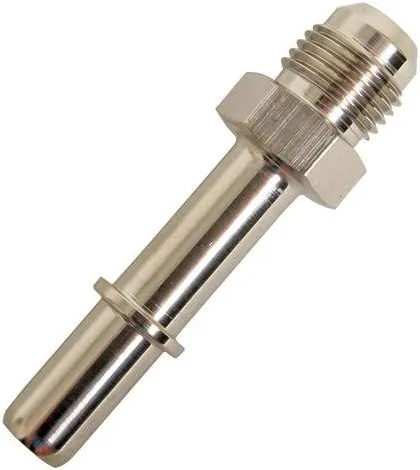

I think I'll need this type of fitting shown in the top photo, to hook into the original Ford existing quick spring connect fuel line from the new AN hose fitting on the other end, this connection line is located by the inner fender wall area under the hood in the last photo. Hopefully this just might very well be the final piece of the puzzle.
I'm searching the Internet for this- "Ford Spring Lock Female to 6AN Male adapter"
The Existing Ford Quick Disconnect Fuel Line. The opposite end is connected to the new AN fitting on the fuel pressure regulator by the fuel rail.

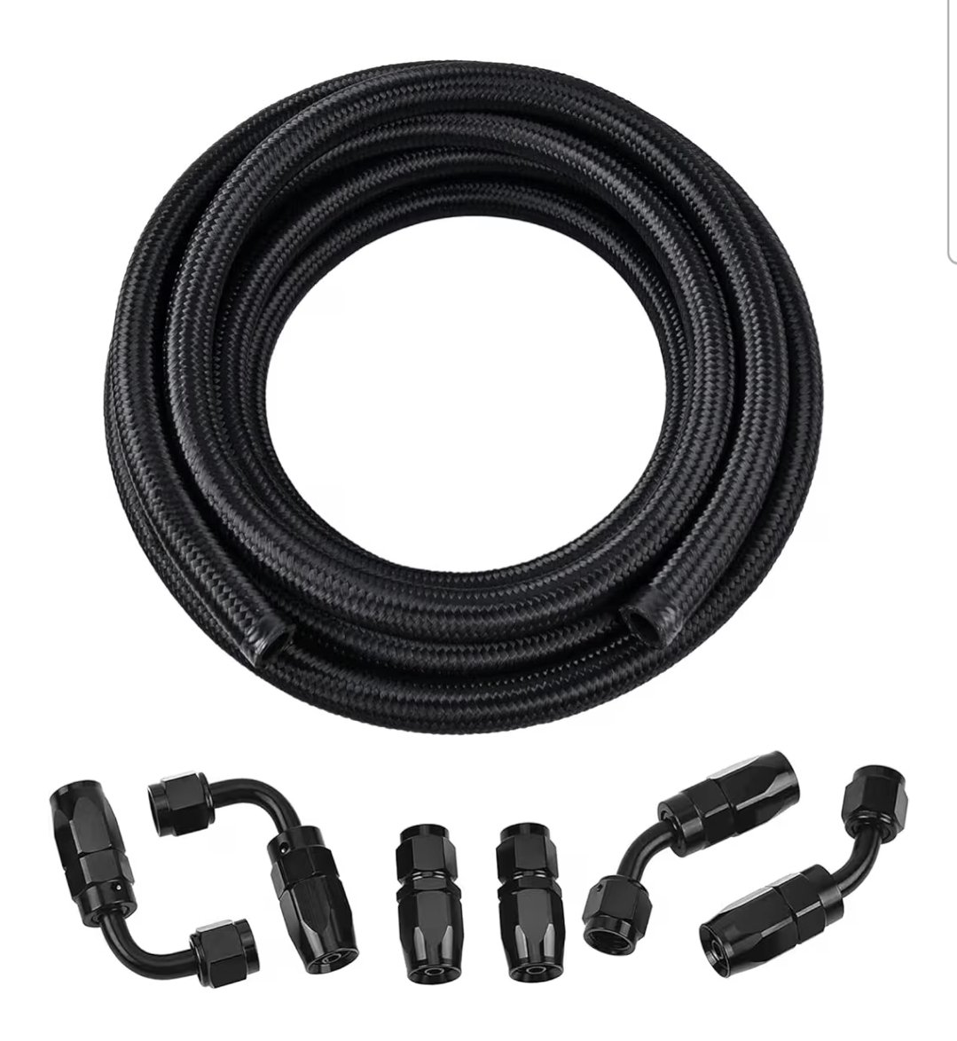

Im gonna go with the AN kit bottom pic -
https://a.co/d/098NETW0 I'm think im gonna have to return the Dorman kit now, I may hold onto to the Dorman kit to get some ideas

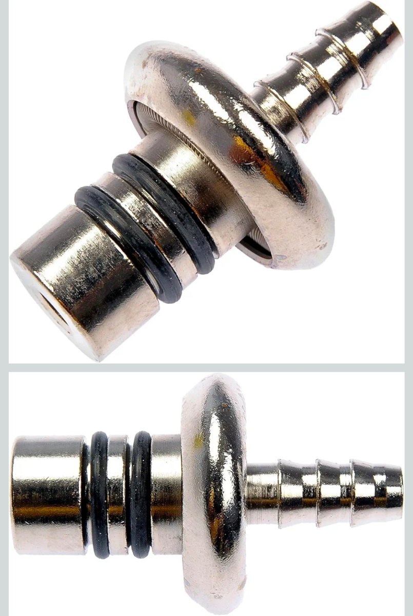

I'm wondering how to join the other end of the AN line to the stock ford fuel spring disconnect fitting below. Anyone have any idea? I'm sure I'll figure it out. But it's good to get some ideas from you guys.

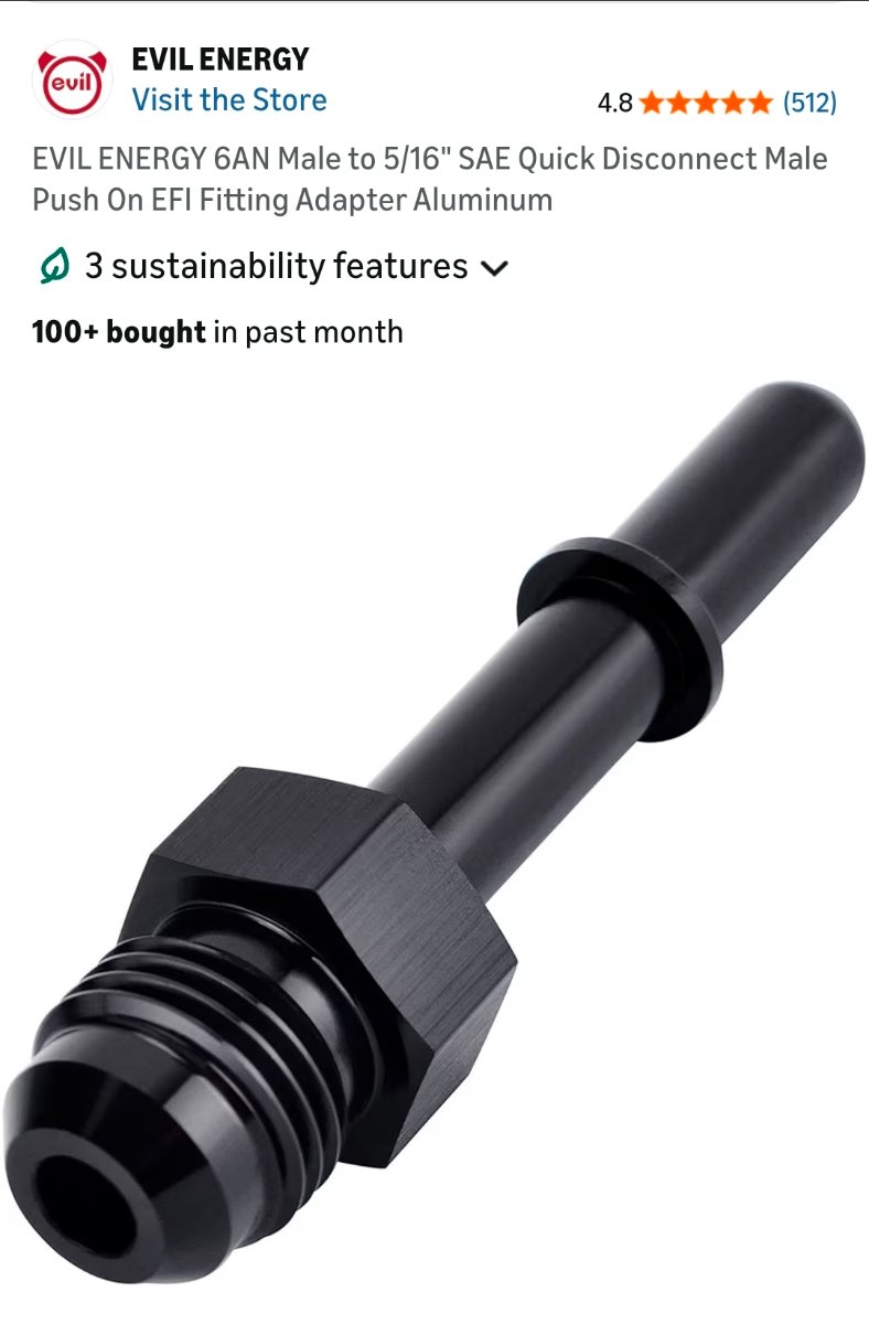

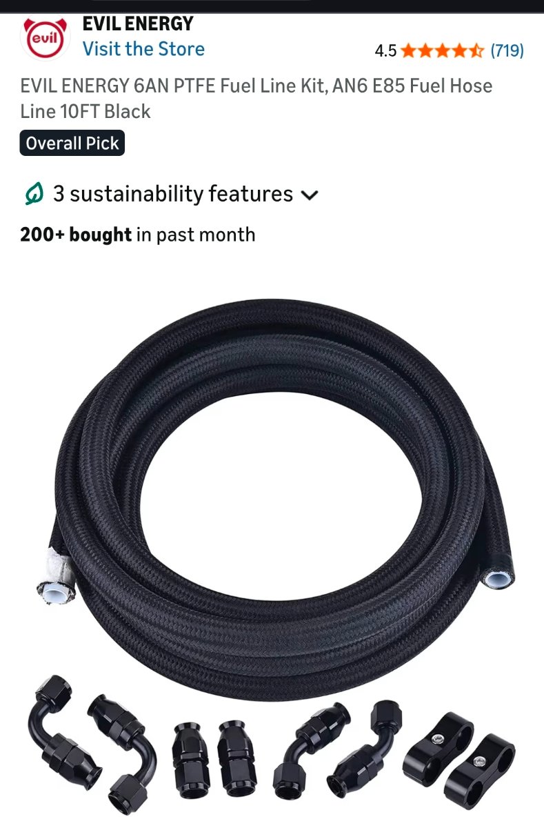

@lil_Blue_Ford Hey man thanks for that critical info on the fuel line. I just purchased PTFE. Good call and looking out. Who needs to do this shit all over again. One and Done I bought this 5/16 kit by evil energy on Amazon $50. The company has good reviews.
The Dorman Kit, I'm not sure how this would interface with the AN fittings now. As it probably won't.

@lil_Blue_Ford @Curious Hound Summit doesn't have the full kits, and purchasing seperate line and the connections are quite pricey. I decided to go with the AN PTFE Kit by Evil Energy. Seems to have good reviews. I'll know when I get it and start making up the lines and connections. That's my last step. Thanks again for all your input.

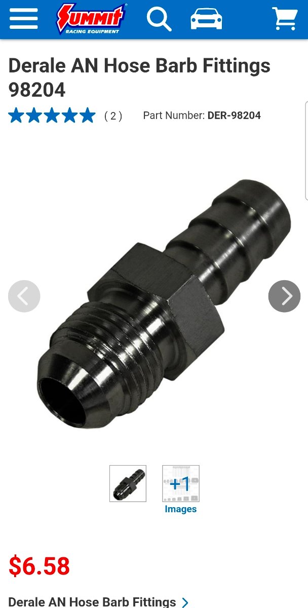

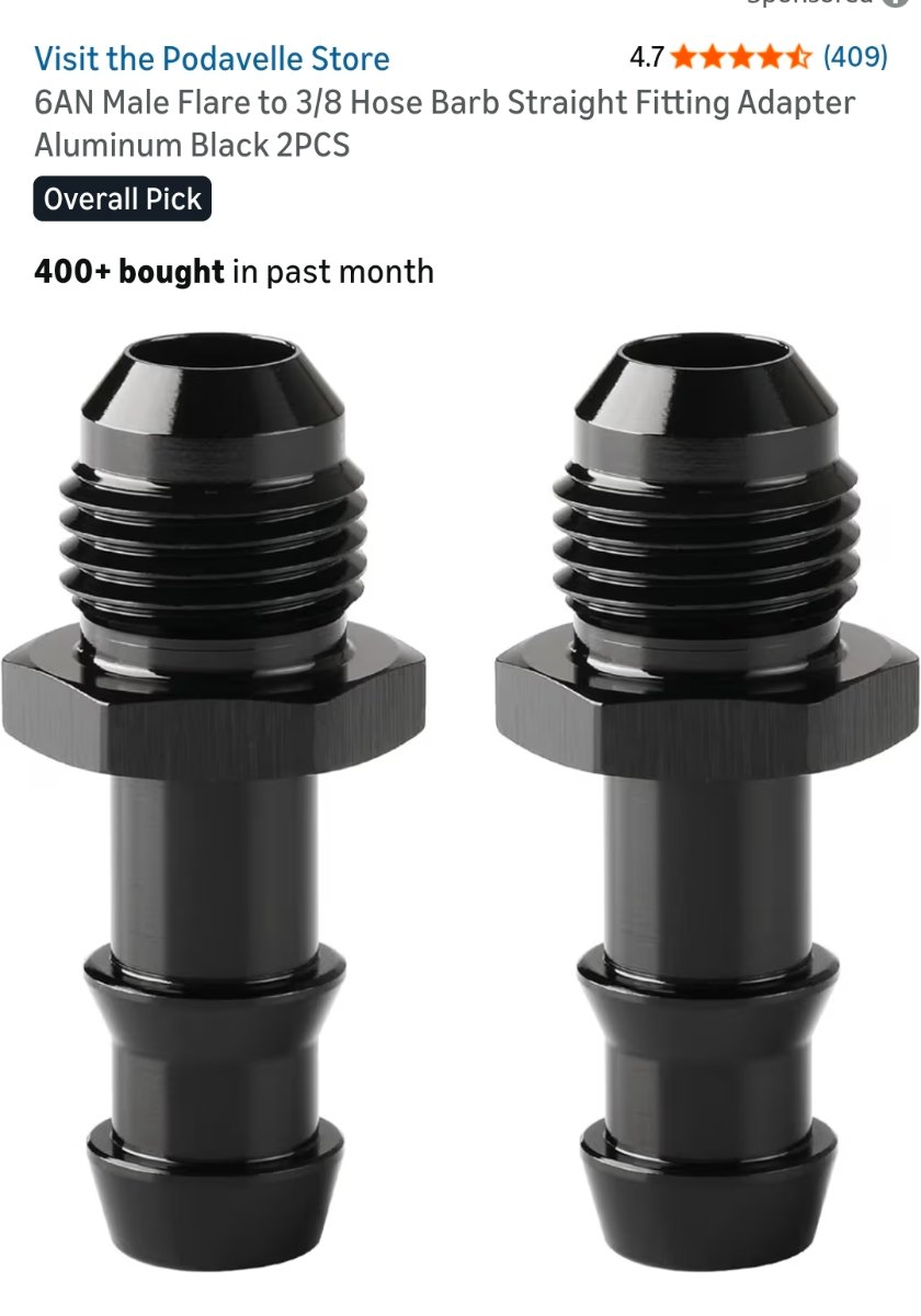

Question- Do you think these fittings or (coupler) would interface into the other end of the fuel line that I'm disconnecting from the stock spring lock connector. One end is 6an and the other end into the existing line? I'm trying to find the final piece that I need to make the full completed fuel line. I guess it would be better if it were barbed like the original in bottom photo.
New coupler fitting with AN connection.

Original Disconnect Fitting, notice the barbed end. Different from the top photo.
Or these.

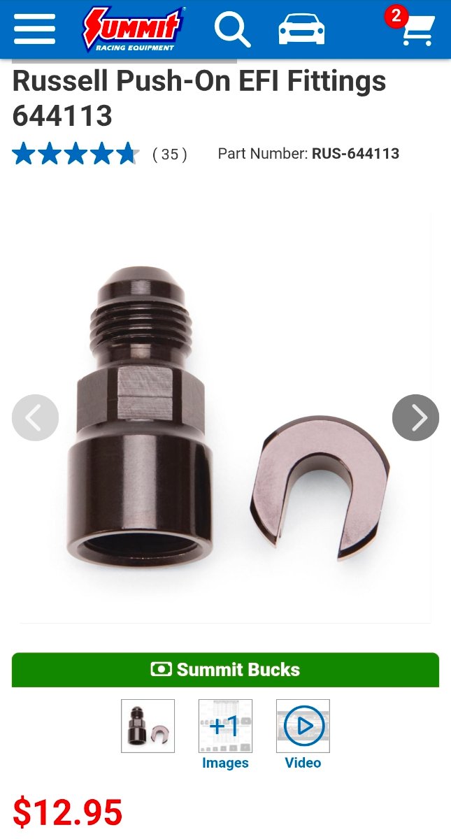

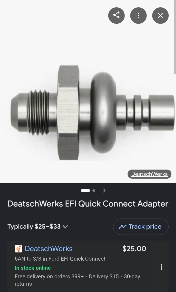

I just spoke with a sales rep from Summit. Here's the part I need. This adapts to the original quick disconnect line. I'm not sure if I need 5/16 or 3/8 I'm assuming 5/16 because it's a supply line.
