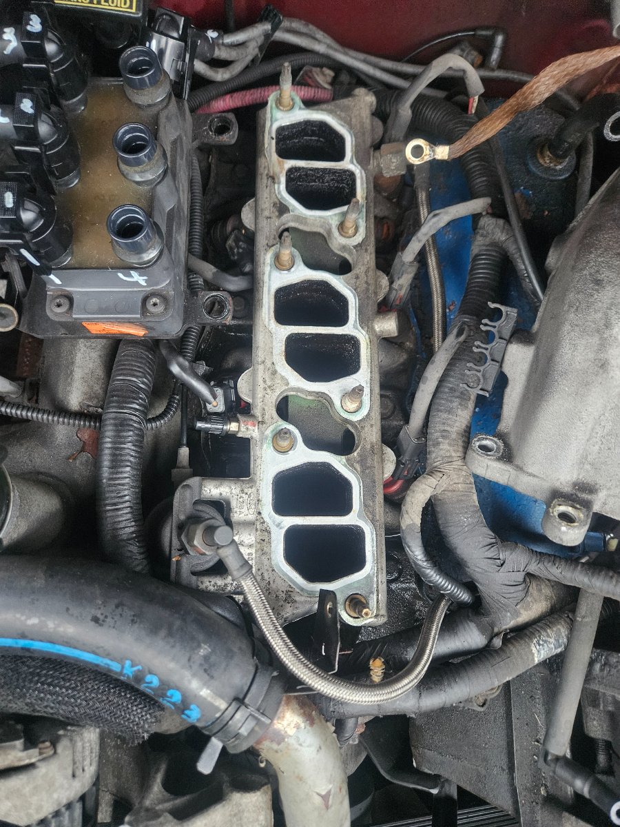

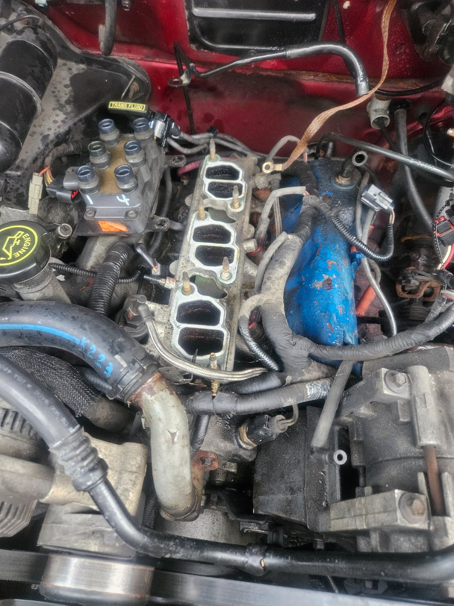

What kind of fittings are they? Could you find a shop that makes Hydraulic lines to make you a new one? I'm not sure how that works...
This is one of my questions.
I hate to beat this to death, in what I am currently reading with a Google search and Ai. The high pressure line under the hood area more than likely needs to be replaced as this line is usually the culprit, and it seems like it is. Dorman has a kit that has the female fuel rail connector on it that's factory, the other end doesn't have any connection that I have to make up myself with a fitting. Does this sound correct @Curious Hound ?
