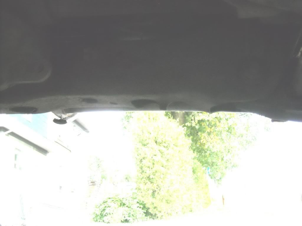

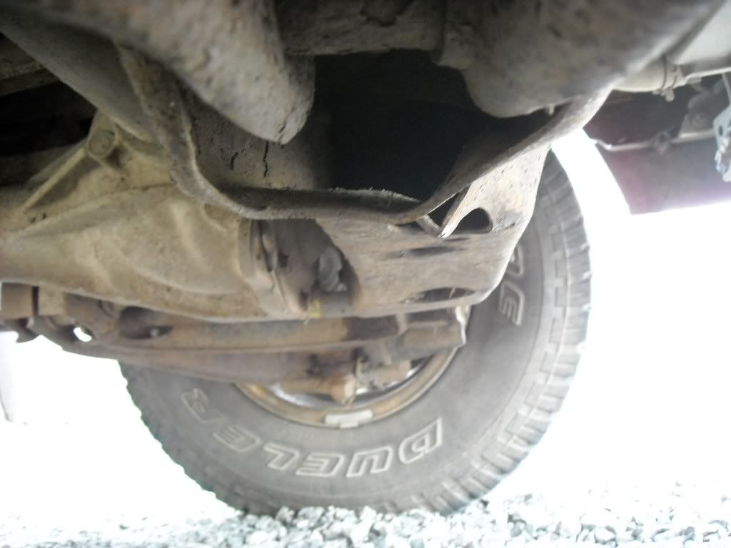

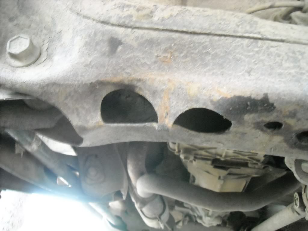

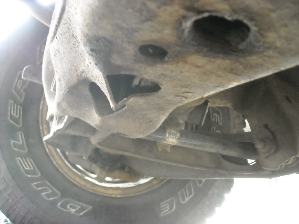

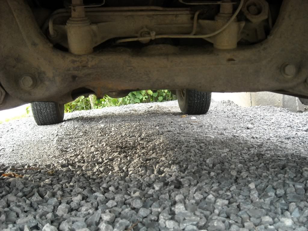

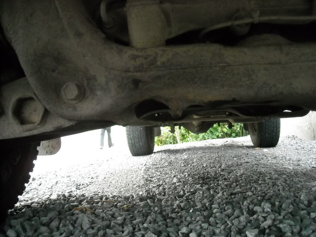

Hello,
I have a B4000 1999 and Yesterday i hit when offroading a stone right on the front crossmember...
The truck feel perfect, the alignment "seem" to be good and i got no vibration at all.
I am wondering if i should get the alignment check, or see a frame shop if the can fix it, or i need to replace it, or if am lucky just let this like it is and don't put money on that!! lol

any advice or suggestion on what should i do :icon_confused:
Get the alignment checked, if no issues call it a day.
Any good body shop with a frame machine should be able to straighten that out easily.
Josh
i try several frame specialist and they all have to remove the crossmember before they can straighten it and it tooks about a day or more to do the job so......:thefinger:
anyway got the alignment done today due to tie rod and both upper and lower ball joints replacement and no problem at all at lease no adjustment where needed :icon_thumby:
It looks like a job for a BFH. I wouldn't worry about it if I were you. I'd just knock that sharp bit back flat and drive it like I stole it.
