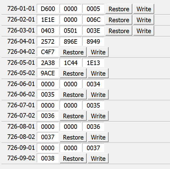

solraven's link where a FORScan expert says tire size settings on an older truck are "likely in the PCM VIN ID block", coupled with comparing Broosedamoose and t3chno1d's AS-BUILT data, seem to indicate tire size isn't adjustable in the GEM.
Broosedamoose's truck is already larger-tire-size-corrected, so we should see the difference if that's where it lives. Only the -04- and -05- blocks are notably different, only the first two fields in Broosedamoose's -04- show relatively larger numbers, and the values in those bytes don't look like they have anything to do with tire size, circumference, revs/mile, etc.
Although, maybe I'm just not interpreting it right.

The last man issue I ran into is the Speedo. Seems that the ratio can not be offset through the GEM, ect, must be done in the pcm.
