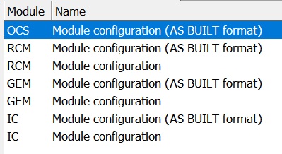

List of modules present:

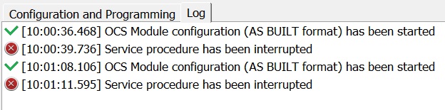

I was unable to access the OCS Module

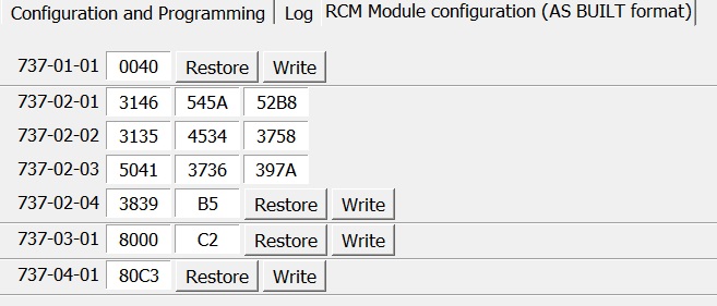

RCM Module:

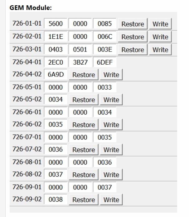

GEM Module:
IC Module:
I hope this helps. If you need more information about my truck just let me know. As I said, I would like to know how to disable the TPMS. If you can help me with that I would appreciate it.

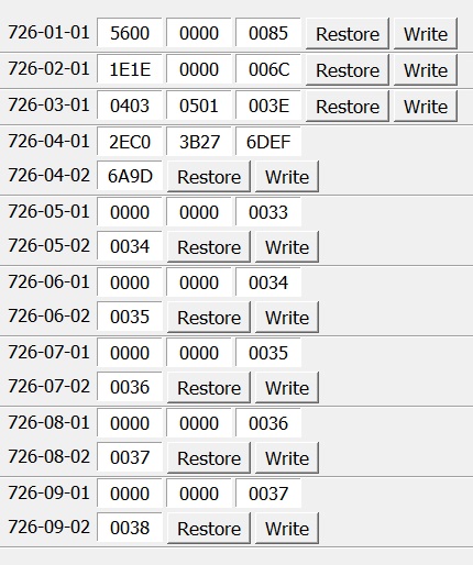

I put your data on the spread sheet.
Seems like you you have and extra digit turned on compared to my truck on 726-01-01. Digit 15 on the sheet. I'm betting it's related to the 4X4 since that's the only difference I can see between our trucks.
Do you have electric shift 4x4?
Also, I think if you change 726-01-01 from 5600 to 5200 that should disable the bit for TPMS. I haven't had a chance to confirm this myself, so if it works let me know.
Id also be curious to see what happened if you changed from 5600 to 1600. My best guess is your electric 4x4 shift wouldn't work if you have one. That would be good to know because it would potentially allow someone to do a 2wd to 4x4 swap and utilize the stock computers.

What setting did you change, from what to what?
You have some pictures of the setting?
I changed the 5600 to 5200 at 726-01-01 as you stated above. Oh, and yes, I have electric 4WD.
Did you go through the whole process to write to the GEM?
I’ve tested it on multiple vehicles now so I’m confident it should work.
Not sure about the "whole process". I changed the value and then click Write. When it's done it says to turn the ignition off then on again. That's it. Can you elaborate on the process if there is more to it please? Thanks.
