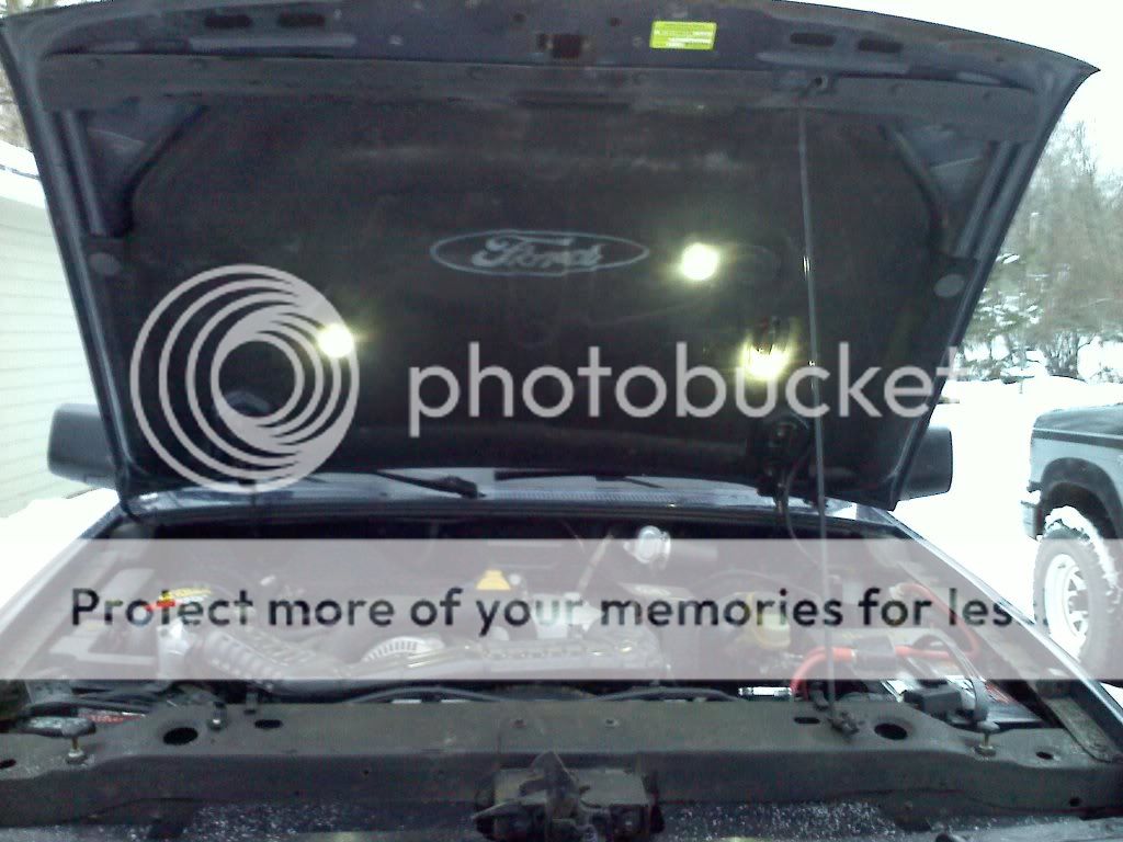

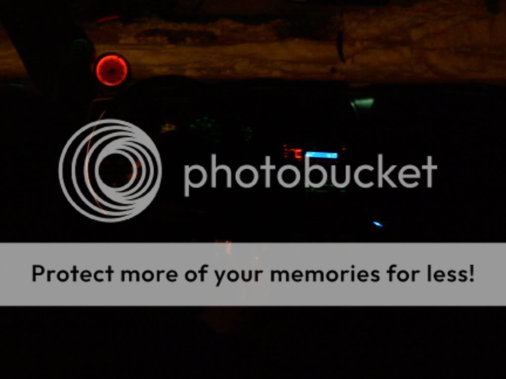

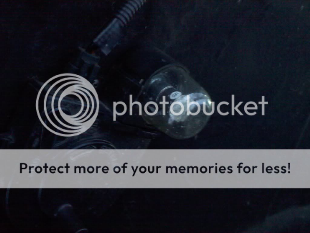

i got a package from www.superbrightleds.com on saturday around noon, and i had a christmas party to go to at 3, so i hurried up and took my shower and got dressed for the party and then went out to the truck to install them while i was waiting for terra to get ready. i replaced all of the bulbs in the instrument cluster with the appropriate color LEDs and i also did all of my autometer gauges, the ashtray light, glove box light, dome lights, under hood lights, the hobbs reel lights and the cargo lights. i was only able to get a few pictures after wards, but ill try to take some more tonight and post them up tomorrow.

heres some more pics like i promised, the dash board and autometers were hard for the camera to pick up though.
