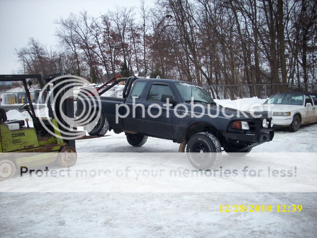

yes i know the brake hose is completely maxed out, but its not stretched tightly, i wanted the axle to drop as far as it would go so i could get the leaf spring bolts out easily, but i had to keep an eye on the hose to make sure i didnt go too far. both leaf spring bolts came out easily, but i had to cut one of the shackle to bracket bolts off because it rusted into the bushing sleeve. it took 8 sawzall blades but i got it, those 12.9 bolts are hard!

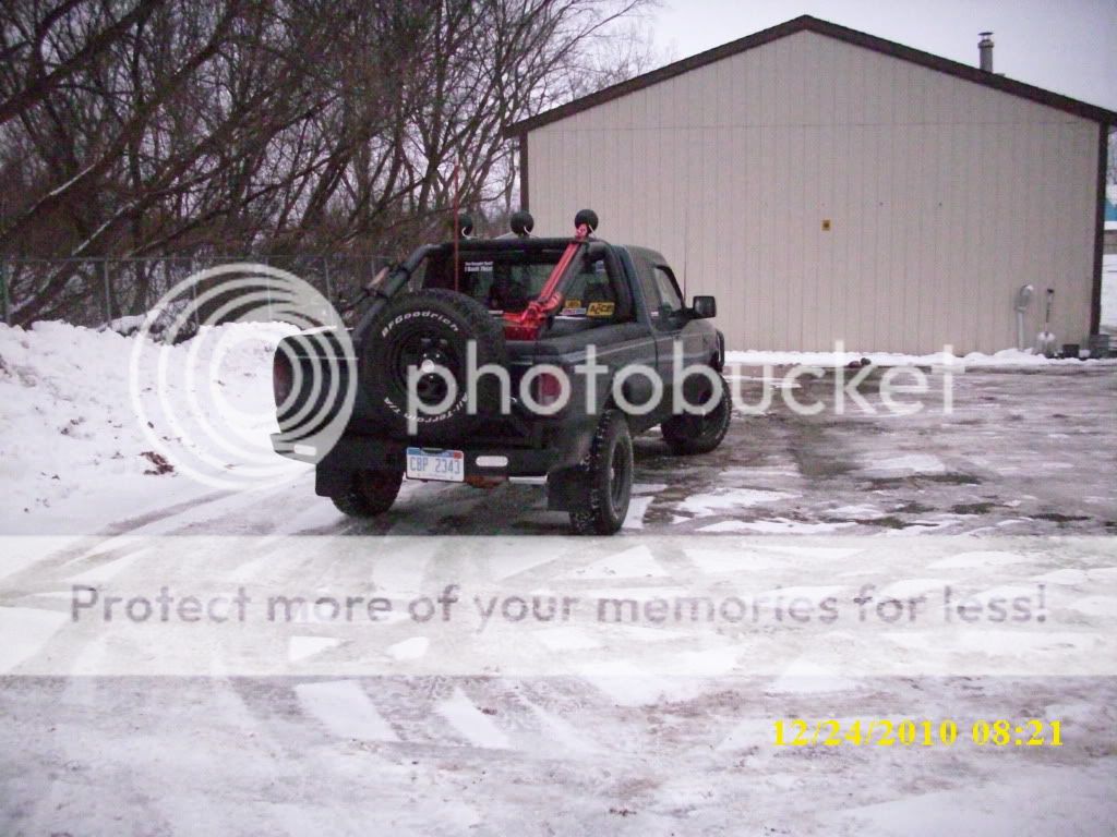

heres a picture of how i extended the tail pipe so it wouldnt get hit by the spring and shackle. i forgot to grab a piece of exhaust pipe from work before i started working, but luckily i had a 2" OD piece scrap that was long enough and was already flared on one end and i found a 2" ID / ID coupler to join the extension to the original pipe.

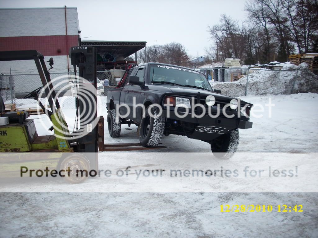

took some flex shots at work today with the hi-low, which was promted by my curiosity of the brake hose lengths on both the front and rear of the truck. with the belltechs the rear flexes very nicely.... almost enough to make me consider a locker, but the front leaves a lot to be desired. i knew the moog coils wouldnt flex as much as the skyjackers but i wanted it that way because im not running sway bars and this is my DD.

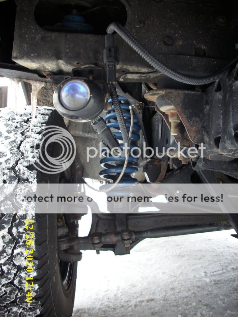

this is the passenger side front hose when it is flexed as far as it will go.

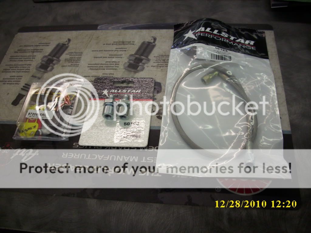

heres the parts ive gathered so far for my rear hose, im still waiting on one adapter and im going to have to make a bracket to mount the hose to the diff.

got the final adapters for my rear hose, i should have this thing on sometime this weekend, even if i have to put my rain suit on and sit in the slush!
