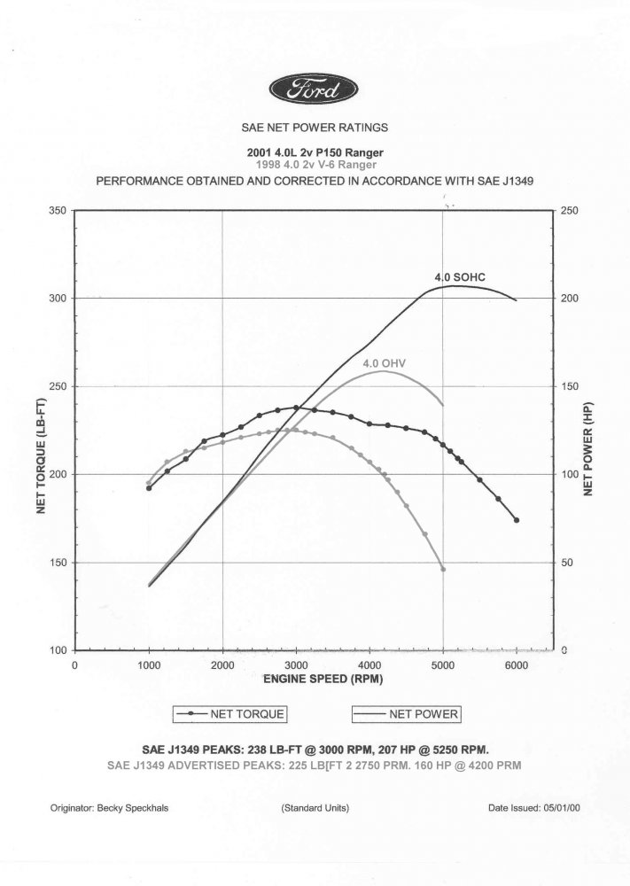

Here is a graph you might be familiar with that doesn't quite agree with your statement. The only place the 4.0 OHV makes more torque than the 4.0 SOHC is below 1600 rpm and it is only about 5 ft-lbs. I am guessing that could be equalized but it would probably sacrifice some of the top end power. Yes, OHC engines can spin to make more power but they don't need to unless the manufacturer designs them that way.
Did the pushrod 4.0 ever get a roller cam though? I kinda don't think they did. That does really help with valve control and was a gamechanger for pushrod engines that received them. Not saying it will totally close the gap but it would help.

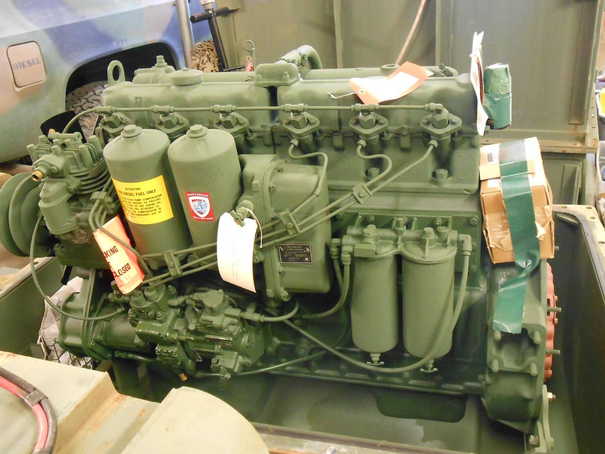

Obviously the answer is a multi fuel engine...
Yea they dont "technically" run on pure gasoline but they run on gas if you mix in some oil, jet fuel, kerosean, motor oil, cooking oil, diesel, mine even ran fine on a bunch of old transmission fluid. :ROFLMAO:
The only thing they don't like is ethanol and race/aviation gas with methanol in it. Unlike me they simply hate alcohol of any kind but that's more to do with the rubber seals and lines than the actual operation of the engine. I bet with some modernization they would run fine on whiskey...
My B John Deere is an all fuel. Warm it up on gas and you can switch it over to to just about anything flamable once it it is warmed up.
I just run gas 24/7 because it is cheaper/easier to find than anything else and I have no idea what is growing in the small gas starter fuel tank.
Seems like a completely valid engine option.
I would heavily consider it.
