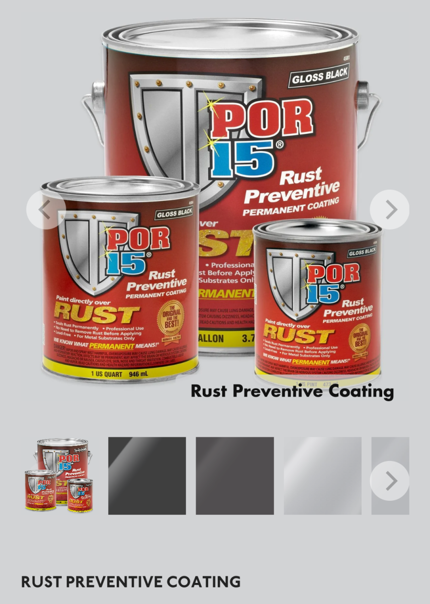

I looked up Por-15, which product did you use. Would I need that if my rust was not so bad. I ground the worst spots just because I hate to sand. I spray with rustoleum those spots and am looking into using something to spray the whole floor.
@moretsky99
Hello,
I used their RUST Preventative formula in gloss black. It has a great reputation for sealing bare metal, regardless of rust. It becomes a strong permanent barrier between the the clean meatal surface and the environment.
It is not the cheapest product on the market but if I need to repair or prevent rust/corrosion, I will spring for this stuff everytime.
NOTE¹
It should used with a suitable respirator system as it produces way more vapor than regular paint. I used a disposable cartridge mask , organic vapor cartridges with pre filters; with that set-up, I was breathing great and could detect any smell. If that had not worked I would have gone forced air.
NOTE²
f you haven't had much paint training...the hair on our heads has more surface area to absorb than all the other parts of our bodies combined (depends on how much head and body hair the individual has) a necessary practice is to cover the hair on your head, even if not spraying the product.
With a proper application of POR-15, I expect another 35+ years or reliable performance from my firewall and floor.
