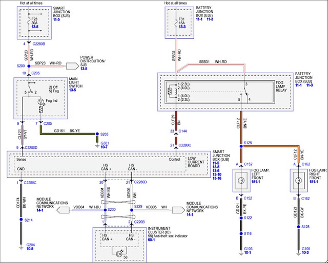

This is the wiring diagram I found in my service disk.
Fog lights come on after ignition turned off -- not kidding...fog.lights.wiring by bbass408
I haven't tried any of the testing yet. They didn't have my battery in stock yesterday so I'll try everything tomorrow.
According to that diagram and your statement that no indicator is lit when the problem occurs, that means the light switch is most likely good. You can verify that by unplugging the light switch and see if the problem is still present.
The smart Junction box must provide a ground path for the fog light relay to energize when you want the fog lights on. Make sure you have power on one side of the coil of the relay. Then, the other side of the coil should NOT have power and should NOT be grounded. If it is grounded, ( 0 ohms of resistance ) then the smart junction box contains the problem.
