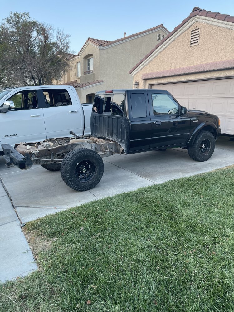

Trucks fixed fellas! Literally just got back from a test drive after changing the fuel pump. Ran like a champ. Pressure test showed it was only running at 20 psi and it was intermittent at that.
Can’t thank you guys enough for all the advice. Much appreciated👊🤙
