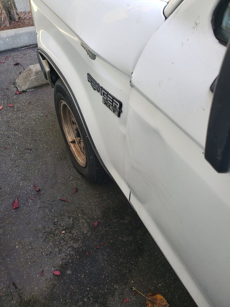

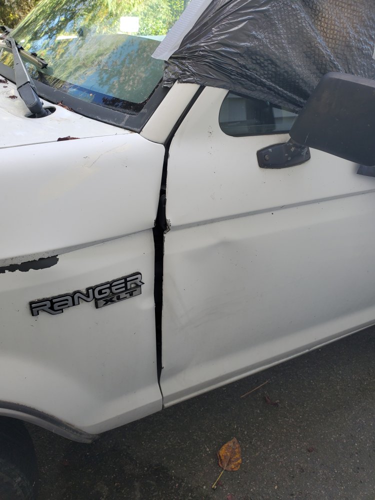

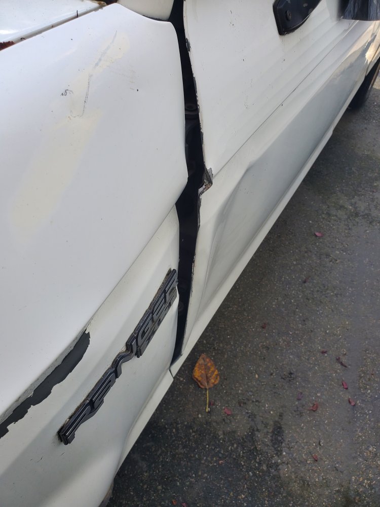

I have a 1992 xlt, and the driver side door is all messed up and bent the front body panel and the door panel itself, its also hanging wrong and cant close, open, or lock properly. Its got power windows (idk if thats relavant). I was wondering if theres any advice on how to fix the problem? Theyre like foot long, inch deep dents on both panels and a bit of a crumple on the door that hits the front body pannel. Any advice on how to rehang the door and pop out the dents would be EXCEPTIONAL, also if theres any interchangable doors from other ford vehicles, thatd be swell knowlege to have too.
Thank you to anyone who reads and responds, i just wanna have a working door...

Some pics of the dents/wrinkling

loosen the fender bolts and slide it forward so once everything is straightened out, it won't hit again as soon as you open the door
it also looks like the door was opened to far and that bent stuff too. you might have some alignment issues and air leaks around the top of the door once you get everything fixed
