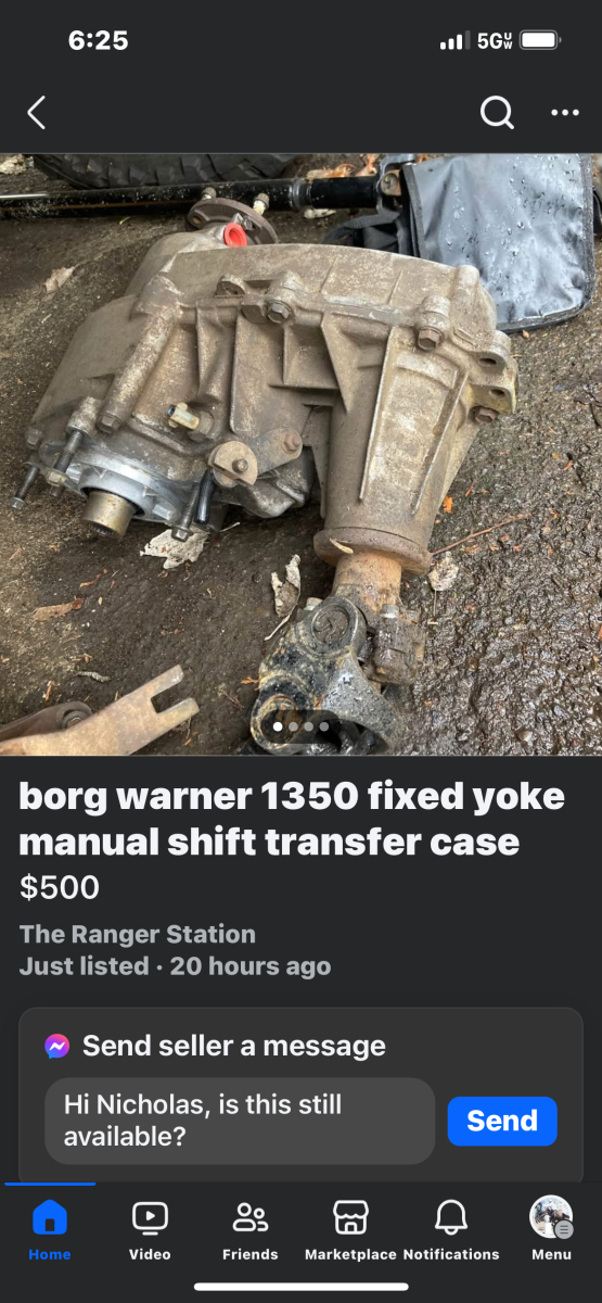

Guy claims it’s from a STX. I don’t think I’ve ever heard or read about one. Thought I’d share. Guy wants $500 for it because it’s rare. Well if it’s real it is. But I don’t for see collectors running part numbers on transfer cases. But what do I know haha

Looks like one.
I miss my slip yoke front output, greatly simplifies the front driveline for weird powertrain setups. If I could convert my NP205 to a front slip yoke I would have a long time ago... had to do a couple attempts at redoing my exhaust instead.
Rare but not really more desirable. I would much rather have a 1354… if I break a 1354 I know I can find another one or fix it, that’s almost a one off transfer case at this point.
I’ll let my electric shift STX t-case go for $500 if there are any buyers though 😂
I wonder if the fixed yoke 1350 still has an internal u-joint? Pretty sure I have a diagram here somewhere.
The 1354 has a shorter front output which allows for a longer driveshaft with less angle. That's valuable when lifting.
Yes it does have an internal u-joint.
I have 3 of these STX manual cases in different states of disassembly. They are pretty much identical to a standard 13-50 other than the front output shaft, seal, and flange.
