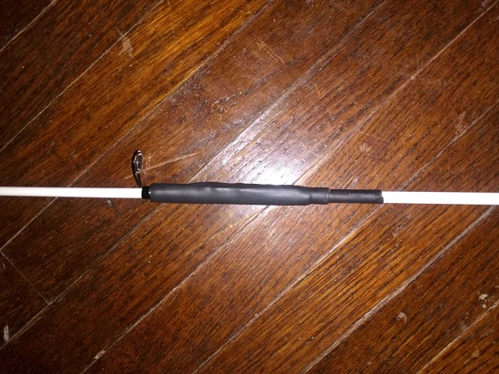

So somehow with the mess of Christmas presents that were piling up in my closet for the past few months before Christmas my new fishing pole got broken. It was my fault for not putting it in the garage but somehow the pole got in between my crossbow and must have got moved and broken. Anyway, after looking online on how to fix this I found nothing. So I had to tap into my "redneck ingenuity" and give it a shot. I ended up using heat shrink tubing in a few layers and then cut the metal handle off one of those cheap harbor freight brushes (the ones that are $2 for 100 pack) and I wrapped it as tight as possible and then put some more heat shrink around it. Haven't gone fishing with it yet but I took the tip and I bent it as if I caught a biggun' and it stayed true and showed no signs of breaking. I would like to re-do this and clean it up some more but here is what it looks like. Beats having a broken pole.

You can buy ferrules by diameter. Measure the diameter at the break and glue the proper sized ferrule on the lower half, epoxy seal the upper half so the graphite doesn't splinter and you can then just use it as a 2 peice rod.
That's too high dollar for my liking.... I'm a cheap ass as you all should know by now. I like my fix. It works, its pretty strong, I don't fish for anything other than bass and catfish which I have bigger poles for catfish so it would mainly be for bass fishing. Around here where I fish they only get 3-5 pounds max. Catfish get bigger but like I said I have a bigger pole for that. This fishing pole was on clearance at Walmart for $15 so I don't want a $15 pole with a $45 repair lol. That's like wiping before poopin.

Good tips. I'm anxious to see how well the cheap repair will hold. I used 3 layers of heat shrink tubing. First 2 layers of heat shrink to keep it nice and tight then wrapped that cheap metal handle around the broken part and then a final layer of heat shrink. I know I could make it look a lot better than it does but I wasn't sure if it would hold at all let alone be straight lol.
